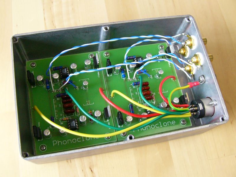

Phonoclone no. 4
This is the fourth phonoclone I've put together, the last three of which have been using the PCB. Of the three that I've sat down and listened to, this is the most neutral. Its a little on the soft side, but at least it doesnt have the slightly intrusive treble of the original prototype. I put this down mainly to the filter caps, which were all low impedance types (ELNA and Panasonic) on the protoype, and regular Nippon Chemicon KMGs or equivalent on the later versions. The mica RIAA caps, for as far as I can tell, are sonically transparent ... I cant hear them at any rate. The bulk of the resistors are Riken ohm, with a couple of Panasonic carbon films in the RIAA since I cant get Rikens in these values, and a good old Allen Bradley for R8.
I recycled the old VSPS case (Hammond 1590D) and just managed to squeeze the two PC boards in there. Stuffing the board and hooking it up took less than 2 hours.
/R

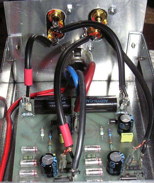

Many thanks for this great and very simple circuit!
I made one amp for me last week, for my DL103. This couple together really starts singing! It beats my formerly NAD PP2 without any discussion.
My amp is based on two OPA2227. No resistors between +input and ground. External, filtered, regulated and switchable PSU. Ferrite Beads direct before the bypass caps to filter any RC.
I prefer some voltage about 10V, concerning noise / sound.
Apropos noise: 10cm nearby my >95dB/W speakers, there is some very slight noise. No hum, when the psu is about 30cm away from the amp.
I am excited, now for more than 4 days listening to the amp.
Franz

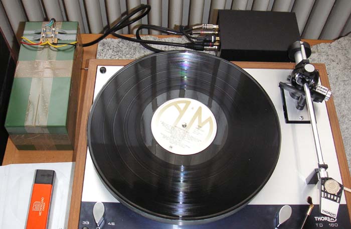

In the meantime I could buy very cheap two 15V military batteries and I just tested my amp with it.
The result: the (very little) noise is in fact induced and amplified as soon as I connect the TT to the input.
I do not remark any difference between the battery operated amp or LM317/337 based psu (at the same voltage).
Here a picture of the battery setup.
Franz

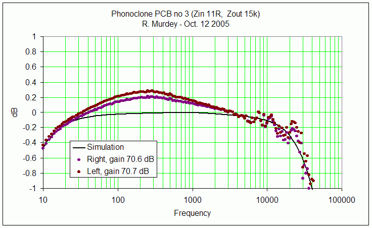

I figured I'd upload the frequency reponse (deviation from RIAA) to the forum, for posterity.
cuz its pretty good. :)
Its satisfying to know at last that the calculations actually do match reality. The .2dB bump in the midbass is the result of a couple of the RIAA components being about 1% off the target value.
/R

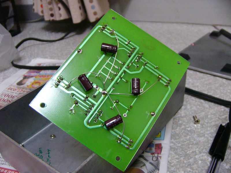

Phonoclone PCB grounding issue
Its come to my attention that the phonoclone PCB has a minor problem with the ground layout. Before everyone gets excited, please remember:
1. This does not affect the VSPS at all.
2. This does not affect the Phonoclone either unless you use an uregulated power supply.
Ok, the problem is the length of ground trace between the regulator ground pin and COM that is shared by the ground of the filter capacitors C8-11. The ripple currents (about 100mA peak) going though each trace coupled with the rather high resistance of the PCB traces induces a voltage spike on the regulator gound pin that of course floats the regulator output up accordingly. In other words, extra ripple is added to the op-amp's power pins, and find its way to the output.
This is explained in more detail here.
The solution is to rewire the ground leads of the filter capacitors C8-C11 directly to COM, as shown in the photo. Or switch and use a regulated power supply.
Making the mod did improve the sound, in my case.
