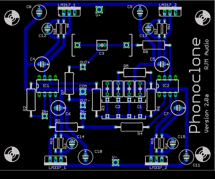

Conversion to VSPS Ulra
Richard it appears to me that the conversion of the VSPS boards to take a VSPS Ultra requires:-
1) the removal of R1 and R2
2) the cutting of IN+ to IC+ track near the IC.
3) Bridge between part of track comming from IN+ to track going
from C1 to IC-
and 4) Bridge from IC+ solder pad to COM track.
Is this correct or is there an easier way?

VSPS to VSPS Ultra PCB mod
Sorry about the not getting back to you by email - but it was a bit more involved a question than I had time for this week.
Ok, double check everything I write here: I havent done the mod myself.
In its simplest form, the mod is as follows: use R1=10ohms, or bridge the pads with wire, leave out R2, and connect the input wire to the top pad where R2 would normally go.

one point I forgot re the VSPS ultra, the input ground can be attached either to the bottom pad of R2 (safest bet) of the original IN- pad. Shouldn't matter which.

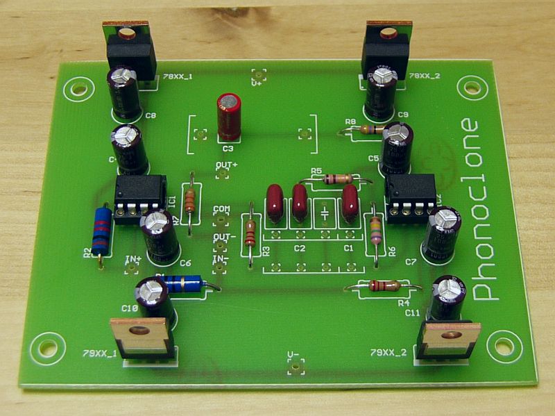

For the guys who recently got a Phonoclone PCB and a bag of parts in the mail, this is approximately what it should look like when the board is finished.
C1: the 102G cap is 1nF
C2: the 222G is 2.2nF and the 681 is 0.68nF, in parallel they total 2.88 nF.
you can also use 4x 1nF caps for 1nF and 3 nF respectively.
I've sort of settled on Matsushita carbon film resistors for the R5, R6, Riken Ohm for R1 and R2, and Takano carbon composition for R3, R4 and R7, R8. I will probably make a full parts kit available for the next batch order, including the resistors for the first time.
I'm also considering offering 25A bridge rectifiers and silver mica RIAA caps. Though neither of these are cheap, they are the parts I'd use myself, so it only seems fair to add these to the order list.
-Richard

Phonoclone Up and Running
Hi There,
As one of the recipients RJM refers to in the post above I thought I'd just mention that my PhonoClone boards and parts arrived last Sunday and that my PhonoClone is now singing sweetly!
It's spread out on the bench as present - I haven't even begun to build a case but the initial results are very encouraging, I think I have a little too much gain with R2 at 1K5 (I'm using an Ortofon Kontrapunkt b 470uV 5OHM internal DC resistance and recommended load 50-200 Ohms) -- any suggestions for an R2 value to give me a little less gain and suite this cartridge ?
