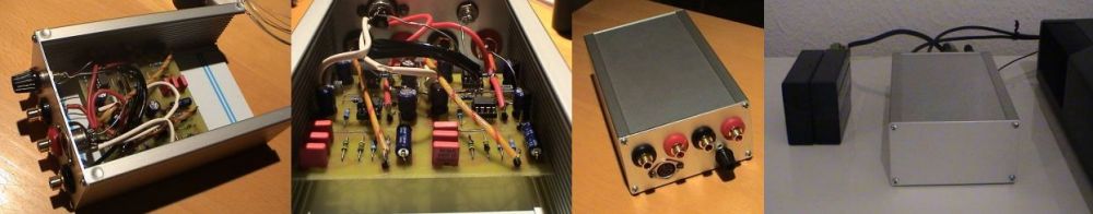

Now I finished my phonoclone successfully. I had some problems with hum and rewired the ground a few times. Now its fairly free from hum - only a very silent hum while turning the volume to the right end. Noise is not an issue even if its present at high volume levels. I used generic components for all parts, regular elko caps, WIMA MKP-10 RIAA-Caps, metal film resistors 0,1%, no sophisticated power supply regulation. In fact I used a 2x12V lead acid battery and a desktop power supply 2x12V/25W - I couldnt find a difference yet - but the circuit is not warmed up completely. Noise has some hash, even from the lead acids battery. So its not implied by the power supply. I used another PCB (half euro size) for both channels. First impression of the first 10 records: it sounds fine using my shelter 901 compared to my cyrus phono stage and my lehmann black cube SE (and far beyond my kitchens denon PM720 phono input).
Next steps: Build the whole thing a second time, using sophisticated material like WIMA FKP-2, Black Gate, Mundorf Audio Caps and compare the sound.

Improvements/Experiences Phonoclone
Now I finished my second version of the phonoclone, using some voodoo material like black gates etc. I made some observations while listening to both phonoclones.
1. The difference between the black gate board and the generic one is not that much. Something like very very little personal taste. There are more crucial improvements.
2. Improvement 1: Do not use this capacitor (220pF) between pin 2 and 3 of the OP1. Even if this will solve the problem of radio transmissions in your phono line it will introduce a BIG DC Offset in the whole cuircuit AND it sounds worse than without the cap. The DC offset results in a 14V DC at the output of OP2 (in a +-15V-Supply). Yes -the DC is filtered by output coupling cap, but it seems to affect the sound. Normally without the 220pf cap you have a DC at OP2 of 0..50mV !
3. Improvement 2: If there are problems with radio transmissions (I had this), use an OP27 in the first stage. It went away and had the effect of a 3rd improvement:
4. Improvement 3: The OP27 sounds much better in the 1st stage than the OP37. Dont know why but it's a fact. I use OP27 only now (I do not need the 90dB gain version). (There is another preference to use OP27G than the OP27E-Series or the Burr-Brown OPA227, which I tried, but thats personal taste)
5. Improvement 4: Instead the 78**/79** regulation use a LM3*7 regulation. The 78**/79** regulation causes some hash in the noise of the preamp. This hash went away in a LM3*7 regulation. (Maybe the 78**/79** regulation depends on the exact match of the regulator chips - I couldnt find any chips in a set of 20 which could by matched to 0,2V. Something like +14,6V -14,8V was used. Tolerance was from 14,25V to 15,8V for 7815 or 7915) Now I use variable regulation with LM3*7 an +10,01V -10,02V see Improvement 5)
6. Improvement 5: I use both phonoclones with a supply of +-10V instead of +-15V or +-12V. It is less noisier (but have not measured it), Maybe it depends on the whole power supply configuration and the use of a +-17V transformator.
It is a fine preamp now, far beyond the sound of my lehmann black gate SE, SUPA phono stage, cyrus two integrated phonostage (and the denon integrated phono stage). OK, you can configure nothing ...
So far, bspx
Next steps: Because I do not need the gain of the phonoclone (Shelter 901 has 0,4mV), I will try the VSPS ultra and compare the sound to the phonoclone. Any experiences in both out there already ?

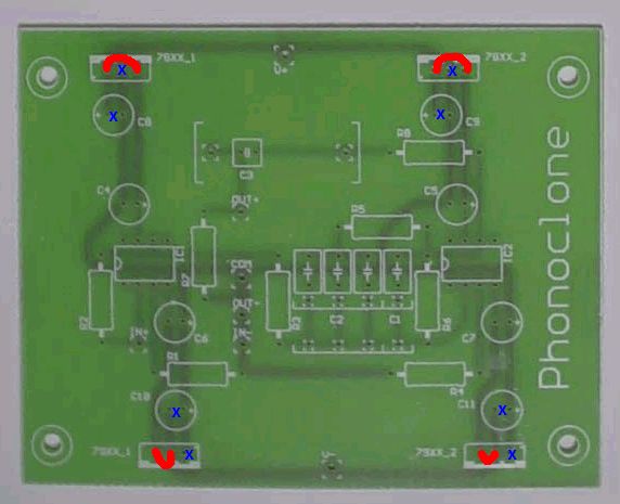

rjm
Joined 2004
See the attached image for an explanation of how to use the phonclone PCB with external regulators. Basically, leave out the 78xx/79xx and C8,9,10,11. Bridge over the input and output connections of the regulator holes with wire. This is also the configuration for using the phonoclone with batteries.
Anyway, back to regulators. Having done some reading around this forum, and looking at the costs involved, it sems to me that either you go the full-monty and build the Jung super regulator (or rather eight of them), or you settle for cheap-but-better-than-fixed-regulator types LM3x7.
I dont see any attractive alternatives in the middle ground.
I was thinking originally of building a compound regulator circuit with a quad op-amp, four pass transistors, two voltage references for two positive and two negative outputs to power 1 phonoclone or 2 VSPS channels, but it seemed like a lot of work re-inventing the wheel for little tangible benefit.
