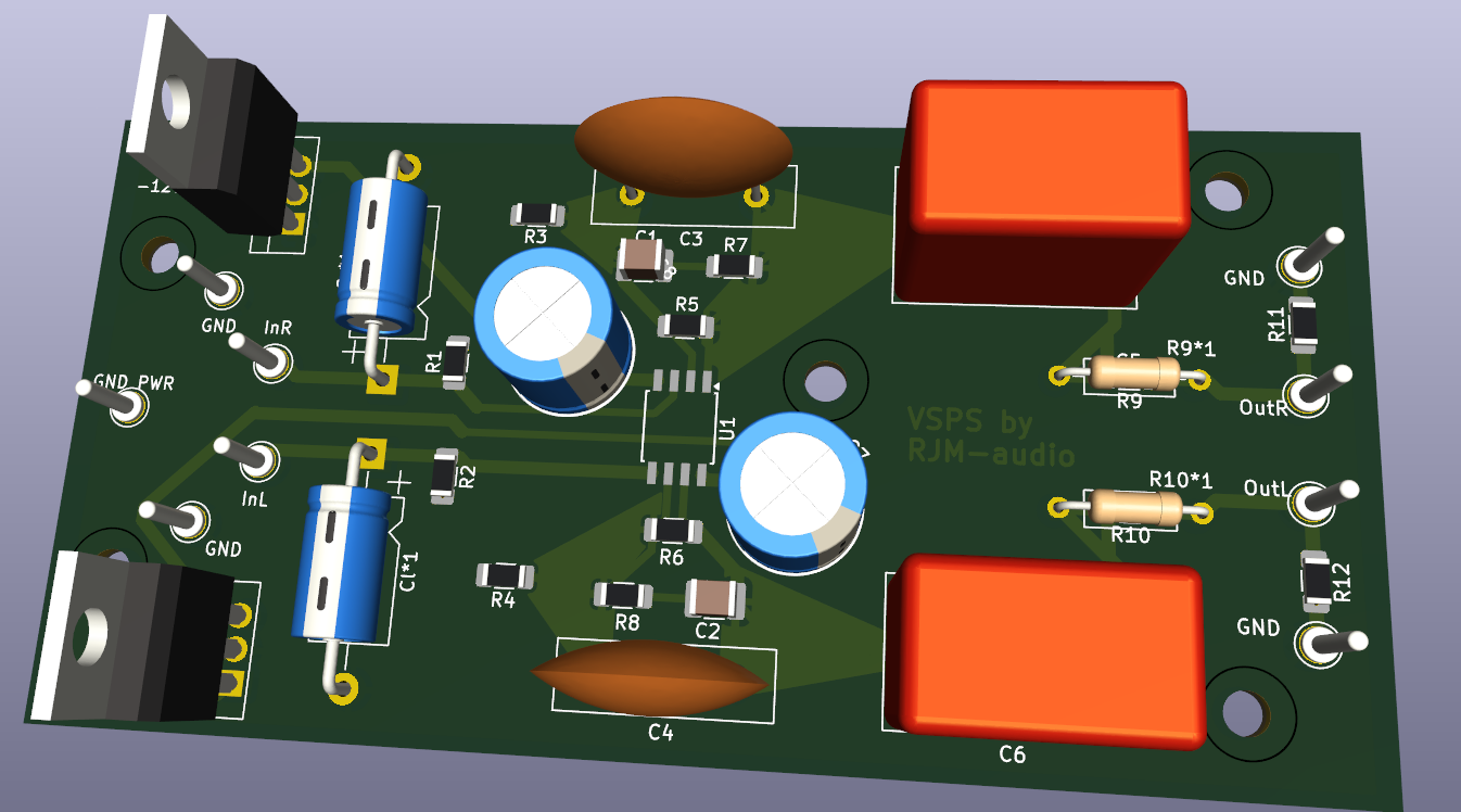

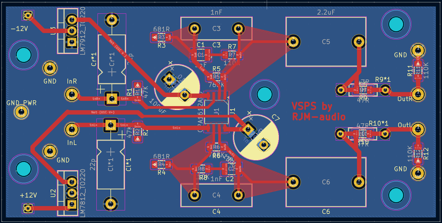

Greetings, esteemed contributors and of course, the much-admired author. I want to build a VSPS but make a board for it with the possibility of using modern SMD-components. Here I would like to present some of my thoughts and hear the criticism of more experienced colleagues, if I am somewhere wrong.
1. Some manufacturers specify for their cartridges not only the recommended load resistance, but also the capacitance. So I added such a capacitor in parallel to the input. But not all circuits have them, so I'm not sure if it is needed and would appreciate comments.
2. A 3000pF capacitor in series with a rather large resistor in feedback has less effect on the sound than a 1000pF capacitor. So I thought it was possible to use a COG ceramic capacitor there.
1000pF I plan to use mica or styroflex.
3. As an output capacitor I want to use a smaller polypropylene capacitor, which is not as high quality as the one Richard suggests. Would I get a better sound if I put a 1000pF styroflex capacitor in parallel? If anyone has experience, please share it. I have only shunted electrolytes, no experience with film capacitors.
4. I would be grateful if you could evaluate the board for errors.
I work in KiCad and would be happy to share the project if anyone is interested.

Hi RPS75,
Measure the cable capacitance to the turntable and of the input to the preamp. Subtract that from the recommended cartridge load and make the difference up with a capacitor.
Styroflex or a good NP0/C0G ceramic capacitor are both great. Use higher voltage ratings (above 50V) for capacitors, they are better. Polypropylene for higher values of film caps. You are wasting your time bypassing electrolytic coupling capacitors. In a power supply things are different.
