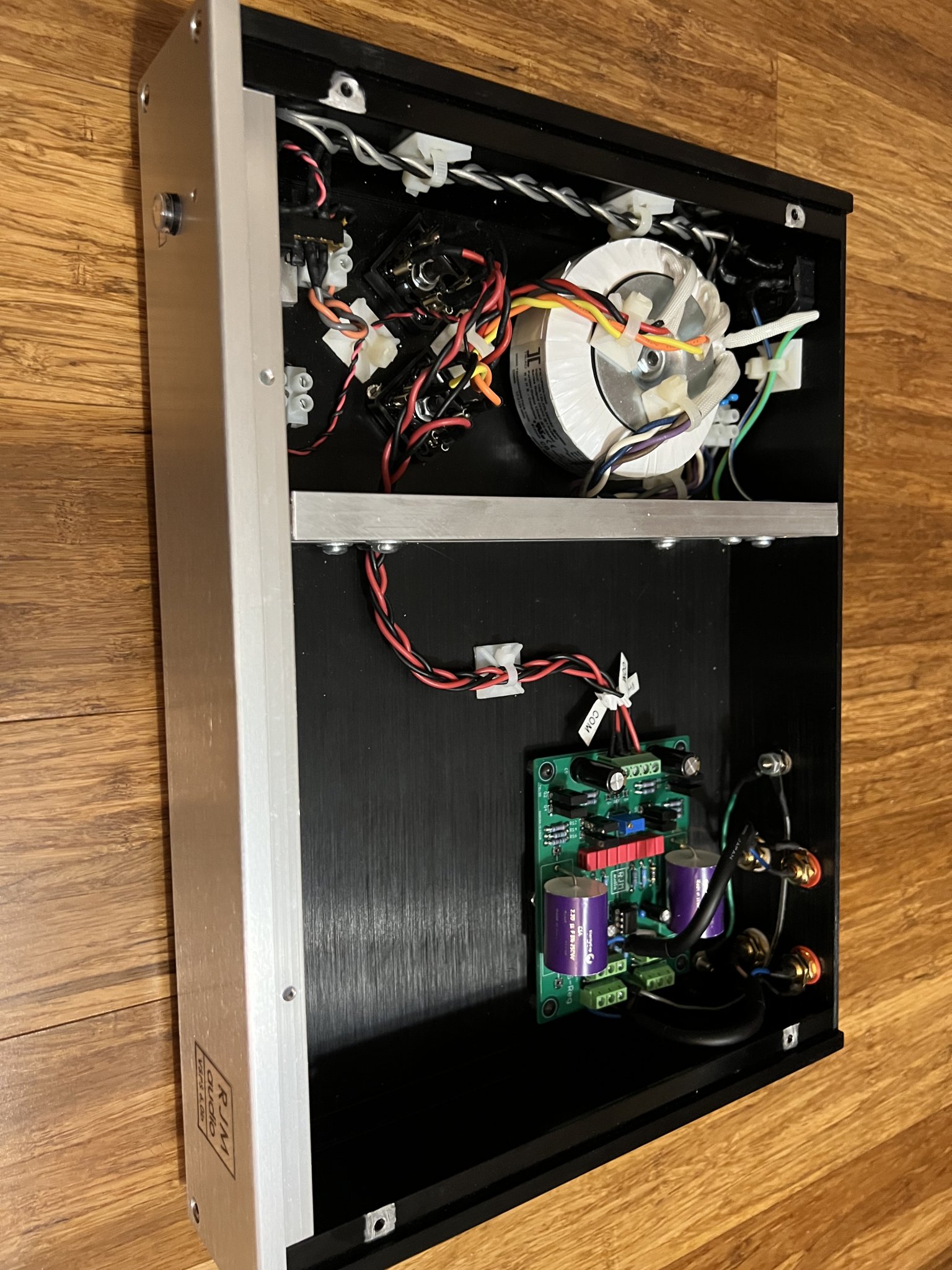

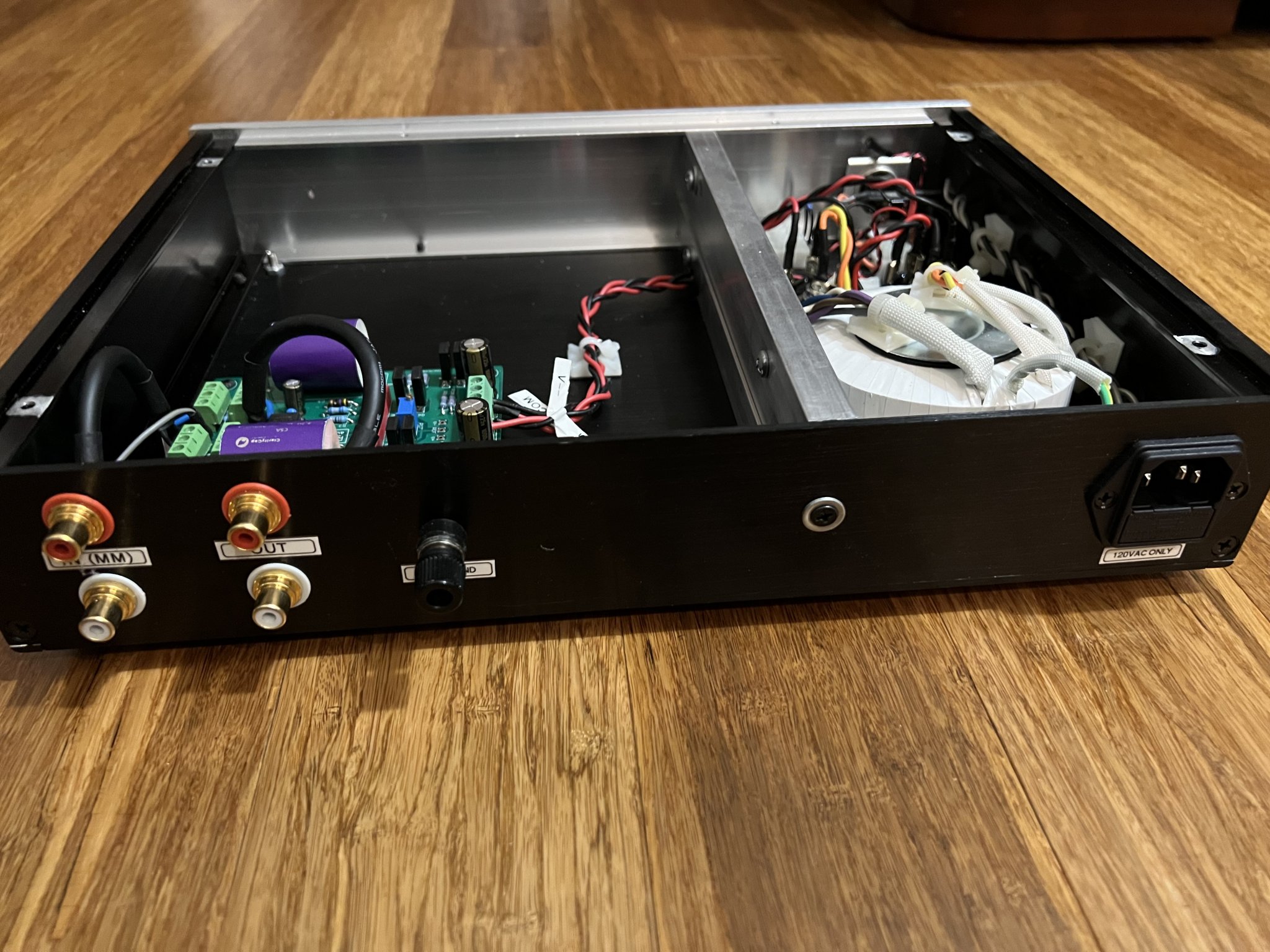

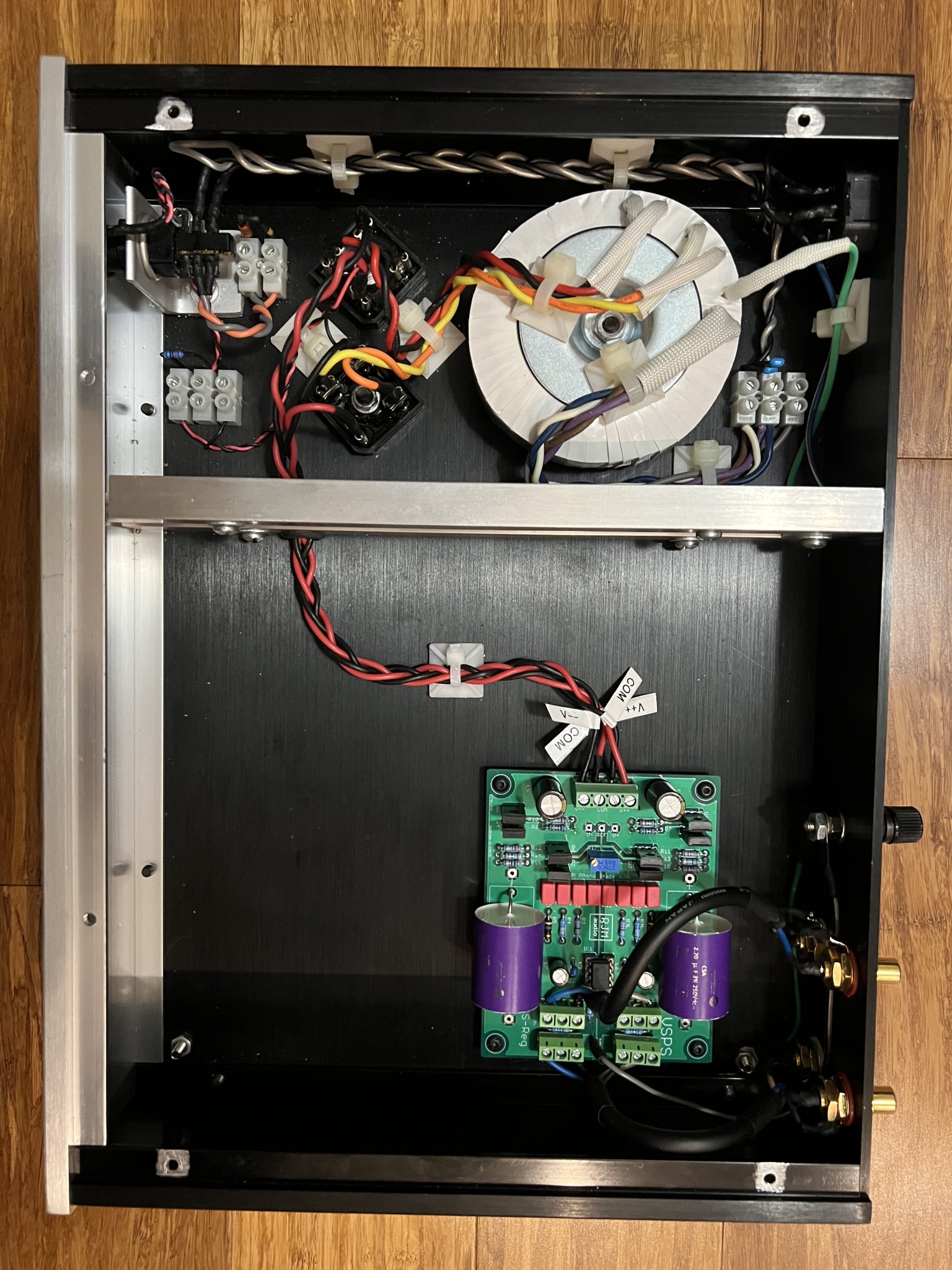

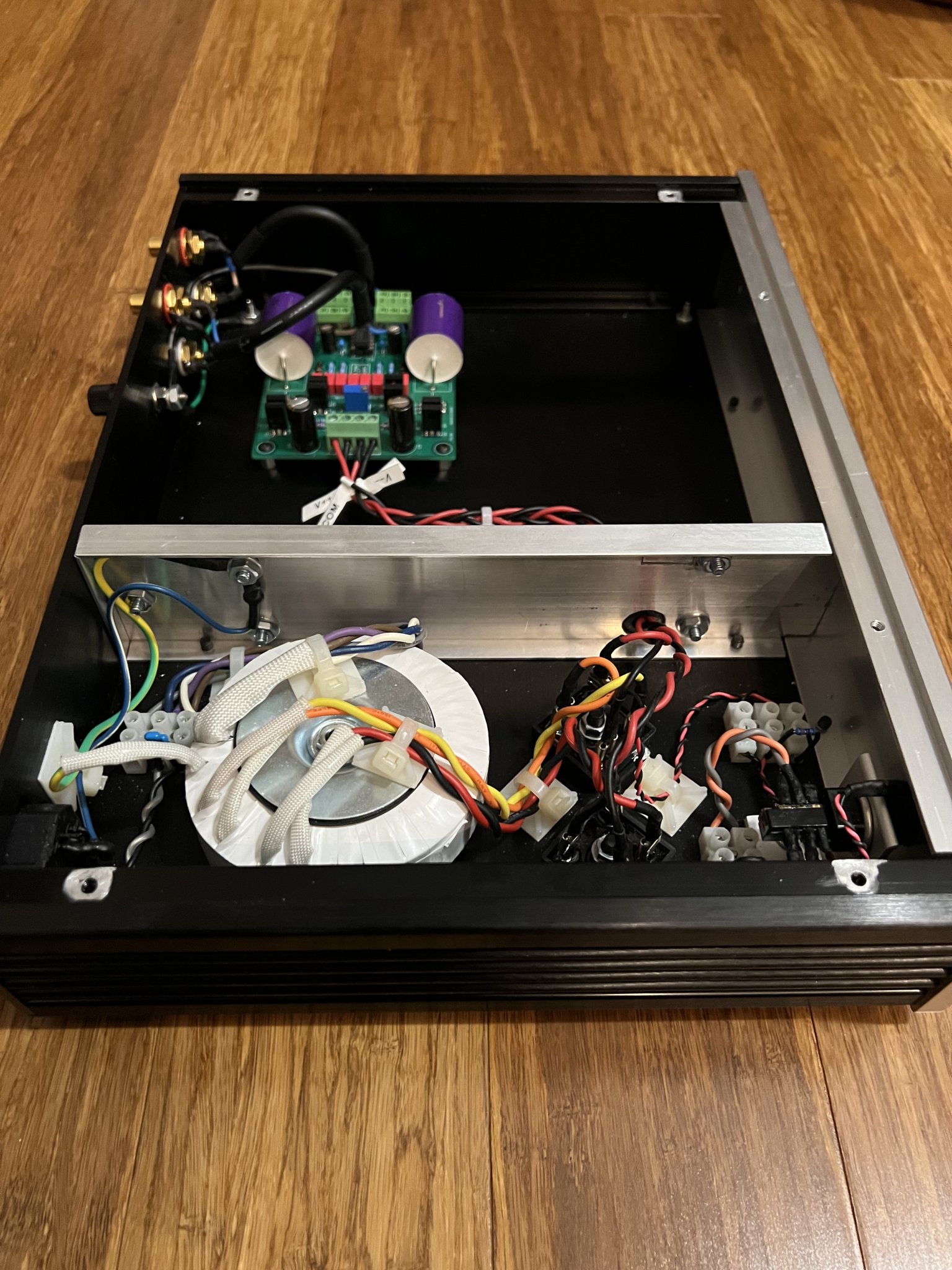

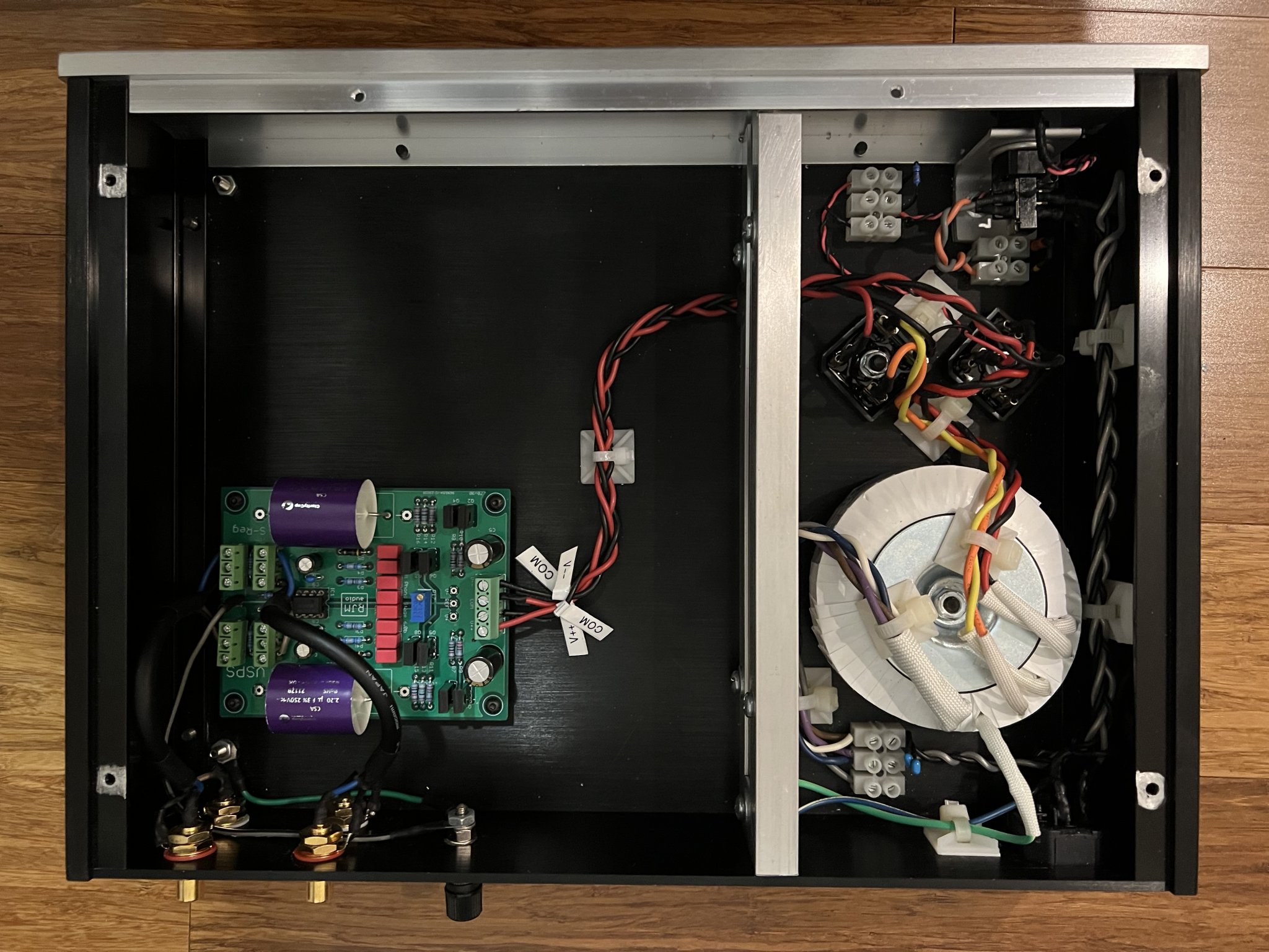

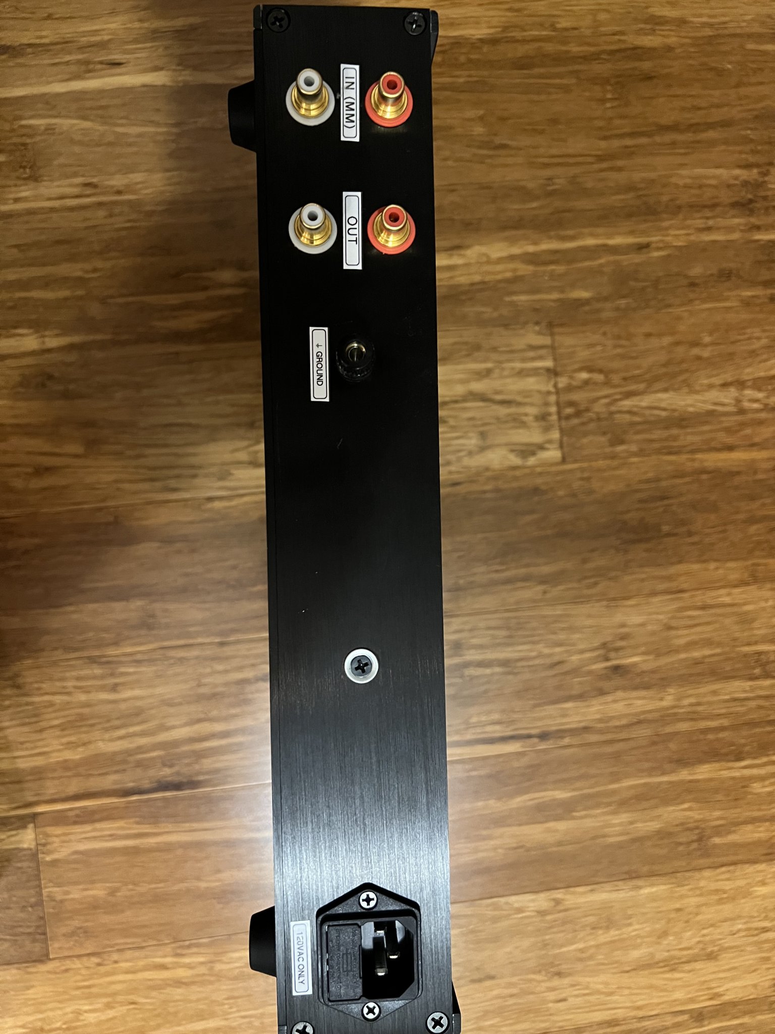

It has been several months since I built the VSPS 6.0b phono preamp, so I am posting few photos of my build. This is a prototype version of the VSPS, and Richard was kind enough to share the design files with me, so I ended up getting few boards printed. I mainly stuck to the default BOM, with few slight changes. For the RIAA circuit, I used +/-0.1% tolerance resistors and +/-1% tolerance capacitors. Since there are 3 capacitors per channel for the RIAA circuit, I matched those values between the channels. For C3 I used Clarity Cap CSA capacitors. I tried the OPA2134 op amp first, but it had little too much hiss for my taste, so I ended up using NE5532. I bought Muses8820D as well as LME4562 op amps, but never got a chance to try them. Although I purchased the released version pcb from Richard, I never build that version so I could not compare the two. At first I used twisted pairs of solid wire for the input and output connections, but then decided to use higher quality shielded cable. Single box build, as you could see in the photos. I have some 80-100 hrs of listening time on it, and the preamp works and sounds beautifully. Unless you stick your ear right next to the speaker and increase your volume control to 80% or more of the range (you hear little hiss at this level), it is silent.
Big thank you goes to Richard for his work, and outstanding support that he provides to many of us. I asked him hundreds of questions, and he answered every single one of them. You will not find better product support from anyone or any company out there. Thank you again.
Now onto the next project, the Emerald!
GDA
GDA
@gda23 Thanks for sharing your amazing build. It looks great!
To be clear, this version of the VSPS should be a significant upgrade from the regular version. I don't offer it myself because the Emerald should be better still - and once you get this far (so my thinking goes) - with the case and power supply and all - you may as well put a pair of Emerald boards in there in place of the single VSPS 6.
Yes, the OPA2134 will be noisier than the NE5532, but it should be very close for most MM cartridges. The NE5532 may sound a little grittier, the 2134 a little airier. I've always liked the sound of the NE5534/32.

@rjm Thank you Richard. That is exactly what my plan is; replace the single VSPS 6 board with a pair of Emerald boards, and keep everything else from the VSPS 6 build. I may add a rotary switch to allow to switch between 37 and 57 db gain, or I may just use the jumpers and not complicate things too much. I'll do this as soon as I receive the Emerald boards that I purchased from you earlier this week.
Thank you again.

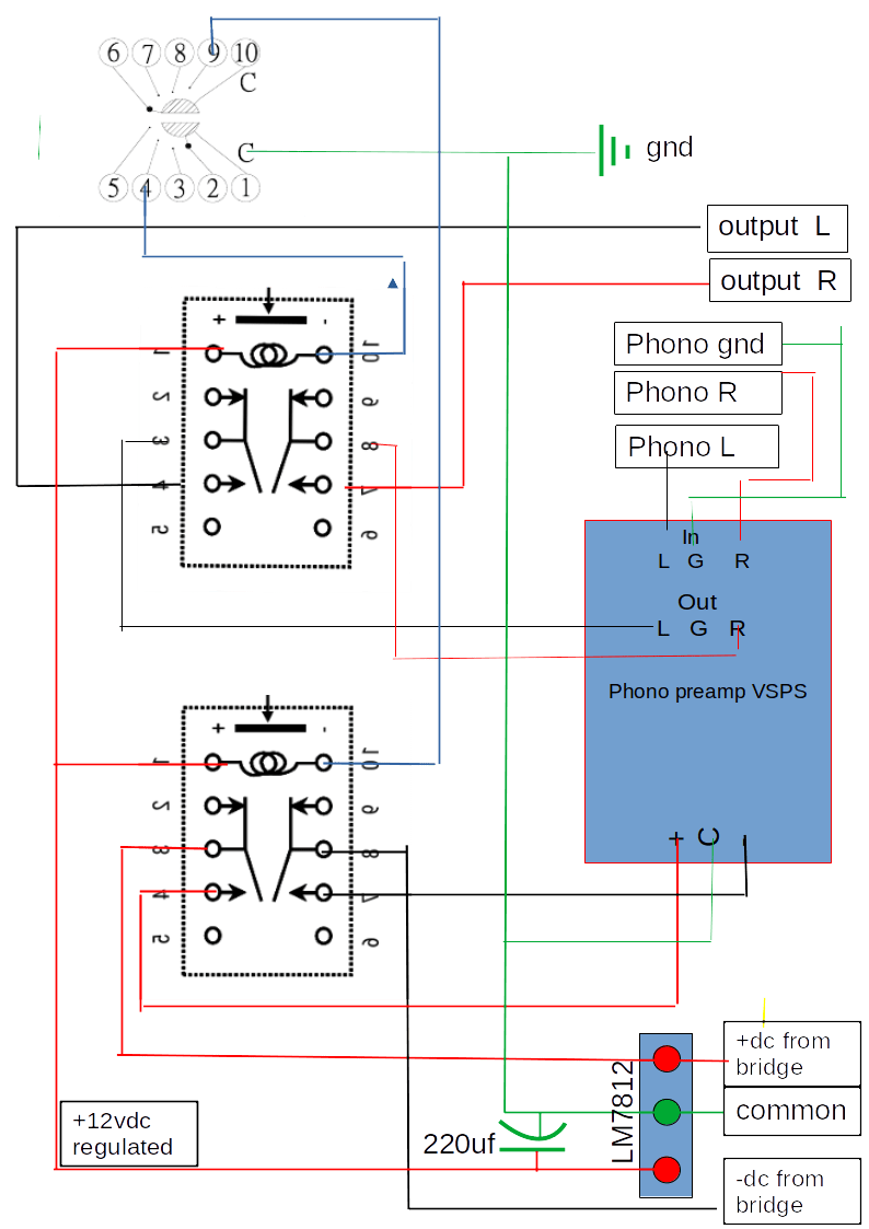

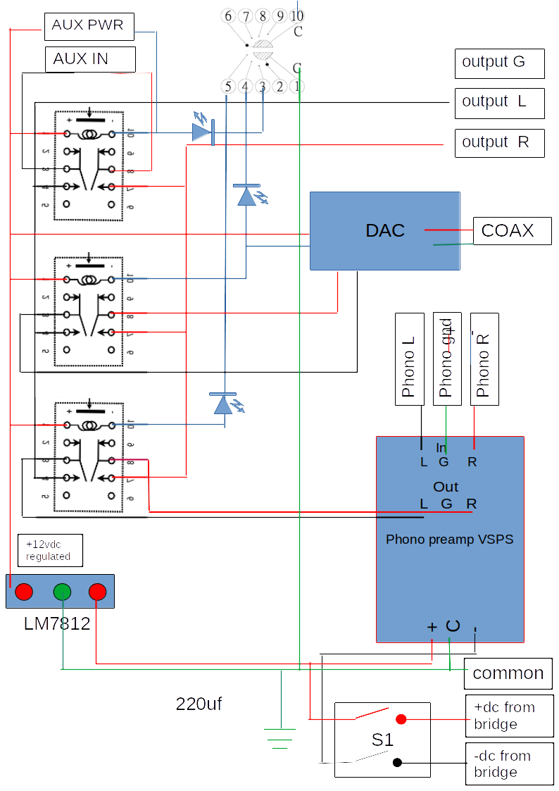

attached are two diagrams, the first is with the previous phono pre, it required only +12vdc from wall wart supply, which also supplied +12vdc to relay coils. I used one side of the relay to connect the output ground to the grounds of the two boards, phono and DAC. This allowed the power only to be applied to the boards if they were selected.
Second diagram is with the vsps board included. I would like to provide a +12vdc line, plus ground, to supply the relays and DAC board.

looking at the situation a little closer, I think that I can use the rectified +12vdc rail to feed an LM7812 regulator, with a 220uf cap across the feed to ground, and the output 12vdc can be used to drive the relays, I will also use a 220uf cap across the output to ground to help clean it up. See revised drawing.

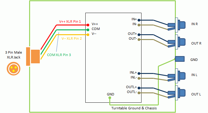

The VSPS is connected directly to the output of the bridge rectifiers.
The 12 VAC secondaries with produce about 18 VDC when connected to the VSPS V++, and -18 VDC connected to the VSPS V-- with respect to COM. This is normal. The voltages are internally regulated back to 12 V by the VSPS before powering the op-amp.
Note that you'll only measure about +/-12 VDC at the XLR before you connect the VSPS, because there is no filter capacitor attached yet.
If you want instead to power the VSPS from +/- 12VDC supplies you have to remove the on board regulators and bridge over the pads, as denoted by the "U" graphic on the silkscreen. This is explained in the design manual excel file.
You can, in principle, connect the ~18VDC V++ rails to another LM7812 regulator to generate a 12 VDC line to power your relays.
The main thing that's incorrect/inclear about your diagram is you are showing 12 VDC going into the VSPS, rather than the nominal 18 V unregulated DC you'd get from the diodes.
Thanks Richard.
Yes, I am only labeling the outputs from the rectifiers as +-12vdc, they are indeed higher as you describe.
This, I am having trouble understanding:
"If you want instead to power the VSPS from +/- 12VDC supplies you have to remove the on board regulators and bridge over the pads, as denoted by the "U" graphic on the silkscreen. This is explained in the design manual excel file."
I guess I do not have the +/-12VDC supplies, only the rectifier outputs.
Revised drawing attached.
I am confused over the grounding strategy. In my previous version, the power supply neural/ground was attached to the chassis. All of the low level input shield/ground were isolated from the chassis, connected together and connected to the output shield/ground, again isolated from the chassis. The separate phono ground was attached to the other phono board at a designated terminal. The previous phono board, and DAC board were controlled by running the ground circuit from the relay coil output through the selector switch. It is unclear if I can do this with the VSPS. Would it work to connect the 'common' through the selector switch as with the other board? My previous phono board, and the DAC have LEDs to indicate it they are indeed 'on' so I could test the circuit to see if it was working.
Anyway, progress is being made, I have some LM7812 regulators on order. I have a bunch of 50v 220uf caps I can use to filter the relay supply, and the DAC supply, is there a recommended higher value? They ran fine on a typical wall wart, I do not know how much conditioning those supplies usually provide.

I think I have found a way to do what I need with the addition of another relay. I know this isn't direct support of VSPS, but perhaps if you look at the attached, you could comment. Since my selector switch has two poles, (originally directly switching inputs) I can select the VSPS and have two relays driven on. One will connect the phono outputs, the other will connect the unregulated outputs of the bridge rectifiers. The remaining questions are, is the grounf hooked up correctly, and will the LM7812 plus a 220uf cap condition the regulated 12vdc supply to drive the relays without 'contaminating' the rest of the circuit? (the ground from the bridge rectifiers is unfiltered and needs to be connected to the system ground (I think).
Anyway, I have eliminated the other relay circuits for clarity.
Roger
Roger

Ok, I guess it would be easier to just use a switch. So I added a DPST switch to the incoming unregulated +-vdc from bridges. Connected switch output to both VSPS power inputs. Used the +vdc to power an LM7812 to provide regulated +12vdc to power the relays, and indicator LEDs. (see attached)
Now the question. On my previous phono board, and on my DAC, I use the selector switch to connect the relay power to ground, as well as the board grounds. This completes the power circuit for the boards. The VSPS schematic is unclear to me whether the 'common' in connection is required to power up the VSPS board, or can I run the 'common' input through the selector switch to ground? There is no path to chassis or system ground from the VSPS except from the turntable ground. The phono inputs and outputs have the ground connections to the shield on the cable, which is connected not to the chassis, but to the shield/ground on the source (coax, phono, aux). I guess I could try and see, I do not believe it would cause harm. My switch and LM7812 should be arriving this week, so I am looking forward to completing this project. Oh and not indicator LEDs for each selection!

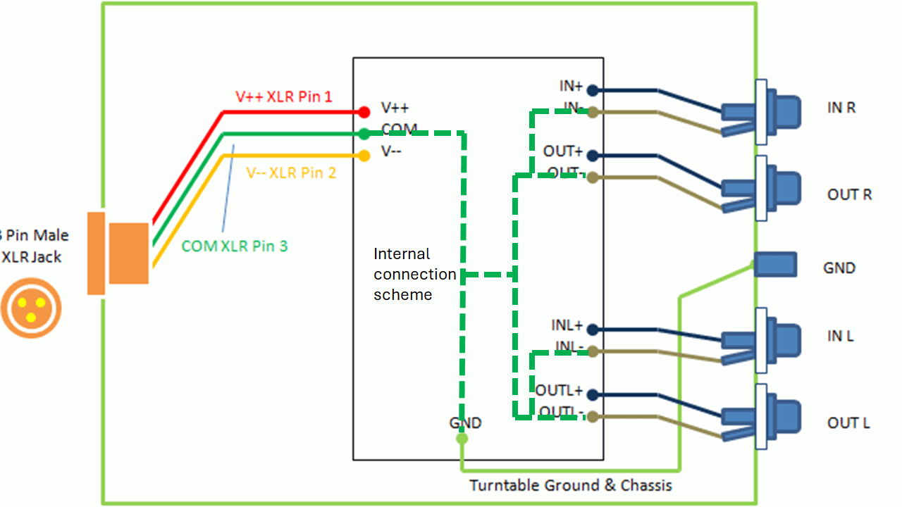

@rogerayotte
If you connect the power supply COM to the chassis, and the chassis to the VSPS GND, then you don't need to connect the power supply COM to the board COM because the connection was already made at the chassis.
Would that work? Most likely, yes. At this point, though, I tend to wash my hands of the whole thing. I feel it's up to the person making these decisions to troubleshoot things themselves if problems arise.
COM, GND, IN-, and OUT- are all connected within the VSPS board. The labeling designates what you are expected to connect the pads to: the power supply, chassis/ground lug, input RCA, and output RCA, respectively. This scheme assumes that those parts don't connect at any other point (i.e. that the RCA lugs are isolated from the chassis with plastic spacers, etc.)The VSPS schematic is unclear to me whether the 'common' in connection is required to power up the VSPS board, or can I run the 'common' input through the selector switch to ground?
