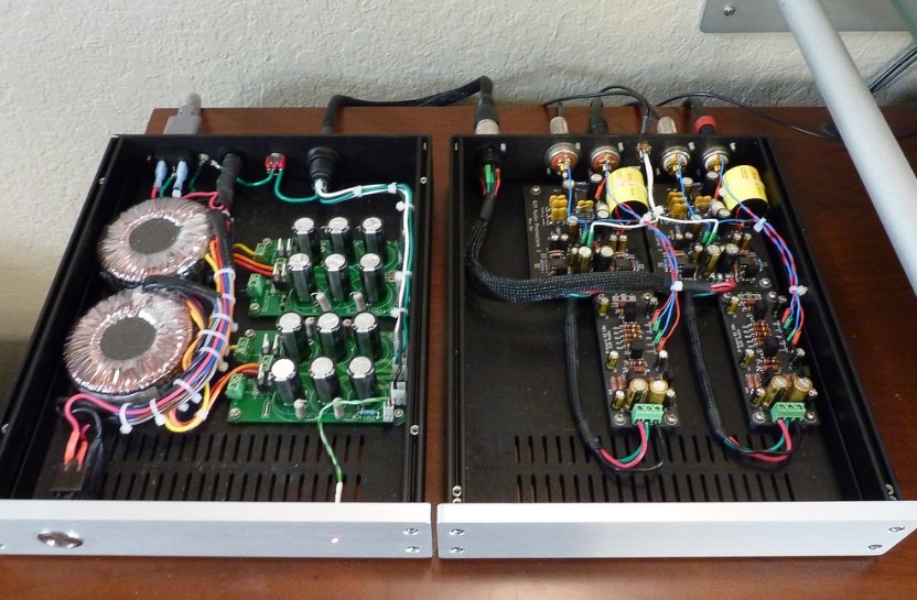

If you follow the link on the RJM site to the Project page, it is explained that the Emerald is basically a combination of the Phonoclone and an improved MM circuit, and for MC use it will be sonically very similar to the Phonoclone.
I built the Phonoclone and associated power supply years ago and it sounded superb, it was replaced by a Manley Chinook which was better but not by a huge margin. I would have no hesitation building the Emerald, Richard's designs are excellent!
@Superchunk
The Phonoclone is replaced by the Emerald project. The information for the project including the BOM is still online though it is no longer updated. You can download the board files to get your own boards made, but I recommend the Emerald as being more versatile while maintaining the same sound.
