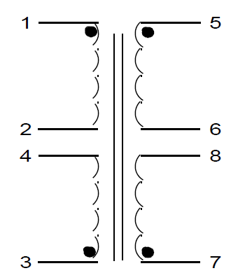

Well, I finished my power supply box today. Went a little awry and took much longer than it should have due to the fact that the way they do the pinning/datasheet/schematic for this transformer is a bit dumb and therefore I made a dumb error in the PCB design...
The schematic in the datasheet has the pins in order 1,2,3,4 and 5,6,7,8.... On the device, the pins are all in order, *except* pins 3 and 4 are in reverse order. ��*♀️��*♀️��*♀️
I mean, this makes sense, but why would you not just mark this on the schematic rather than actually reverse order the numbering of the pins on the device itself. GAH.
Anyhow, I was able to remedy the situation by cutting a chunk out of the traces that bridge the footprints in position 1/3 and 2/4 and then running jumpers to bridge the *actual* pins 1/3 and 2/4 (in positions 1/4 and 2/3) instead. Now it's running great 🙂
My offer to send out an extra board is no longer valid, though, as I don't want to send out a board in this state to anyone. I've corrected the design and added better markings if anyone is interested in making one themselves still, though. Should be around $10-25 depending on shipping for 5 of them from JLCPCB. See here for the full design and Releases page for zipped gerbers ready to submit to your choice of manufacturer GitHub - termhn/vsps-power: Power supply for VSPS (Very Simple Phono Stage) by RJM Audio

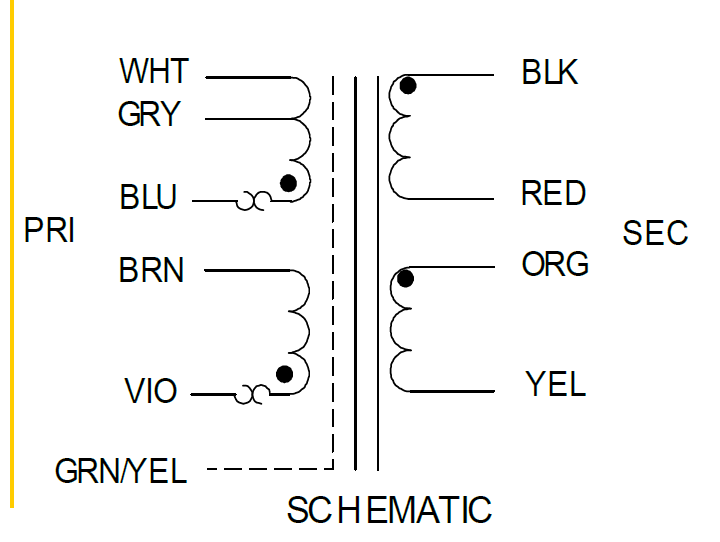

7-8-6-5-3-4-2-1
Because of course it is! 😀
Hahah, yes of course, why did I not expect that? 😉
I mean, it does ultimately make sense because now you can just short out the middle two pins for parallel operation but ugh, the least intuitive way you could mark that change IMO, LOL
It is really odd though that your Triad transformer doesn't follow the same convention as the Triad VPM I've used before.
Normally the windings are drawn with the phase indicator (black dot) pointing in the same direction, not opposite to each other. Must be reflecting some details of the construction not obvious to the user. Funnily enough if the diagram is changed to the conventional layout the terminal numbers end up in order.

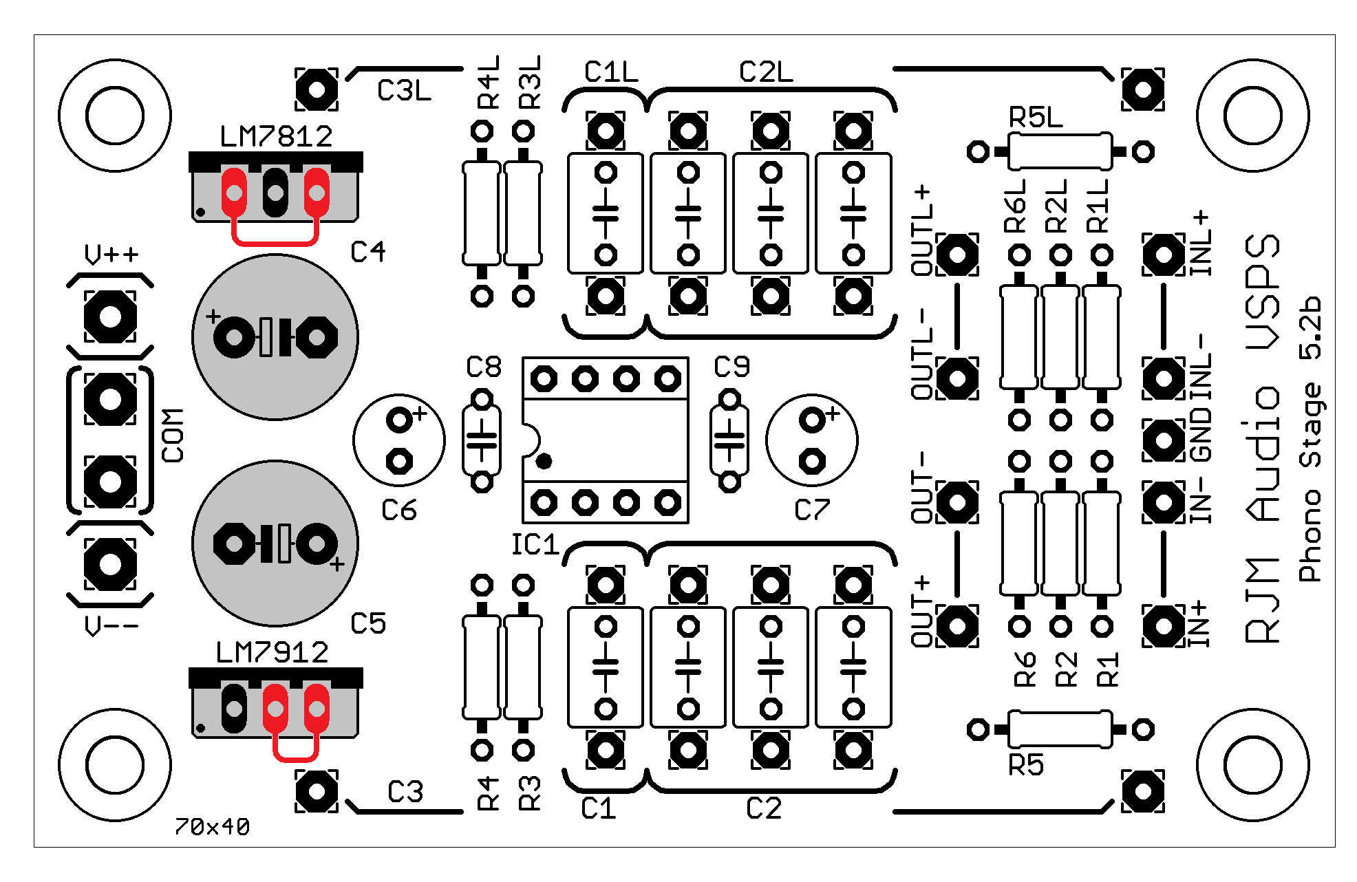

I have a few questions regarding the VSPS. Maybe someone here can help me.
Since I already have a power supply with regulators and filtering caps, I would like to use that and omit the regulator/filtering section on the VSPS board. I don't have the board yet, but from the pictures it looks like I would just have to leave out C4 and C5 and substitute the two voltage regulators with a simple bridge. Is this just about right? Or are there any drawbacks in doing this?
And do I really need a transformer with 24 VA? Such a small circuit shouldn't need too much power. I have one with 8 VA available, would this still be sufficient?
Thanks in advance.
Thanks in advance.
