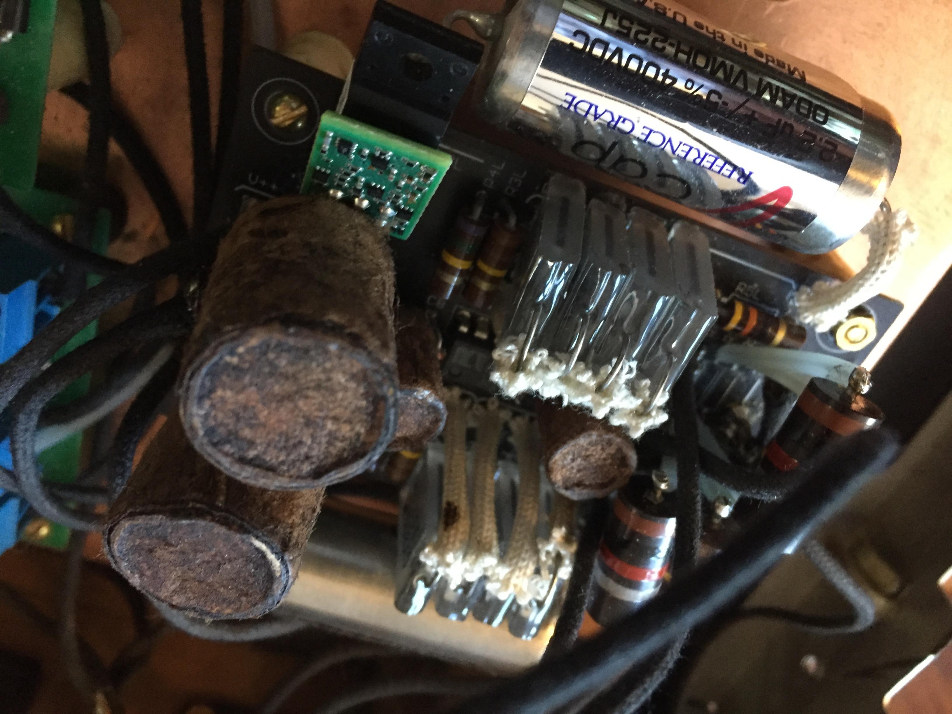

Ha! That’s poorly dissolved kakishibu - a persimmon extract that was used in Japan to waterproof and durablize paper (to make something like oil-paper). I just slather it on to protect the electrolytic innards from dehydration...
I have one question for you though... when I attached the yellow-green ES shield wire of my torroid to the VSPS ground it sparked and killed the signal. When I attach it to the third prong (apartment building ground) I get hum. What should I do with it? Is my transformer’s shield shorted internally?

The ES shield should be isolated from anything in the transformer, but it can be floating at a high potential before connected to anything, which might explain the spark.
Btw you should never be playing around with transformer wires with the AC power applied. Connect everything, then turn it on.
If you have the VSPS and power supply in a shared metal box, the VSPS GND must connect to the metal chassis, normally the shield would too, and the PS earth too, but sometimes you can get a ground loop so experiment first disconnecting the earth.
You can check the resistance between the screen and the windings (transformer must be disconnected from everything first, naturally). While unlikely it's possible a short has developed - especially if the transformer is old/beat up)

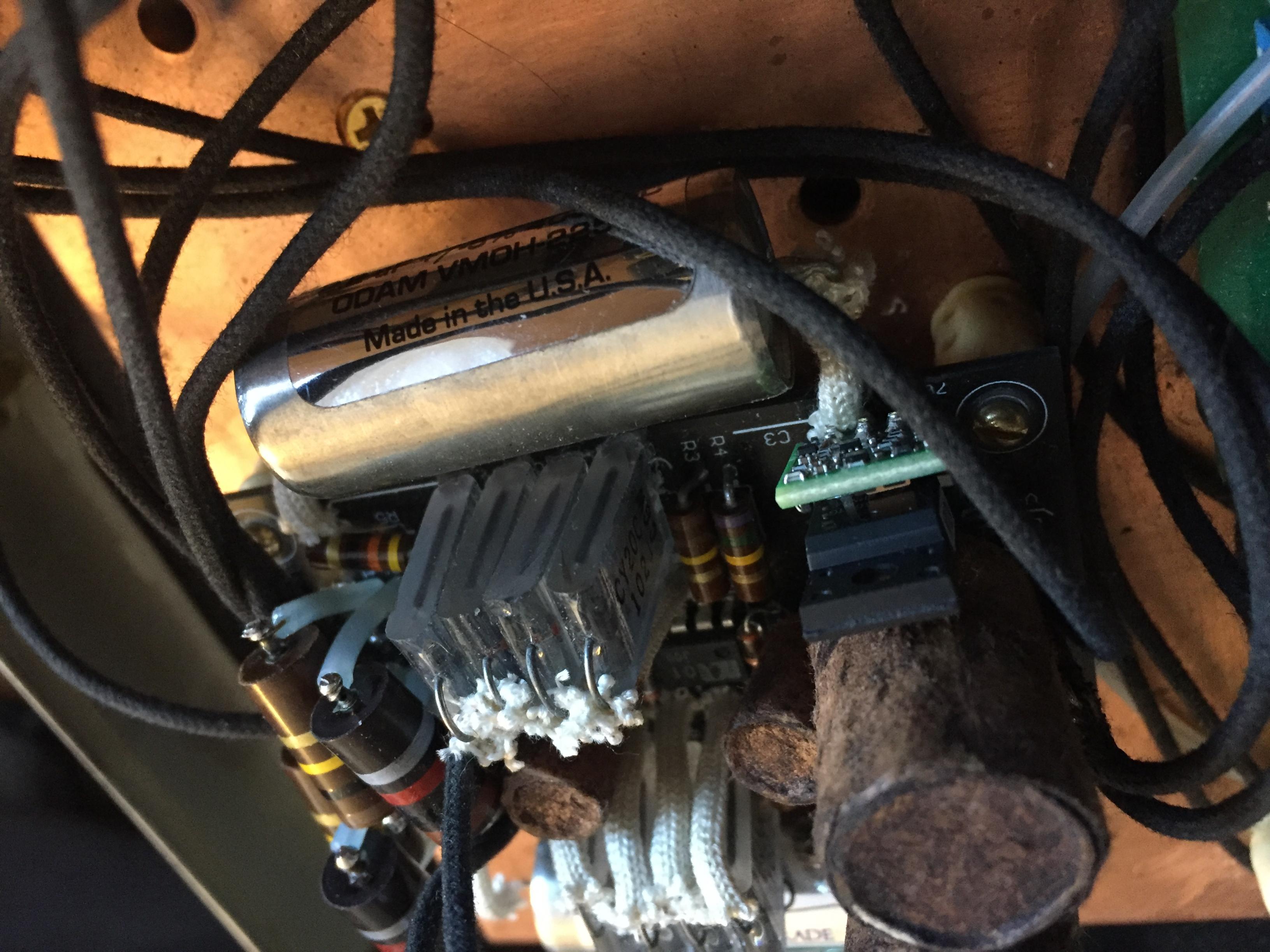

After many problems, my hot-rodded VSPS is now delivering amazing sound in my (mono) system. Very musical and transparent - can hear deep into good recordings - and very emotionally engaging. The OPAMP is a Muses01 (FET). Almost all resistors are Allen Bradley’s, the electrolytic are Audio Note Kaisai models liberated from their aluminum cans and wrapped in Japanese paper casings. The RIAA caps and electrolytic bypass caps are glass dialectic, and the coupling cap is the amazing V-cap ODAM.
The VSPS is fed by an ancient Pickering 380 “Chicken Head” cartridge running at very high tracking force (about 4g). This is mounted on one of Jurijs Redins’ 12” wooden EMT banana replica tonearms (beautiful and inexpensive) which rests, in turn, on an external arm-pod from TemaAudio of New Zealand. The turntable is a Denon VL12 prime “DJ” model.
The VSPS feeds a Stereo Coffee LDR preamp - which in turn feeds a single (highly modded) Brook 12a push-pull 2A3 amp driving stacked Spendor BC-1 speakers. All wiring except the phono cable is Duelund 16 gauge (need to make a Duelund phono cable!).
The preamp is wonderful, and almost certainly my last. Thank you Richard, both for your work, and for your patient help!

Those glass capacitors, must have been quite expensive. Can you elaborate on those?
I now use styroflex caps from Xicon (bought from Mouser) and was also considering silver Mica (CDE) but they were a bit costly.
Anyway, your glass caps must be something else ...
Really nice job and your excellent carbon composite resistors must really match that Pickering 380 (i also had one with the original heavy tracking red conical stylus).
I think the capacitance for that cartridge must be kept low (100pf or lower) and the impedance high (around 100kΩ).
One thing I remember made a nice improvement is to bypass the decoupling caps at the opamp rails.
I have Fine Gold electrolytics, bypassed with Soviet military PEPT. You could also try a nice oil cap ther too if space allows.

Hi Evonimous,
The glass caps are amazing, and can be had for $10-15 on eBay, but most are in the pf to very low nf range, and there aren’t that many applications for them in audio circuits. I first became sold on them when I used one as a coupling capacitor. My Brook amp is really unusual in that it has a 1nf cap in the signal path. When I replaced the silver-mica in this position with a glass dialectic cap there was a vast improvement: something now sounded right that hadn’t before, and I was really impressed by how much farther I could now hear into good recordings (what I like to call “downward resolution”).
I picked the VSPS because it is so minimal that it is affordable to build it with the best parts possible - and because I knew that it sounded great even with pedestrian parts. It has gained acclaim despite the intense unconscious bias against the inexpensive audio equipment! The fact that the values of the caps in the critical RIAA circuit were readily available in glass sealed the deal...
RE the Allen Bradley’s: my experience with glass dialectic capacitors and V-cap ODAM’s has convinced me that capacitors are much more limiting in audio circuits. That they commit profound sins of omission, choking the music and sanding-away subtleties. I guess that’s why Dave Slagle and others go to such lengths to build phono preamps without any capacitors at all. Resistors, by contrast, have much less gross effects. In my experience, they exert a more subtle effect on tone and emotional Gestalt.
I replaced the naked bulk foil 47K loading resistors that I initially built my VSPS with with 100K 2W AB’s and the sound became more coherent and organic and tube-like. Not a controlled experiment because the values are different (and 100K is as you note, better for this Pickering), but consistent with previous experiences. Years ago I played with tantalums in a single-ended amp I built and found them hard and closed-in sounding relative to carbon composition resistors. I bet AB’s are responsible for a lot of the best qualities of classic tube gear.
I don’t find carbon comps noisy. Either that, or I find it possible to hear very subtle detail underneath their noise. Less-than-great capacitors, by contrast, though not audibly noisy, really strip away subtle detail.
Finally, to make a good point about the Pickering 380’s need for low capacitance cables. Perhaps Duelund wires aren’t the best in this context. Can you tell me a little more about your experience with a 380? What do you recommend to get the best out of it?

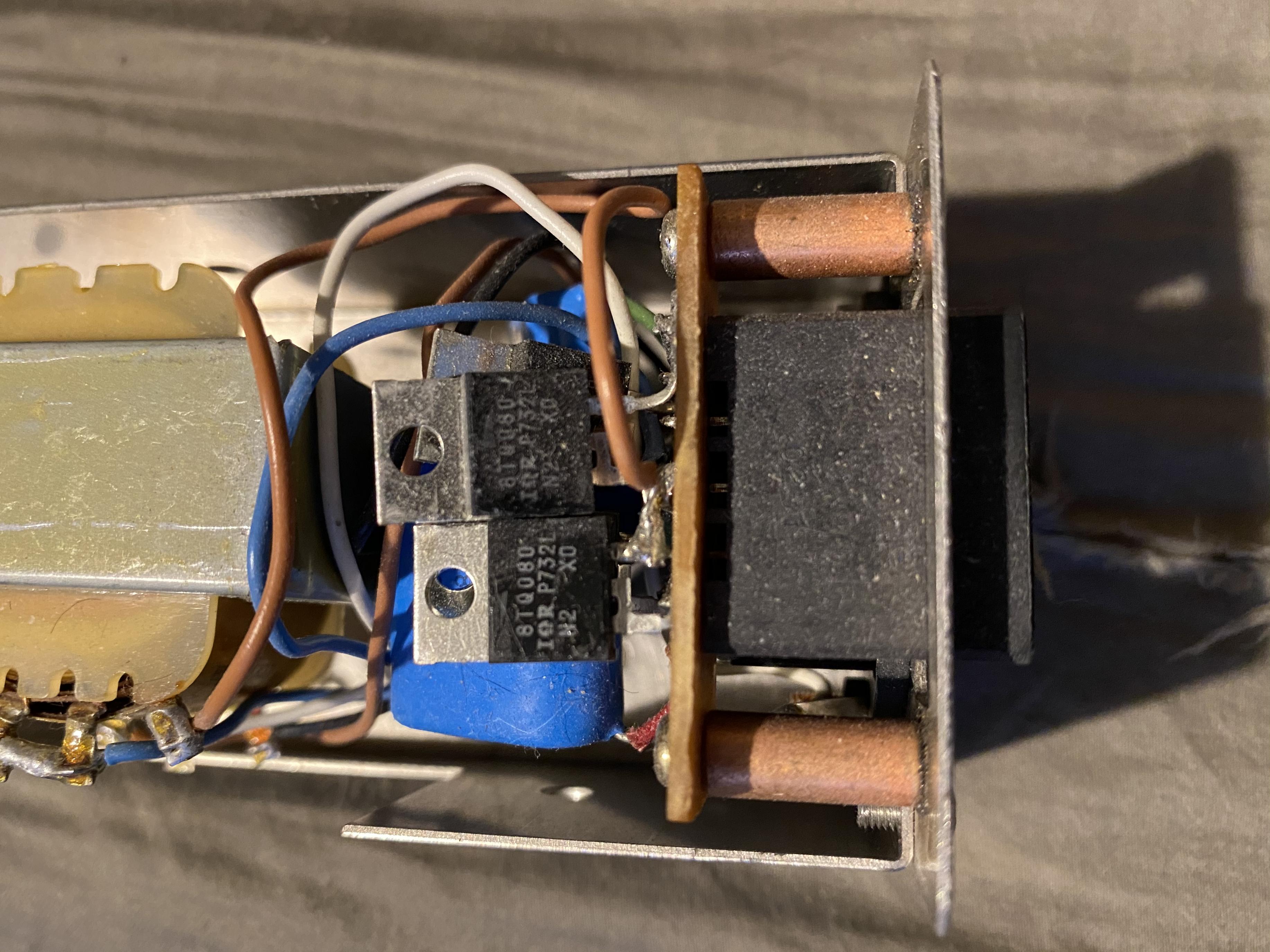

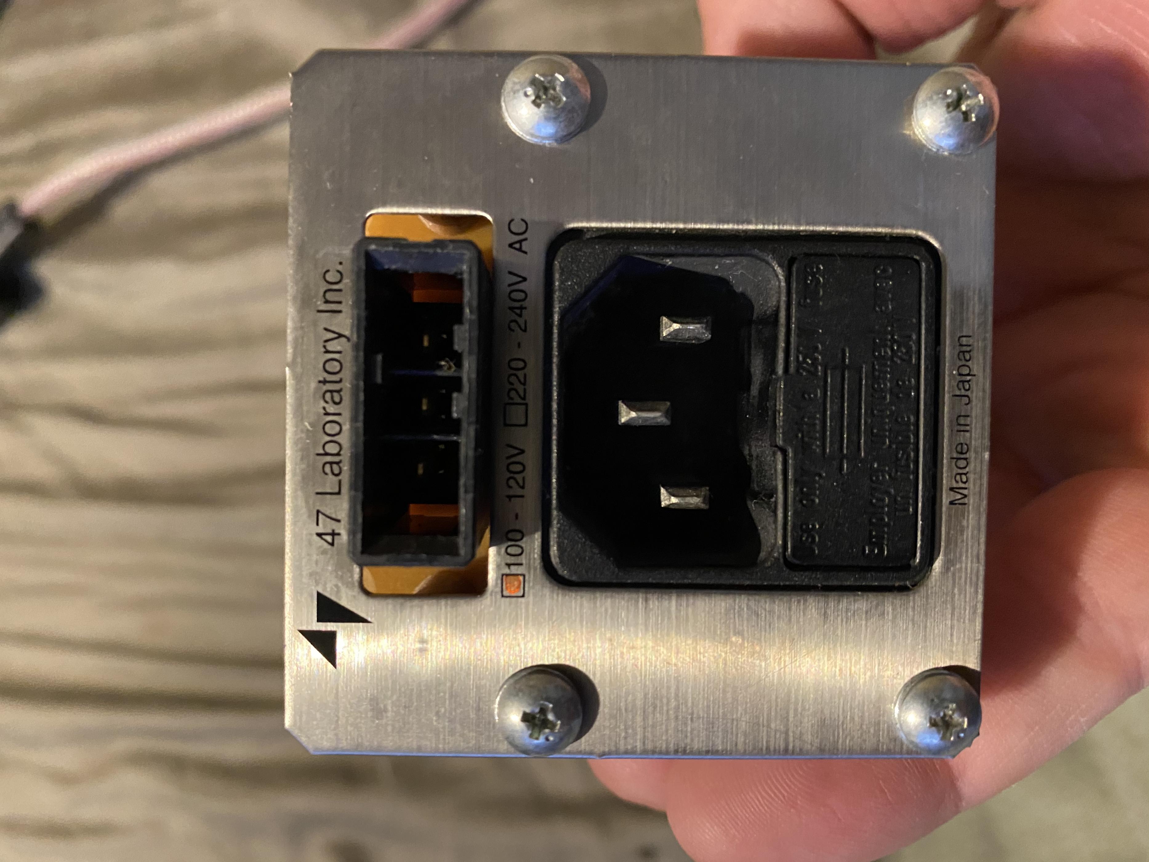

Quick question...
I picked up a 47 Labs power supply that was missing it’s ceramic case for next to nothing.
It outputs +/- 19.3 VDC
I wanted to use it as the form factor is good.
I am currently using a Triad 12volt and recommended rectifiers-which I will not use if using 47 Labs power supply.
Should I change anything on the PCB?
Thanks in advance,
Johnny
Neat! Can you post a pic showing the transformer and diodes please?
19 VDC is about what you'd expect from a 12 VAC unloaded, I beleive it is 2x12 VAC R-core, so you can just use it with the RJM audio PCB with no adjustments needed.

The transformer is a Toyozumi HTW-1203.
The rectifiers are nice though, International Rectifier 8A High Performance Schottky Didoes
