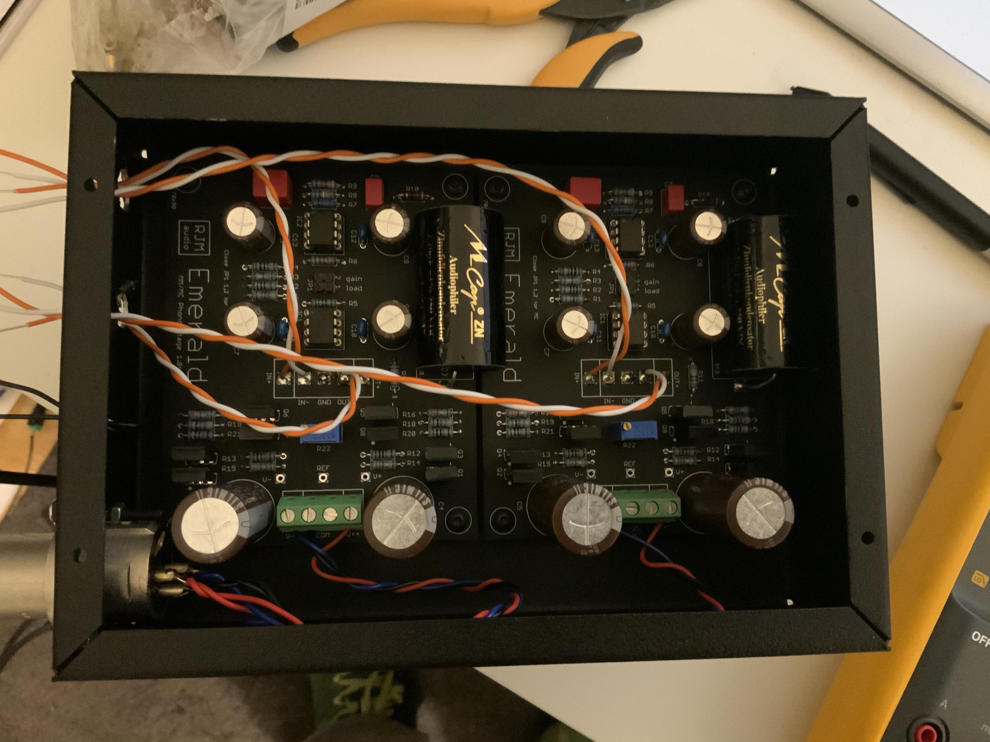

While our workshop access in the office is restricted I thought of just finishing the Emereld without a bigger case (and not the best looking..)...so:
My V++/-- is 16.5ish but when I try to match Ref with V+- one side has equal voltages with V+- = 12.97V and the other with V+- = 12.65V
Any idea why is that?!

That's normal because the regulated output takes the diode drop V_be of the transistors Q7 and Q8 as its reference. You'll have some variation in the transistors, so the output varies in proportion.
I know it gets on people's nerves because everyone likes perfection, but a few hundred mV on the rails isn't going to change anything and is nothing to worry about.
[If I'd cared enough, I could have made it that V+ and V- were independently adjustable by simply adding a second potentiometer. It's one of those cases where "close enough" is fine, so I didn't bother.]

thanks for the reply!!
So no imbalance in the audio signal due to this 0.5V diff between channels?!
One other thing I realised is that the power supply (all based on BOM, VPM24-1040 with White and Violet for 240V and Yellow/Orange - Black/DeepRed on the two rectifiers) is 'leaking' 0.5V on the V++ side when OFF. Im a complete newbie when it comes to mains power supplies...
Is there an obvious mistake?!

- no, no imbalance, the enormous DC feedback over the op amps takes care of that.
- if there is no power applied to the transformer, there can be no voltages ... but sometime residual polarization in the electrolytic caps can cause some voltage to be measured even after the power as been off for a minute or two. It's not "leakage" as I understand it, unless I have completely miss-read what you observe.

I think I have connected the fuse/on-off in a wrong way as with the switch OFF there is a big of voltage on the ++ side. Am I looping to ground or something? If I unplug the power cable complexity of course I have to voltage as you said.
You've definitely done something very wrong if the power switch doesn't switch off the power completely.

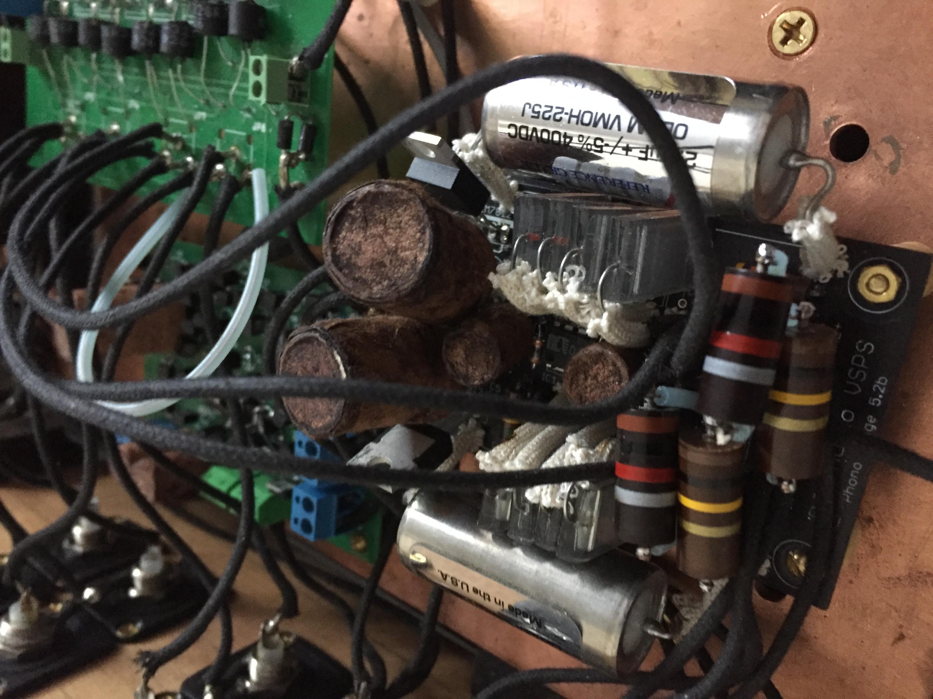

After many problems, my hot-rodded VSPS is now delivering amazing sound in my (mono) system. Very musical and transparent - can hear deep into good recordings - and very emotionally engaging. The OPAMP is a Muses01 (FET). Almost all resistors are Allen Bradley’s, the electrolytic are Audio Note Kaisai models liberated from their aluminum cans and wrapped in Japanese paper casings. The RIAA caps and electrolytic bypass caps are glass dialectic, and the coupling cap is the amazing V-cap ODAM.
The VSPS is fed by an ancient Pickering 380 “Chicken Head” cartridge running at very high tracking force (about 4g). This is mounted on one of Jurijs Redins’ 12” wooden EMT banana replica tonearms (beautiful and inexpensive) which rests, in turn, on an external arm-pod from TemaAudio of New Zealand. The turntable is a Denon VL12 prime “DJ” model.
The VSPS feeds a Stereo Coffee LDR preamp - which in turn feeds a single (highly modded) Brook 12a push-pull 2A3 amp driving stacked Spendor BC-1 speakers. All wiring except the phono cable is Duelund 16 gauge (need to make a Duelund phono cable!).
The preamp is wonderful, and almost certainly my last. Thank you Richard, both for your work, and for your patient help!
Dint
Dint

Hi Dint,
Wow, that's ... I mean I've never seen anything quite like it, but I love it! Very 2020, a VSPS // Apocalypse Edition.
I'm almost afraid to ask but ... what did you do to those electrolytic caps? They appear to be covered in peat.
