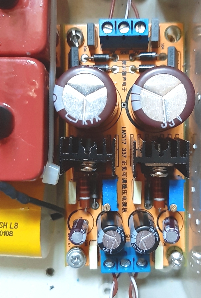

Hello there,
I 've been using a dual regulated power supply board based on LM317/337.
It's available as a kit if someone wants an adjustable supply.
The result is zero noise and a range of supply voltages.
Right now I've been using an LME49720HA opamp (metal can package).
IT is very detailed and i am happy with it.
It can be too prescise and maybe a bit on 'dry' at times.
Especially if you are coming from an OPA2134.
Muses01 is certainly smoother but it's a lot more expensive.
Muses8820 is a good choice being more warm and I think it is better value that Muse01.
An overall improvement was achieved by changing the WIMA RIAA capacitors to XICON polysterene.
Also, further improvement was achieved by replacing the TDK ceramic bypass capacitors with XICON polysterenes. The improvement was more evident when I using the LME49720HA opamp. Maybe it's more sensitive to bypassing.
Overall I am very pleased with this RJM's product and his support!

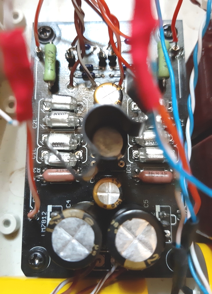

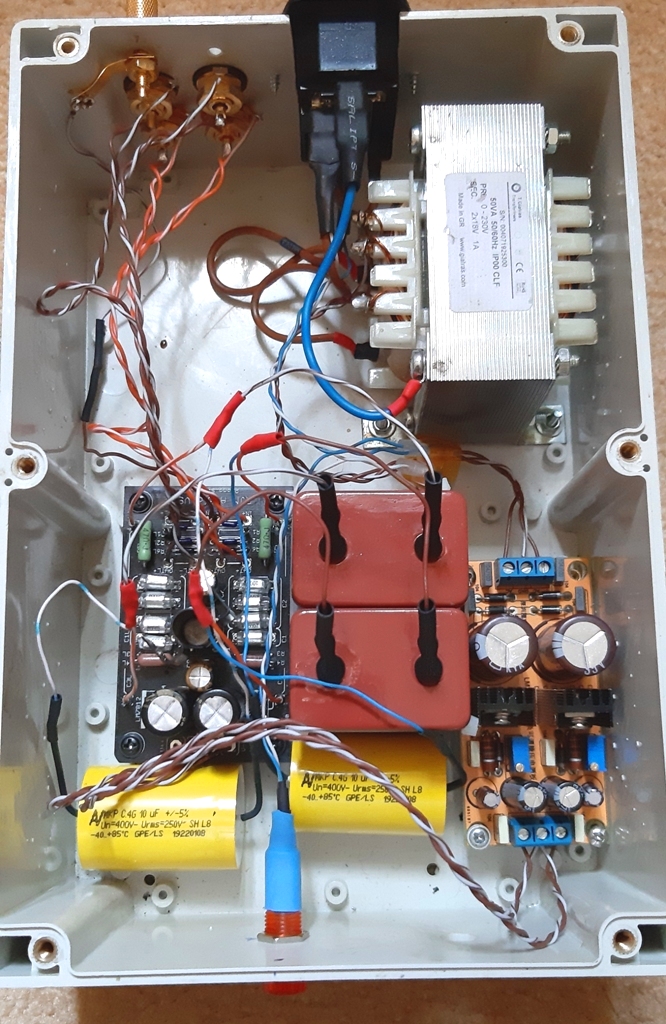

Thanks for sharing your tweaks and impressions! Do you have a photo of your power supply board?
Here are some pictures of the project as of lately.
The XICON styroflex capacitors are in parallel with the electrolytics but are not visible because they are under the board due to space.
Here is the schematic for that thing.
I added a couple of Vishay tantalum capacitors in parallel with the Adj capacitors.
