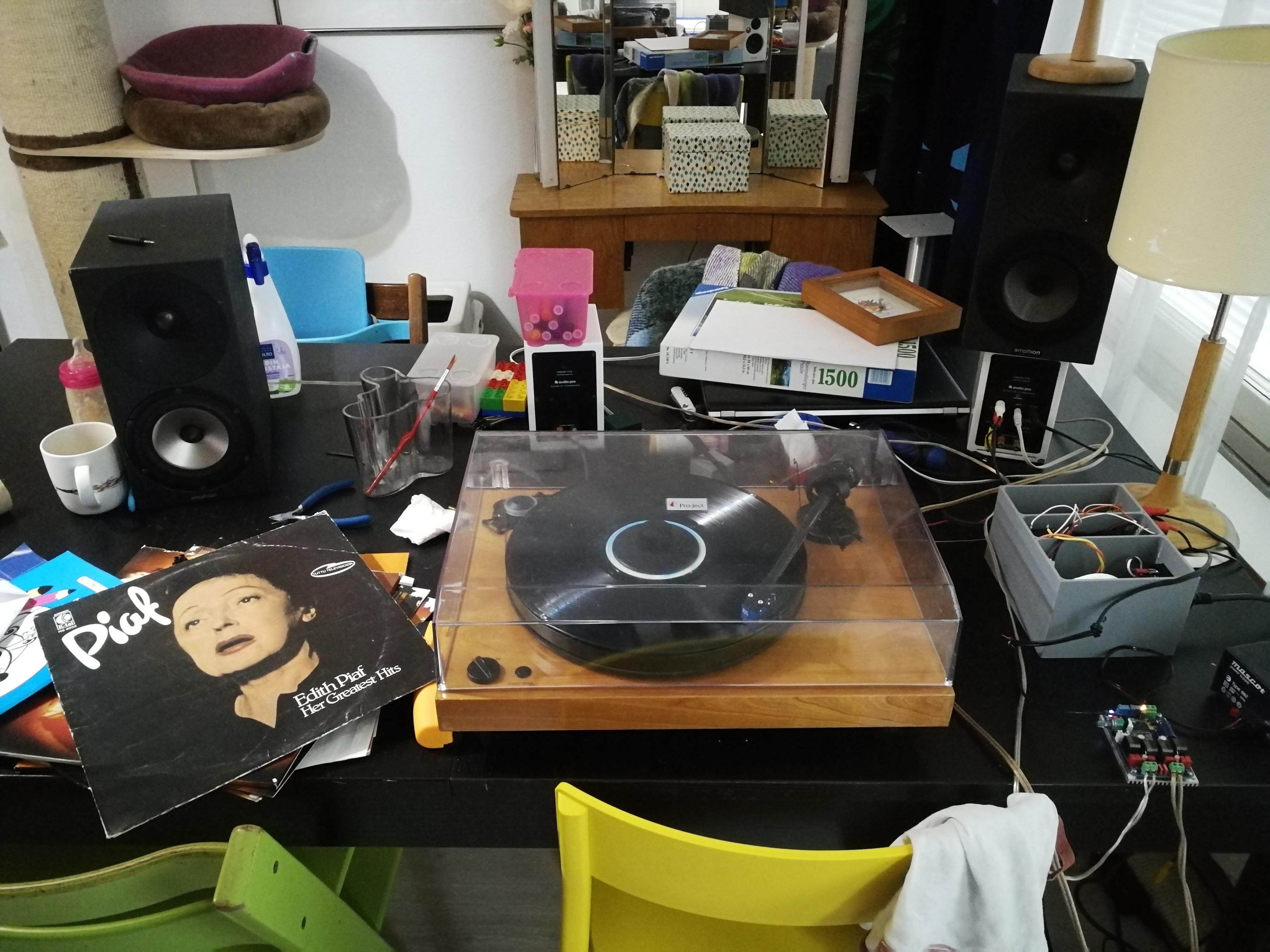

Back again,
There she plays! I was slightly worried at first when i hooked this to the small Audio Pro Addons i have for the missus laptop. Something in the active side of those spekaers made a ever so small hiss of sort.
Currently playing from HIFIMEDIY T1-M TK2050 stereo amp i have cued for a portable boombox. Power from mascot 12vdc 1.3a general transformer. I changed to my amphion argon 1s with this. TT is a Project Audio made with blue point n. 2, FYI for those interested.
And as you can see from the picture nothings is nice and tidy on the test setup, wires crisscrossing around, ac there dc here, rca between etc xD but i'm happy to report no hiss nor buzz neither no hums nor anything off what so ever. Only the happy clips you get from old LPs.
I'll update again when i get this fixed to my main system. And have the box finalized.

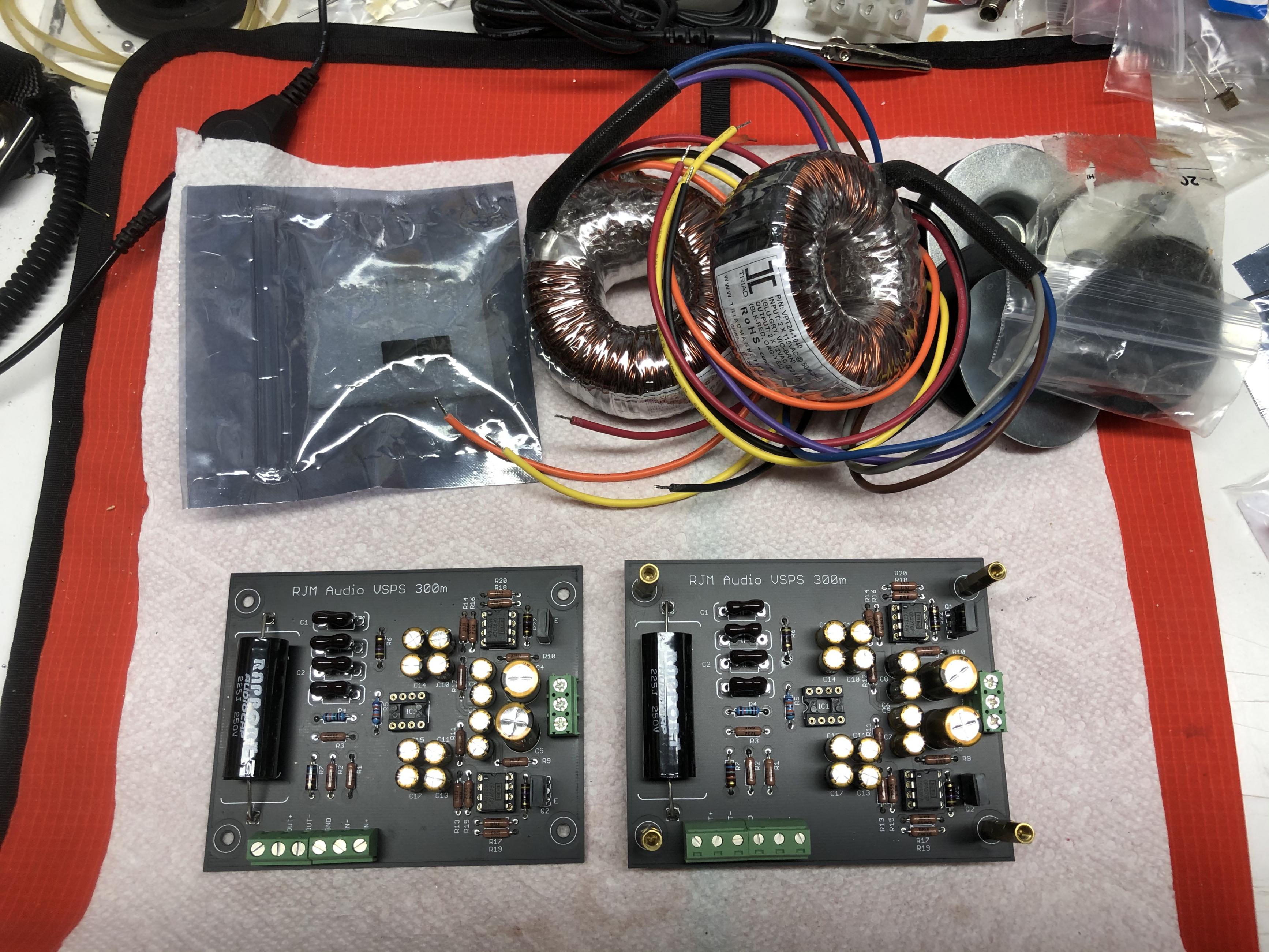

Hi Richard
I just came into a partially finished VSPS 300m with what looks like almost everything I need to finish it. I attached a pic of the boards, transformers and extra op amps. I also got some other items to help finish it like IEC inlets and some nice Rane RCA sockets.
It looks like I basically need to come up with two cases and make all the connections assuming there’s no issues with the boards as they are populated.
I bought this with the intention of trying to substitute it where I am using one of the Boozehound Labs jfet phono amps.
I have the Boozehound running off of a rechargeable NiMH power supply and wired so I can switch a ZYX head amp in and out in front of it so that I can use MC cartridges with the head amp and just the jfet phono amp with my MM carts.
I’d like to know if there would be any issues trying to do the same with this VSPS albeit with the transformer based supplies. I would build it with two supplies, one for each channel.
I’ve used the search on this thread and Googled RJM Audio 300m and got very few hits and none of which that could give me specifics about this particular version of the VSPS.
I did read the various assembly guide info on your website, but it seems focused on building the dual board Emerald. The VSPS supported is the single board version.
Can you provide me any specific information regarding how this version should be assembled with its supply and any specifics about implementation regarding compatible or incompatible carts.
Also information about gain structure and what the result of implementing the extra op amp at C1 results in would be great.
I suppose the easiest thing might be a pdf if there was one archived That you could send me.
Any help you could provide would be great.

@chromenuts
That's a kit that someone has put together but, I suppose, never built.
The main thing you are missing, besides the case and connectors, is the bridge rectifier.
Everything about hooking up Emerald or Phonoclone applied to this version of the VSPS also. The VSPS300 is a carbon copy of the Phonoclone 3, but with the VSPS circuit substituted for the Phonoclone. It's the previous version using the X-reg, rather than the Phonoclone 4, VSPS400 (discontinued), and Emerald which all use the S-reg.
Drop me a pm with your email address and I'll send you the pdf instructions for the VSPS 300 kit.

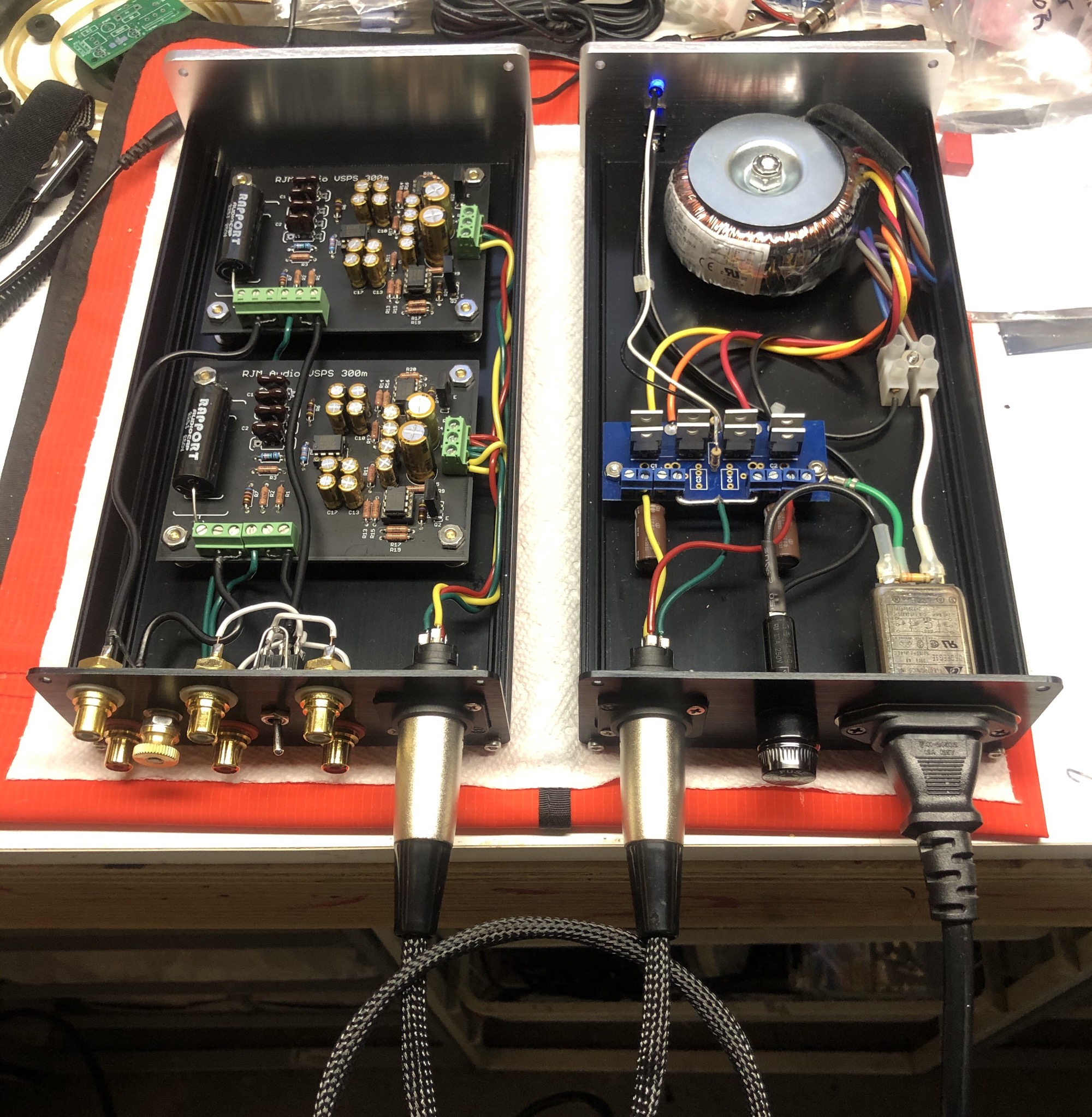

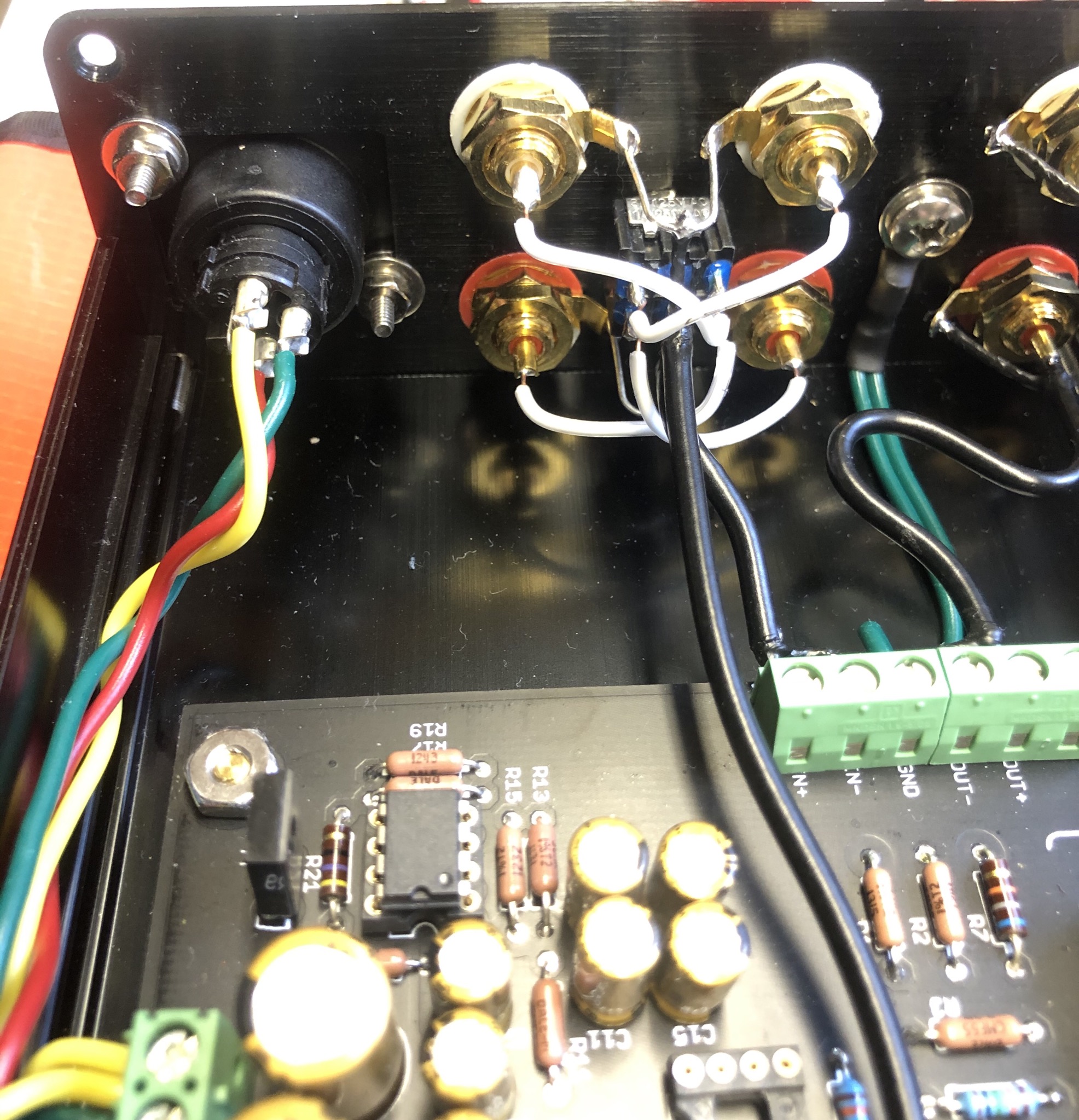

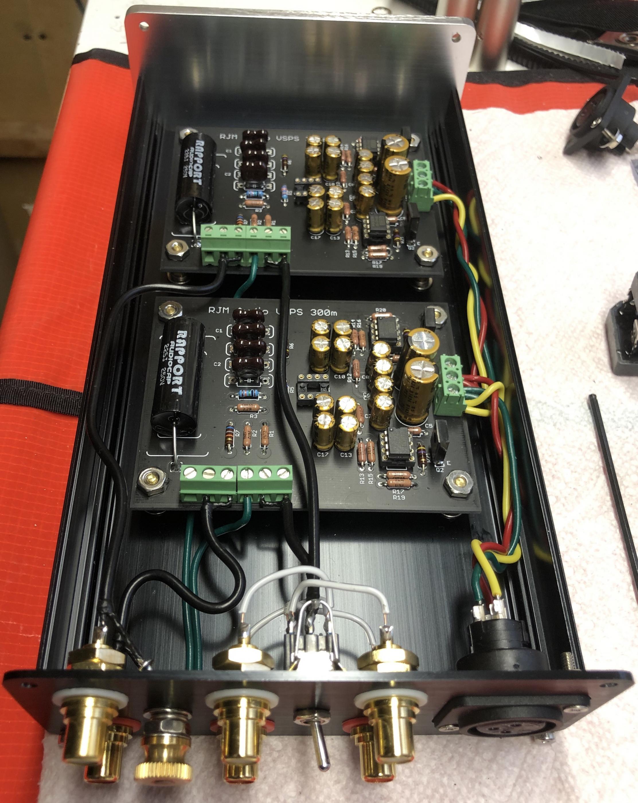

Hi Richard
I’ve been putting this VSPS 300m kit together over the past week. I’ve got the case for the boards pretty much finished the way I want it.
The cases I had on hand were a little too small to run dual power supplies so I decided to just go with a single transformer with dual primary/secondary and rectification.
I realized I had a rectifier board lying around from one of Peter Daniels gainclone kits I had built. There is no snubber or caps populated on it.
You don’t call for any filtering, caps or otherwise in your instructions (though I think it is an option with this board). I’ve included a pic showing how I want to use it. Do you see any problems?
Hi Richard

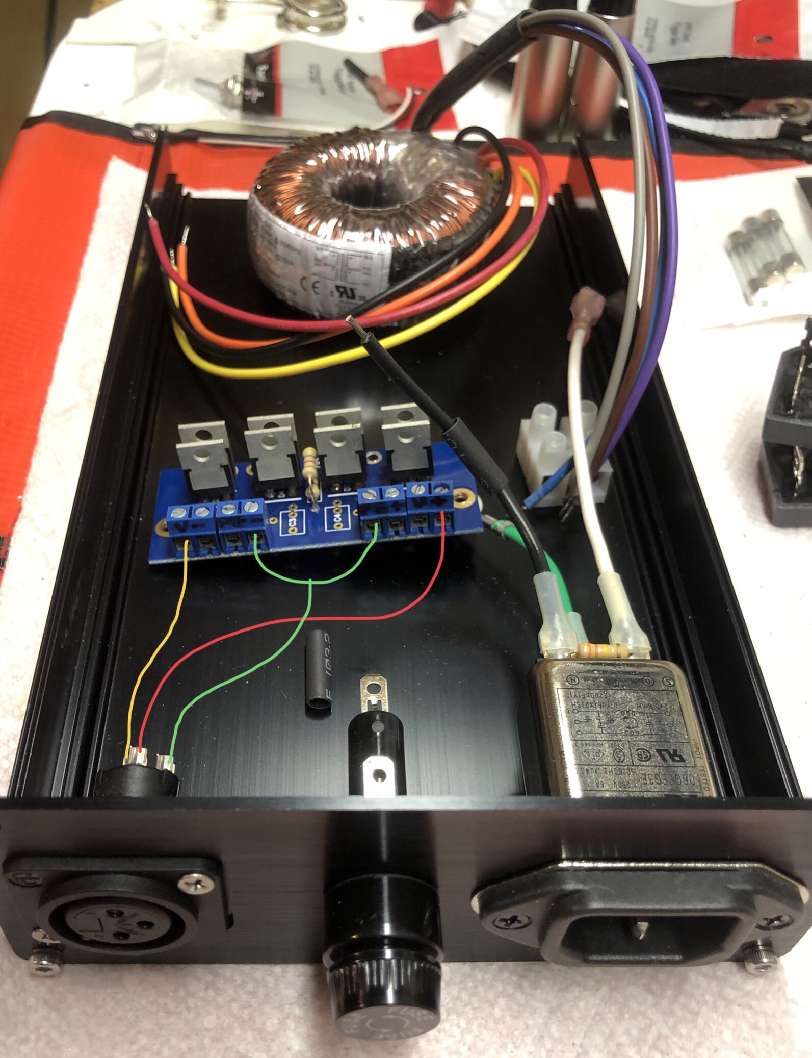

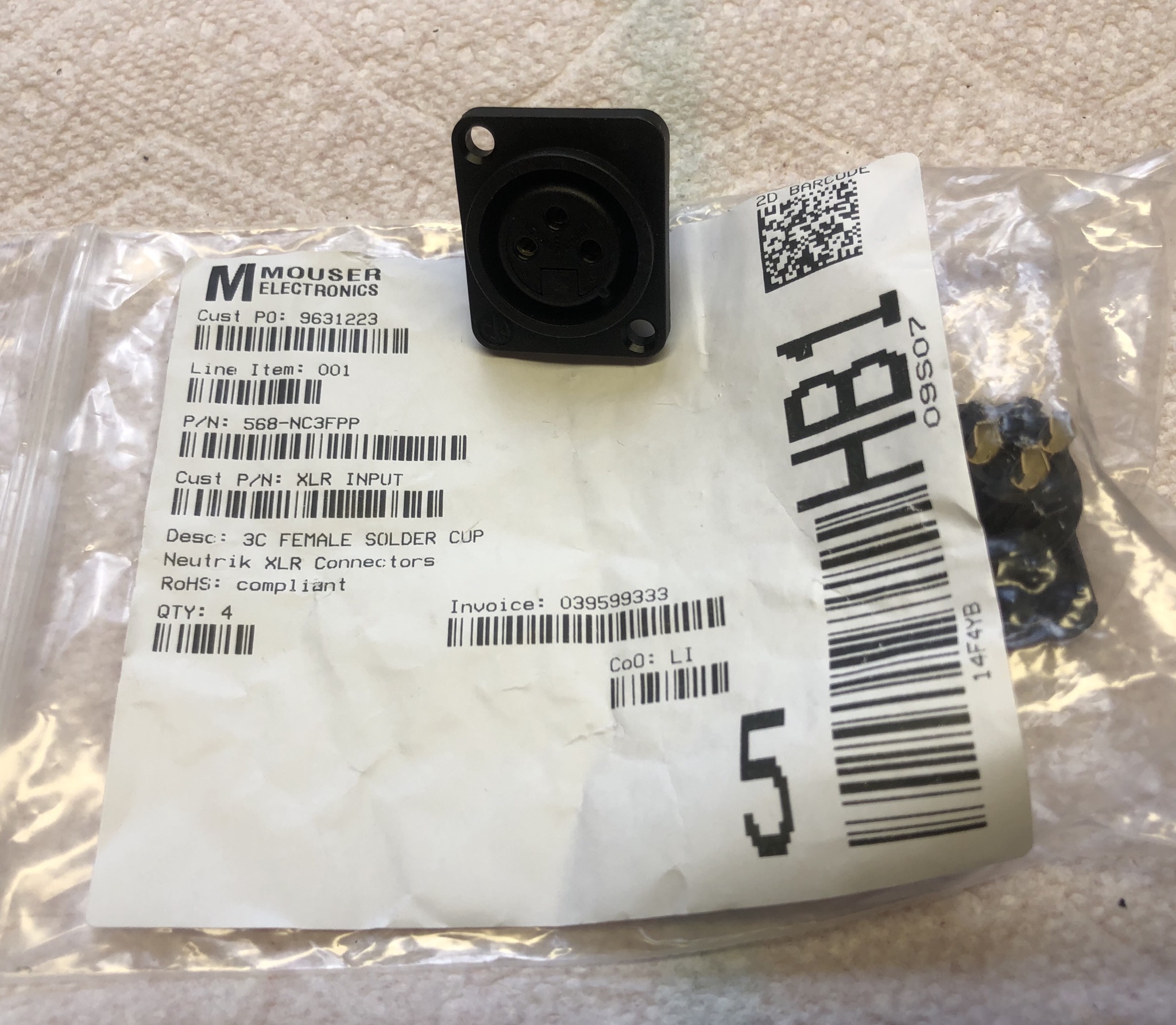

Do you mind sharing where did you get cases?
The cases came from eBay. Sold as power supply cases. They are pretty affordable at about $26 each shipped. Not sure how shipping is going these days out of China.
Power supply Amplifier Chassis / DIY Aluminum Case /size 248*134*55mm | eBay
They come with a cheesey power inlet/switch assembly that doesn’t have a third grounding prong similar to laptop bricks. I didn’t use it.
Instead, I mounted my Nuetrik connectors where they machined the case for that inlet. It was almost a perfect match in dimensions. I just had to get creative with the mounting hardware holding it in place. I attached a pic of Mouser bag with P/N and socket.
I have a small milling machine, so I just machined proper size holes for my IEC inlet, fuse holder, RCA and etc.

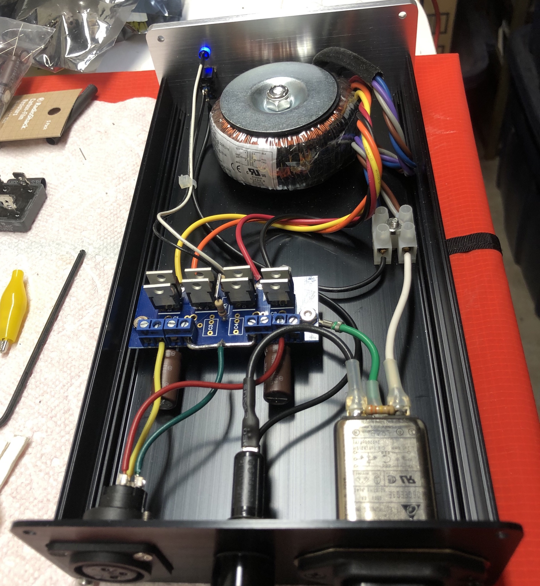

Hi Richard
Thanks very much for the kind words. It was much easier to wire the selector switch right between the inputs as opposed to mounting the switch on the front panel as I did on my last phono amp.
Things have been a bit hectic with everyone being in the house 24/7. I ended up staying up until 3AM last night so I could finish assembling my power supply.
A quick test across my rails told me I had about 38V DC. It’s a little high, but when I tested my mains voltage at the IEC inlet it was slightly over 120V AC. I know there are fluctuations in the mains throughout the day anywhere from 5 to 10V. I’m thinking it was just at a high point at that time of night.
I’m going to try and build my umbilical later today. Then I can test voltages on the amp boards and hopefully pop in IC1 and give it a try in my system.
It's clear from the photo you know what you're doing. 38 V is ok, it's unloaded and you have capacitors at the rectifier output. 30-40V range is fine.
By the way you may find it sounds better when you remove those electrolytic caps on the rectifier board. The phono boards already have sufficient filter capacitance, and for some reason splitting the capacitance near/far from the amp introduces some weirdness, sonically speaking.
Hi Richard
Thanks for your comments again.
I wasn’t sure if I should include any additional capacitance at the supply or not.
I’ve read more than once in the past that when separating a power supply from a sensitive circuit with an umbilical that it was a good idea to have some capacitance in the supply case and at the circuit.
This rectifier board had the option of adding a snubber which would have resulted in having much larger caps at the supply which I decided against.
As it is, there is only a small 35V Silmic 100uf on each rail. One leg can be easily lifted to test the supply without them.
I finished the umbilical this afternoon and moved on to firing the amp board up and testing my voltages in the circuit.
I’m very glad you were able to send me the original instructions and that I followed all of your start up advice.
I immediately found an issue when I went to test for -10V at pin 4 of the IC1 socket on the first board. There was no voltage.
After rechecking the data sheet for the opa27 and your circuit board diagram in the manual I realized that the original owner of these boards had populated the IC1 socket with its notch reversed to the diagram. I wasn’t testing at pin 4, I was testing at pin 8.
I didn’t really want to have to take the board out and de-solder an 8 pin socket...especially since I recently ran out of soldering wick.
I noticed there was no “key” preventing the op amp from being inserted in the socket with the correct circuit orientation. I simply filled the original notch at the wrong end with some liquid tape and put a notch on the correct end of the socket for my own reference and peace of mind in case I were to ever go back in thinking of trying any different op amps.
After that everything went pretty smoothly. Getting those little bugs into their sockets was a bit of a pain. I have big clumsy fingers and no tool to hold them properly. The legs started to bend on one, then it jumped out of my hands and onto the floor while trying to straighten it out. I don’t think it got damaged as I retested everything once they were installed and all seemed OK.
I didn’t have time to switch the amp into my system today...too much going on. Hopefully tomorrow I will be able to listen to it.
