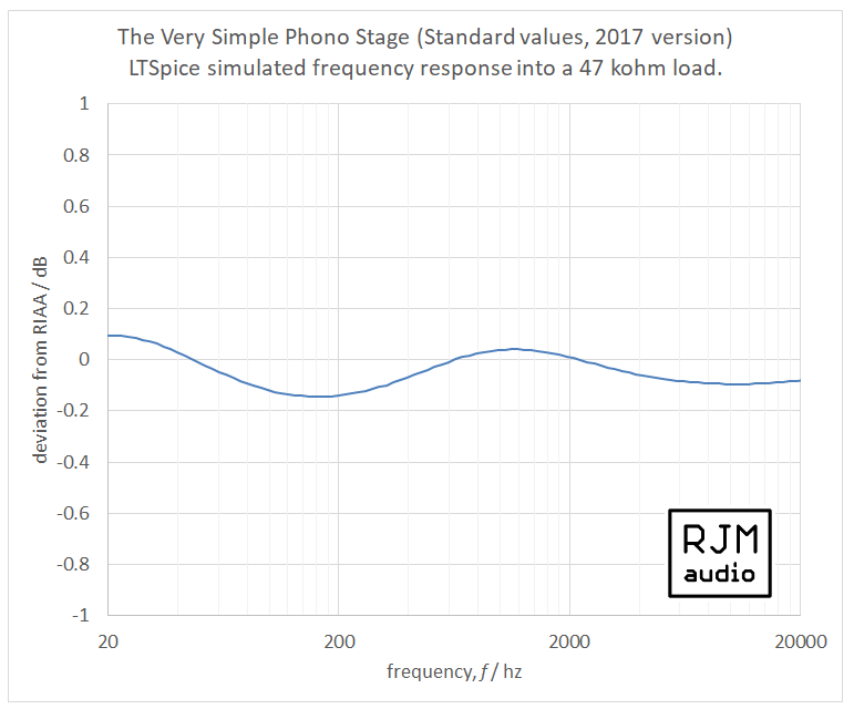

...the rising frequency response above 20 khz rather unnerved me! Is there a way to add simple filter on the output to roll off the response and maintain close adherence to the spirit of the original RIAA phono playback specification?
First off, the frequency response of the VSPS doesn't rise at high frequency. It just stops falling. Normalized to the RIAA response however, it actual HF response exceeds the RIAA standard, so the response plot ticks upwards.
Several years back I revised the VSPS circuit to remove the "Allen Wright" 50 kHz time constant responsible for this leveling out of the HF response. The response is now flat to 20 kHz.
If you want to quick-and-dirty mod your VSPS, just short over (or replace with a wire) the resistor which is in series with C1. I think it was labelled R3 in the original version, and was nominally 2.2 kohms. If you want to go all the way to revise your VSPS to the current version, change the 105kohm resistor to 110k, and the 732kohm resistor to 768k.
