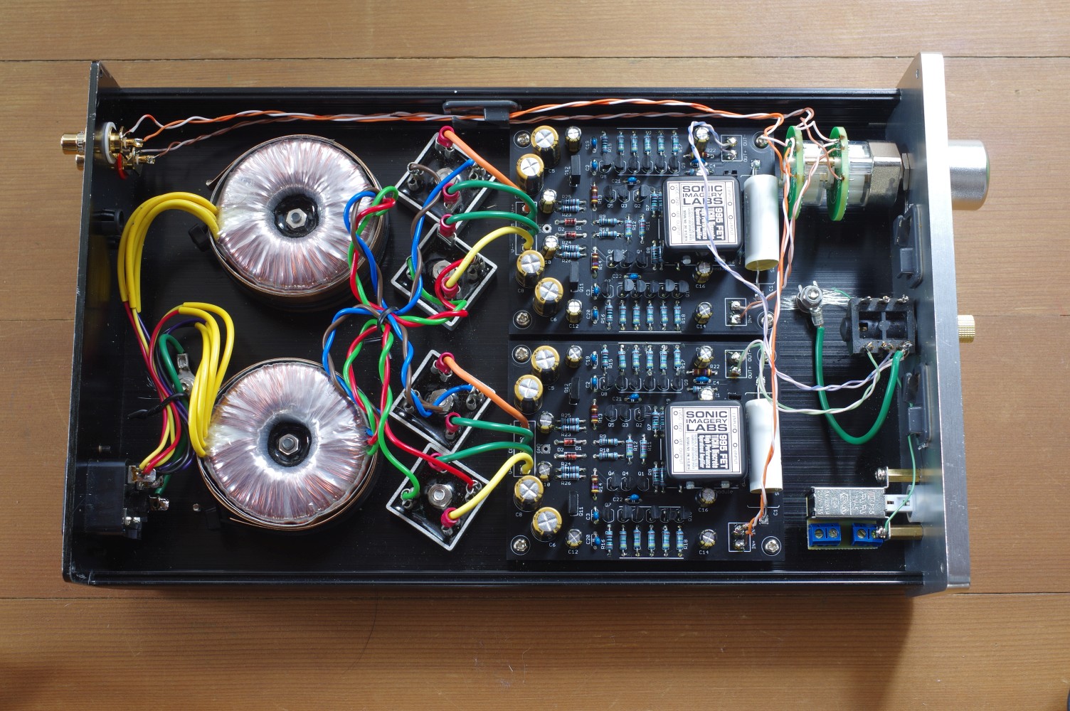

Just adding my VSPS build to the thread. All latest BOM parts apart from Mundorf coupling caps. IMO, always worth spending a few quid on a nice case and I find the single case a simpler build, with good layout the amp is ghostly quiet. Switch is on the back panel to keep wiring simpler. Sound is superb, just like I was expecting after reading all the feedback on this thread. Expect to see a Graham Slee Era Gold on ebay very soon!!!
Lol! Glad it worked out. That's a nice traditionalist VSPS build, good proof that it works well in a single case without having to do anything fancy.
I suppose the only features missing are a front panel power switch and indicator LED - that, I admit, I don't usually bother with myself.
I think that front switches and LEDs are a must for commercial products but DIY and personal use does away with such frippery😉. Besides, having a switch on the rear panel is no great hardship, I will in any case leave the amp on most of the time.
Nice and clean! Looks a lot like my own build before I buffered it with Richard's excellent bboards!Just adding my VSPS build to the thread. All latest BOM parts apart from Mundorf coupling caps. IMO, always worth spending a few quid on a nice case and I find the single case a simpler build, with good layout the amp is ghostly quiet. Switch is on the back panel to keep wiring simpler. Sound is superb, just like I was expecting after reading all the feedback on this thread. Expect to see a Graham Slee Era Gold on ebay very soon!!!
My enclosure is even smaller but I too have zero issues with hum, despite the toroidal being so close to the boards!

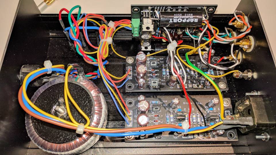

Nice transformer BTW, with sleeved leads
It is the VPM24 transformer from the BOM. I add sleeving to the primary leads just as an extra measure, probably a bit ott but only costs seconds and pennies!.
I think it makes sense to start with the bog standard board and parts and have a baseline sound to compare any mods to. At the moment though the amp sounds so good I have no real incentive to change anything!!
