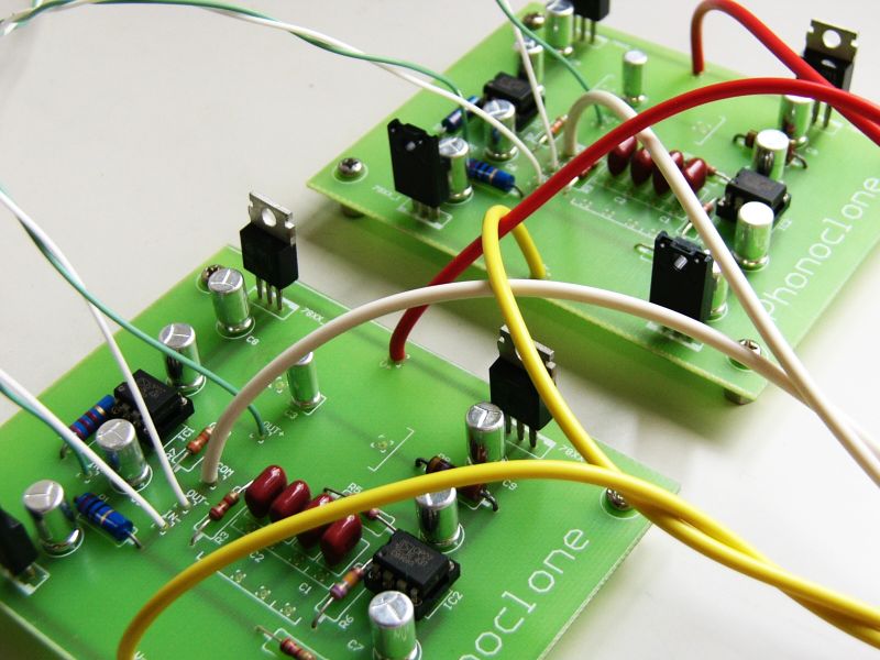

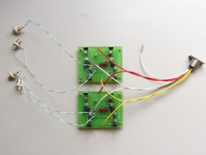

Pictures of the completed Phonoclone (2)
The gritty details: Panasonic filter caps, polypro RIAA caps, Black Gate output coupling. Riken Ohm (R1, R2), Allen Bradley (R8), Takahashi (?) carbon comp resistors (RIAA), and Panasonic carbon films for the remainder (R3, R4, R7). Socketed Analog Devices OP27 input and output.
I was asked to build one, so I did. This is the result. The stuffing and soldering when smoothly with no problems. I'll be giving it a quick test listen before I ship it, and report back here if I encounter any anomalies.

Initial comments, with both channels working.
- 100uF is a sufficiently large value for C8-C11. (Original prototype had 220uF)
- R2=1k2 gives a very useable gain with the DL103 @ 40 ohms. Total calculated gain 60 dB, 30 dB per stage.
- Noise is on the same level as the prototype, with a little bit more hash - most of this is surely due to it running as in the photo above, no case and unshielded wires dangling all over. Noise makes no impression at normal listening levels, even now.
- No hint of any RFI/EMI problems.
- Black Gates burnt in for 100h at 20V AC prior to use. OP27s also burnt in for several hundred hours. (used previously in my prototype.)
