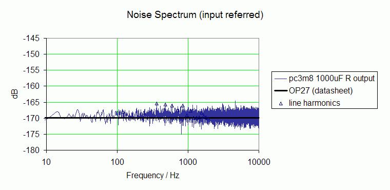

sweet sound of ... nothing
To prove it could be done I put 1000uF of extra filter capacitance on each rail and re-measured the output noise.
There you are: the OP27 noise, and nothing but, up to 10 kHz. (Its looks clean up to 100k, as a matter of fact, but my measurement system has some noise spikes up there so it doesn't present well.)
And on the seventh day... zzzzzzzzzzzz.
/R
/R
Re: sweet sound of ... nothing
Am I correct in assuming that this is on the power supply rails before the regulators? Just to make sure. 🙂
rjm said:To prove it could be done I put 1000uF of extra filter capacitance on each rail and re-measured the output noise.
Yup. 1000uF after the diodes, 100uF in front of each Vreg, 100uF after. All are Chemi-con KMG standard type electrolytics.

Although adding the extra 1000uF of capacitance improved the measured noise performance, subjectively it completely killed the sound.
I dont know why. Have to do more tests first. The difference however was quite striking. The musical presentation was more controlled, solid, with better resolution of low level detail - but by the same token caught a serious case of "hi-end blah". Sounds good - but really, really boring. Like someone shaved all the sharp edges off. Lost all sense of rhythm.
So, like the gainclone, I have to recommend no additional capacitance in the power supply be included. How much filter capacitance (before the regs) I havent worked out yet. To my ears 100uF per regulator is fine, but up to 470uF would help to reduce the ripple harmonics at the output.
/R

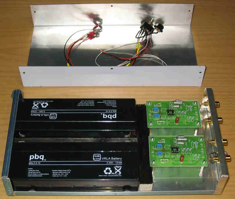

I just built a second phono stage, designed by you: the VSPS, to play a little bit with different input-Z in conjuction with my DL103.
I will compare it with my phonoclone. It has a socket for the opamps to compare different opamps.
As I will be a member of the next European Triode Festival in beginning of december, it would be a nice idea to prepare a VSPS for the phono shootout. Imagine a IC-amp competing to a triode pre for example made by Steve Bench...
Could you please simulate or suggest a configuration for the Benz Ebony HO cartridge?
