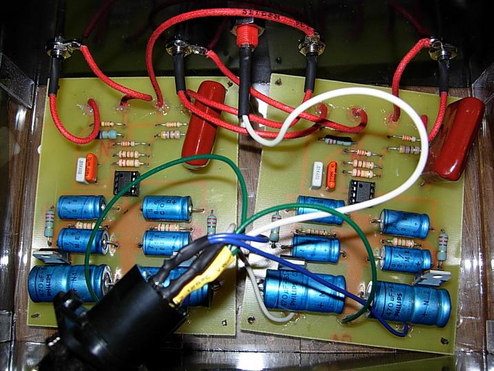

Hi everyone, I've just completed my vsps project to the point where things actually work. I did this as a personal project for my grade 10 electronics class. Although I think it sounds quite clean, I think there is there is not enough bass and soundstage, and a bit too bright. Is this to be expected? Maybe I should change all my resistors to better quality ones or my op amp NE5534 to something better. Or is there something wrong with my RIAA capacitors? I would like to make it sound much warmer and better than my original Luxman built in phono stage. I tried to make my box see through, but the glue kinda made it ugly. Overall, I did my best....having spent nearly four weeks building it. Any suggestions would be appreciated. Thanks.
Double check that the caps in the RIAA section are correct - when I first built mine I had some of them wrong (used some of the ones for the lo-Z version for the hi-Z version which was what I was actually building - D'Oh!)
Anyway, what I heard was a thin sound though detailed, not as bad as you'd expect considering what I did, although my soundstage wasn't affected. Check your nf to uF conversion too.

I have one more question, there is this moderate hum that I get when i turn up the volume and kinda gets annoying. I think there is something wrong with my ground. Is it because I used a plastic box instead of a metal for to put my actual phono stage? Or could I get rid of the problem by properly grounding the power supply box? Right now I have all the COM connection and turntable ground going to the COM in the transformer. Any help would be appreciated.
Have you checked the VSPS construction guide on my web site? That may give you some help. It could be the plastic box, but it more likely either a grounding error. Sketch out your connections and post it here. Its not possible to proceed further otherwise.
