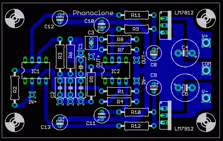

Phonoclone PCB rev. 27a
As promised here is the Eagle .brd file for the latest Phonoclone revision. It is a 1/4 Eurocard, VSPS-sized "mini" board again, the only change from the last published version 26j is to the power distribution lines between the opamps and voltage regulators.
It is configured to the layout I am now using myself - although in my case I jury-rigged version 26j with flying leads to achieve the same thing.
The change is to go with separate, single stage RC filters for each opamp, rather than the RCRC combination originally set in 26j. Its very light filtering, the resistor is only 10 ohms. I suspect most of the difference is from decoupling the opamp from the regulator output rather than noise reduction per se. Anyhow, I find this arrangement works very well.
I havent ordered this from Olimex, so there are no phototools on file with them. You'll have to submit the brd file to them yourself.
/Richard

For the non-Eagle-using readers, this is what it looks like.
All the core components are as previous, but the regulator parts are as follows,
C4,C5 : 680 uF
C8,9,10,11,12,13 : 100 uF
R9,10,11,12 : 10 ohms
The above values are "factor of two" accuracy, i.e. the resistors should be between 5-20 ohms, though obviously the same value should be used for each one.
The regs are as stated, LM7812 and LM7912, but 9V or 10 V versions are preferred if you can find them.

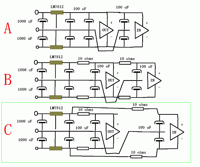

Comments on voltage regulation
I should explain a little about the phonoclone RC.
In the beginnings of the Phonoclone there was a version, not shown in the image below, where each op-amp was powered by a separate regulator unit. For grouding issues this didnt work properly. So I moved to one regulation unit per channel. Early versions were LM7812 based, then we quickly moved on to the LM317.
Compared to the The LM317 versions the LM7812 sounds a bit rough, and the LM317 offers a blacker background, better definition and dynamics, and wider soundstage. The LM7812 though could be said to sound more natural, more relaxed.
The noise spectrum of the Phonoclone output displayed some high frequency trash as well as higher order line noise.
Unfortunately, getting rid of this involves tradeoffs: either you crank up the feedback on the regulator (reducing stability), or you increase the input filter capacitance (diode and power supply stress), or, via a passive RC filter, you increase the low frequency output impedance of the power supply as seen by the op-amp (poor bass response). I chose to lesser of the three evils, and investigated the RC filter.
The first attempt is shown in (B) below, with a standard multistage filter as used in many tube amps. My initial reaction was positive - smooth, natural sound - but there was something of a "backwash" which I didnt care for. I believe this was due to the relatively strong coupling bewteen the input and output stages through the shared 10 ohm resistor.
So I moved on to (C), which powers both op-amps independantly, directly from the regulator output. The coupling issue is removed. For me this setup is "just the ticket".
In the RC version the op-amp relies very heavily on the adjacent byapss cap since it is isolated from the regulator by the 10 ohm resistor, so it would seem prudent to pay attention to this part. I used Rubycon ZA. In addition to the advantage of noise rejection (actual filtering) the RC stage also decouples the op-amp from the regulator. Insofar as the regulator is sensitive to the load, this gives the regulator less to do and less to worry about so to speak. My gut feeling is that this has more to do with the improved sound than the noise ... indeed the outpuyt noise measurements do not show much difference.
