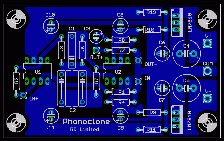

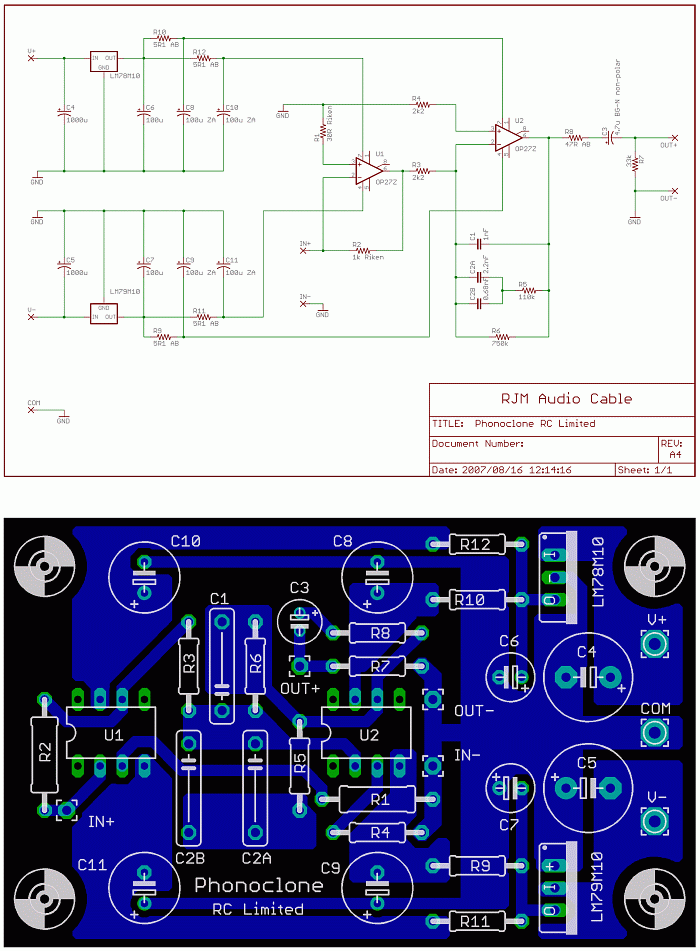

RC limited Kit : Update and Details
Time for a status report. All parts except for the board themselves and the ZA caps have been ordered. The OP27s are backordered from Digikey until Sept 20th, but since Olimex wont be open until Sept 3rd, everything is still on track for Oct 1 ship date.
Here is the detailed parts list:
Part // Description // Quantity Supplied
U1,U2 Analog Devices OP27GP 4
(socket) 8 pin gold-plated DIP socket 4
LM7810 +10 V positive fixed voltage regulator 2
LM7910 -10 V positive fixed voltage regulator 2
C1 1000 pF Cornell Dubilier mica capacitor (matched) 2
C2a 2200 / 2800 pF Cornell Dubilier mica capacitor (matched)* 2
C2b 680 / 120 pF Cornell Dubilier mica capacitor (matched)* 2
C3 4.7 uF 50 V Black Gate N non-polar electrolytic capacitor 2
C4,5 1000 uF 25 V Nichicon FW (audio) electrolytic capacitor 4
C6,7 100 uF 25 V Nichicon FW (audio) electrolytic capacitor 4
C8-11 100 uF 35 V Rubycon ZA ultra low impedance electrolytic capacitor 8
R1 30 ohm 1/4W Riken Ohm precision carbon film resistor 2
R2 1 kohm 1/4W Riken Ohm precision carbon film resistor 2
R3,R4 2.2 kohm 1/4W Takman carbon film resistor 4
R5 110 kohm 1/4W Takman carbon film resistor (matched) 2
R6 750 kohm 1/4W Takman carbon film resistor (matched) 2
R7 33 kohm 1/4W Takman carbon film resistor 2
R8 47 ohm 1/4W Allen Bradley carbon composition resistor 2
R9-12 5.1 ohm 1/4W Allen Bradley carbon composition resistor 8

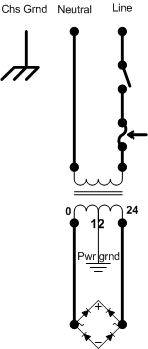

Power supply question
Hi there!
I have now built the phonoclone and I am putting together the power supply, and I just want to clarify something.
I have a power transformer with 24v out, tapped at 12v, so there are three leads - 0, 12v, 24v.
Do I connect the 0v and 24v secondary to the AC input of the rectifier and output it like so:
- out on Rectifier = -12v rail on Phonoclone PCB
+ out on Rectifier = +12v rail on Phonoclone PCB
12v (CT) tap from transformer = 0v rail on Phonoclone PCB
Is that the correct way to do it?

Eh, no expert here. but I think so.
Its easy to check though. Wire it up that way and check with a DMM before connecting it to the phonoclone. Neg lead on the CT, and you should see the + and - 12V on the 2 rectifier outputs.
Have you seen the construction guide on the phonoclone page or RJMs site?
Fran

OK!
Now I have done that, I am not getting any reading at all in volts across the + - of the rectifier in DC. To double check I desoldered the 24v AC lead and tested for AC across the secondary coil with no results.
Could it be I fried the transformer? I dont really know how easy it is to do, but I did arrange two rectifiers on the secondary coil probably in an incorrect manner (as per the "gainclone" PS instructions). Maybe that did it? Hmm.

Oh you can do it easy enough alright!!!!!
Just to double check - make sure you have mains voltage at the Tx primaries (ie that a fuse isn't gone). If you then don't have anything on the secondaries, well someting in there is fried.

As silly as it seems, make sure your reading DC after the bridge rect. and AC before..
Did you have a fuse or switch in line? Loose wire, cold solder joint on the AC supply side?
was the transformer miswired at some time when connected to the mains?
The fusible link inside may be blown due to over temperature.
Check for continuity in each of the windings.
Re: Power supply question
the dual rectifier can only be fitted to a dual secondary transformer.
The single rectifier can be fitted to either a centre tapped or dual secondary.
One can convert a dual secondary to centre tapped.
One cannot (easily) convert a centre tapped to dual secondary.

In a word; yes. The diagram Troy uploaded is also correct and clearly shows how to do it.
Just to recap the various replies:
If you have a center tapped single secondary output winding, 0-12-24V then the only option is a single full-wave bridge rectifier.
If you have two independent secondaries, 0-12 V and 0-12 V, you have the option of using two full-wave bridge rectifiers, but you can tie the windings together in series and use one bridge if you want.
The power supply diagram used to show the two-bridge version, but I recently simplified it to show a single bridge connection. I see now that I didn't include the bridge labels (~~+-) on the new diagram. I will fix that ...
Measuring transformer output voltages is a bit tricky with the supply disconnected from the circuit, since there is no load and no filter capacitors present. The most reliable check is to measure AC voltages, both at the primary and secondary (before the rectifier) windings.
