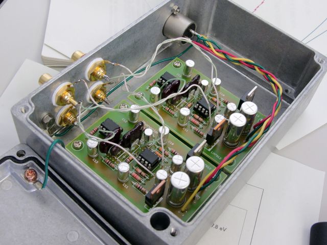

Finally got around to building the RC filtered version of the Phonoclone mini. I should have a chance to case it up this weekend and see what it sounds like.
For the record the power rails are as follows
1000uF/25V Nichicon FW
LM7x10 10V fixed regulator
100uF/25V Nichicon FW
10R
100uF/25V Rubycon ZA
(output stage OP27)
10R
(input stage OP27)
The FW are the replacement for the Nichicon Muse at the local store where I buy stuff (Digit in Nipponbashi if you must know). The ZA are ultra-low impedance types that I was given over a year ago but never got around to using as I was reluctant to stick them directly on the output of the regulator for fear of instability. Isolated by the 10R resistance as they are here it should be the ideal application.

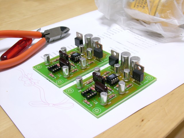

What a coincidence.

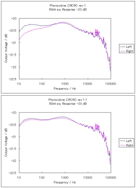

I've just finished putting the new version of the phonoclone together. I've had a chance to spend a couple of evenings listening to it now. Just like heady I noticed that a slight channel imbalance. Ive built enough of these now to identify the problem as mismatch in the RIAA eq filter rather than a difference in overall gain.
(Straight gain mismatch, say by mismatching R2, is just a direct pulling towards one speaker. An RIAA mismatch manifests as more a of a fuzzyness in the stereo image.)
In my case, I found after checking the resistors again that R6 was 741k and 771k. R5 was 112k and 113k. The mismatch in R6 translates as only a 1/4dB difference, mostly in the bass, but its an embarassing ****-up all the same: everything should have been within 0.5% or better.
I'll deal with this on the weekend, as well as hopefully have a chance to measure the frequency response and noise spectrum.

The problem was R5 and R6 were not matched. I thought they were but evidently not. R5 and R6 were 111.8k 769k left, 113.0k, 740k right. I replaced the right channel resistors with 110.5k and 763k. This change put the response back at a respectable balance between channels.
If I was sensible and used metal film resistors I could have done better still, but I still use carbon films, 5% tolerence, and they can often change 1% of their value when soldered. I dont always get exactly what I want in the package of 10, iether.
On the other hand, we are talking about less than 0.2 dB response error, and less than 0.05 dB channel mismatch. I call that pretty good.
In the data please ignore the response above 10k. Not accurate and not pretenting to be.
The gain as measured is 60 dB, with an input load was 36 ohms and output load of 15k.
Regarding noise, to be honest the FFT looks like the unfiltered versions: a little peak at 60 Hz, and a sprinkling of harmonics 10 dB or less above the noise floor up to frequencies of 1kHz. I dont think this is from the power supply directly, but rather stray pickup through the inputs somewhere. The testing environment isnt ideal and I dont think theres much point in persuing it further.
