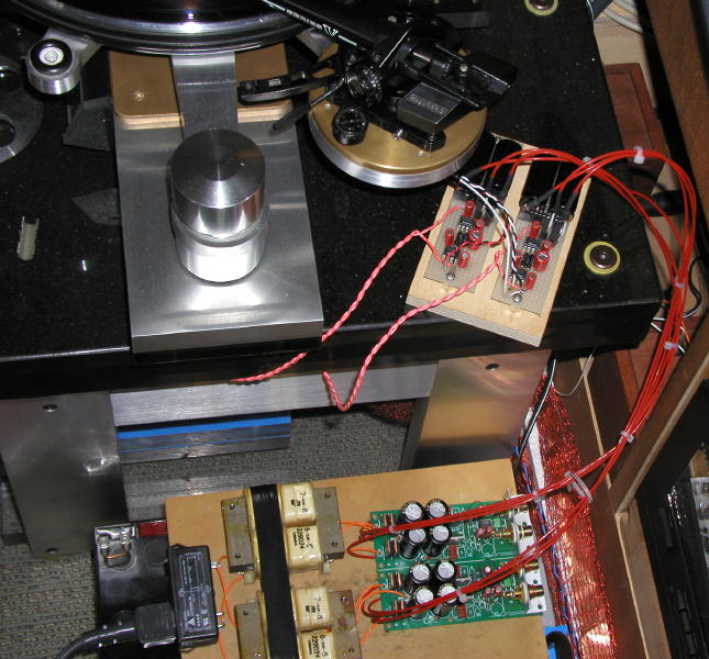

I am interested in building a phonoclone. I have an Audio Technica AT35 MC. I am not sure what the output impedance is but the recommended input impedance is 10 ohms so I suspect it is probably low, 1-3 ohms possibly. Does the phonoclone work well at these lower impedances?
9.7 ohms is perfectly workable, I suggest starting with a feedback resistor of 680 ohms, giving 36 dB in the first stage.
A reminder that you can always convert a phonoclone back into a traditional input by adding a resistor in series with the cartridge equal to the recommended cartridge load. For cartridges with recommended loads below 100 ohms and an OP27 doing this will not add significantly to the output noise.

Phonoclone & the Wright constant
Is there no need to incorporate Allen Wrights 75uS constant within the PHONOCLONE?
Or do you figure the moving coils natural (typical?) rise in the highest frequencies compensates for the unlimited 318 uS RIAA rolloff?
Also, are the feedback resistance values THAT high to make for small (in size) capacitors? Empirically, it would seem that smaller resistances might have some advantages.
Obviously, noise does not seem to be a problem with the PHONOCLONE! So, my curiousity is simply that. I guess I would rather use something other than the usual silver mica, I know there are some really good ones out there but they are not easily found. My first inclination is to use the RELCAP polystyrenes. Would you have any reservations about that?
Of course, I should build it and see for myself!

Hi Rick,
concerning op-amps, here I made some comparisons. It's a highly subjective area, though.
I tried the 'allen wright' time constant with the clone, and it sounded weird, as if I got oscillations (tired and stressed sound). But the chip was cool and I did not check with a scope back then. I did not find it so helpful with other circuits, so i did not check further.
And if you have some half-speed mastered LP's, it's worse than without...

Hi there!~
I have started building the Phonoclone, but have some questions.... 🙂
I am unable to locate OP27 op amps locally... I was wondering if a high performance op amp like LM4558 or low noise like NE5534, or an LM627would suffice? Which would be better?
Also, the caps that I got are MKT - are they OK? They look like:
What type of transformer should I use? I have two choices at Jaycar that have 12v center tap outs.
One that has 12v at 5amps
or
12v at 500mA
I can probably source others if these are no good.
I notice that on the built board example of the phonoclone, caps C8-C13 are omitted, can you tell me why?
Thanks!! 😀

You'll need to go with reliable and stable if your phonoclone is to get off the ground. Use the NE5534 if you can't source an OP27.
MKT caps are ok at this point.
I suggest going with the large 60VA transformer unless you really need a small case.
Capacitors C8-13 have two optional placement points on the PCB. I'm using the smaller "B" position for C8-11. I did choose to omit C12-C13 completely though. C8,10,12,8B,10B,12B are all equuivalent, you can populate as few or as many as you want depending on what bypassing scheme you feel is best. Same goes for C9,11 etc.
