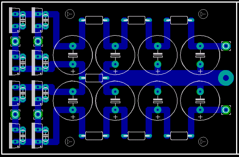

Sorry if this sounds stupid. I have read this thread from the first post to here. Read thru Richard's website. But I can't find out what the values are for the power supply caps, in the VSPS 1.7 design. These are C4 - C9.
Can anyone please post the values.
Thanks.
Thanks.
I may not have spelt it out exactly before.
For the LM3x7 regulators, you want about 330-680 uF on the input (C4,C5), 100-220 uF on the output (C6,C7), and 10-100 uF at the adj pin, (C8,C9).
I would use 480 uF / 100 uF / 100 uF.
Richard
Richard

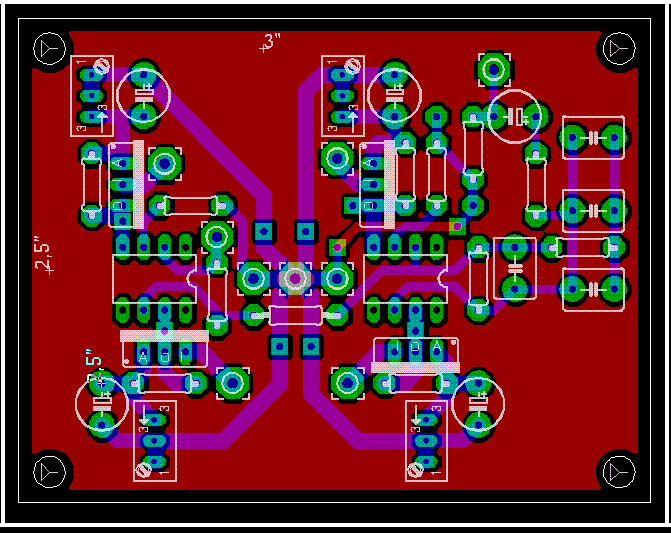

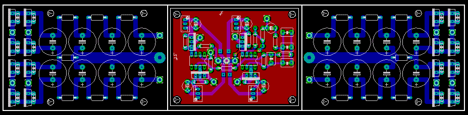

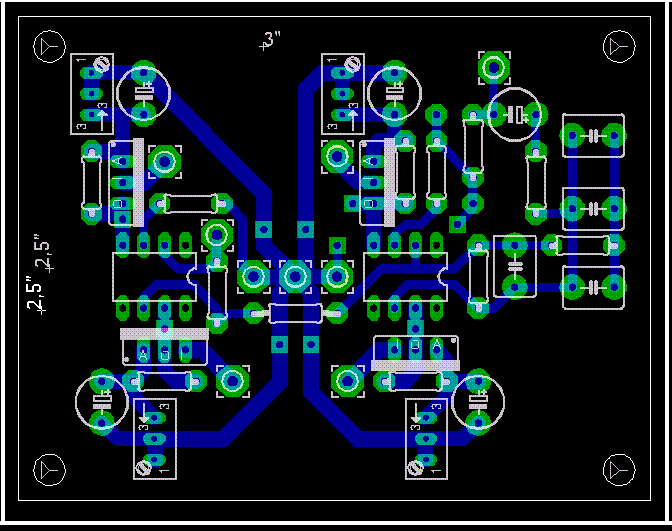

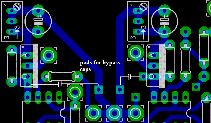

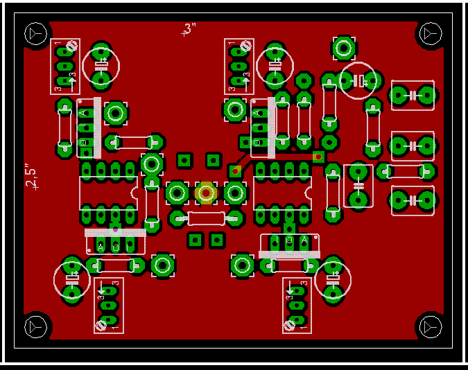

Hello.
This is may first post on this forum 🙂.
I'm going to made phonoclone pcb, and I've just made an eagle layout. And I got a question:
1.is it good or bad ?
2.should I change sth?
3.I wanted to place v-regs as close as possible of opamps - is it good idea or....not 🙂
Regards
Chris
Regards
Chris
Looks OK to me. There are no capacitors on the input or the output of the regulators though...
/rjm

I've got my phonoclone running for a week now and I am quite happy with it. Always looking for improvements, I was wondering what the consensus is about C8-10. I'm using 100uf in C10B/11B only. Has anyone tried using more capacitors? Does it effect the sound? I sometimes feel the overall sound is a little bit too harsh with voices but can't pinpoint it well enough.
Ralph
Ralph
Even after a week the components haven't fully settled in yet. The sound will mellow out further in the next 2-3 weeks.
The BE board has many possible options for the capacitors. I did not make any comparisons, but simply stuck 100 uF in each of C8b-11b and left it at that. I have 2x330uF in C4 and C5.
Also, its worth having a second look at the alignment of your cartridge. The phonoclone can reveal a poorly aligned cart much more dramatically than noisier, less resolving phono stages. That's how it was with me, anyway.
Richard
Richard
