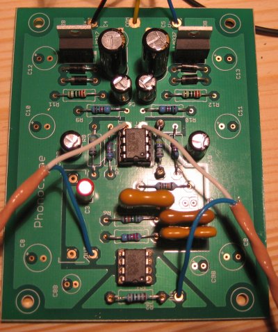

Just finished my Phonoclone on the workbench. Before I hook them up to my turntable and amplifier for testing, are there things to measure (i.e. testpoints) to indicate if I made some mistakes? If the tests are OK, I will put them in nice metal enclosures.
BTW: the holes for C1 and C2 were too small for my mica caps. Assembling the other parts went smoothly.
Ralph
Ralph

Ralph said:Before I hook them up to my turntable and amplifier for testing, are there things to measure (i.e. testpoints) to indicate if I made some mistakes?
Ralph
You should by all means check for input offset voltage. It should be 0.0mV or very close. Should you have something like 0.6Volts, don't connect a cartridge. It may (and probably will) fry.
Rüdiger
Yeah sorry about that. My mica caps didn't fit either. I had to drill out the through holes a little.
With the circuit board there is less worry about making the wrong connections, but with one probe connected to COM, test the voltages at the opamp power pins and IN+. You should see the regulated voltage at the power pins, and zero at IN+.
rjm

As I worte earlier, a far more dramatic change would be to experiment with RC stages on the Vreg output.
/R
rjm said:
Its open-ended in this regard, though I have repeatedly stressed the importance of a high quality power transformer and the minimum amount of filter capacitance.
... your guess is as good as mine.
/R
Richard I did not want to say that I was discovering somenthing special. I just wanted to report some findings.
Cukkurullo
