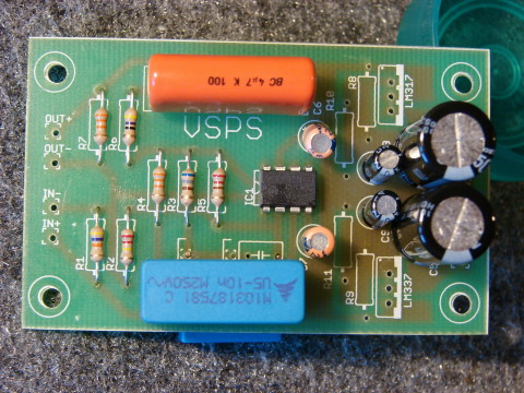

Quick question..
What is the value of R8, 9, 10, 11 on the VSPS?
I just completed all the other parts with exception of the 337 and 317 regs and associated biasing resistors.
I don't see the R8-11 resistors value on the webpage and I did a search on this thread with no luck.
I can use any transformer suggested but have 12, 15 and 21 volt handy.
Hi Troy
It depends, on what voltage you want to drive the VSPS.
When you look at the datasheet from the LM317 you find the (simplified) formula:
Vout = 1.25 * (1 + R10/R8)
Example: R8 = 120 Ohm
R10 = 1,2k
will result in 13.75VDC
As you could think, use 1% resistors or better.
About your trannies: the input DC-voltage of the LM317 should be (tumb rule) at least 4V higher than the output, giving the LM317 the "freedom" to regulate the voltage.
Your 12V trannie should work for 12VDC, the 21V trannie will result in hot regulators.
Kind regards
Franz

Not that I can't do math, but I was looking to see what the "tried and not fried" values were..
I will go with a 12vac tranny and 12VDC rails.

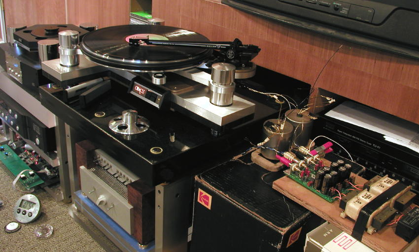

I've built recently VSPS using modified Veteran boards with all critical components connected p2p underneathe the chip. I also omitted some output resistors. The chip is OPA627, all caps BG, resistors are Caddocks, regulators LM2990/2937. It worked pretty well by itself, but it's really good with S&B TX 103 in step up (with Shelter 901).
The setup in a picture is better than CEC TL0 with modified BiDAT.
