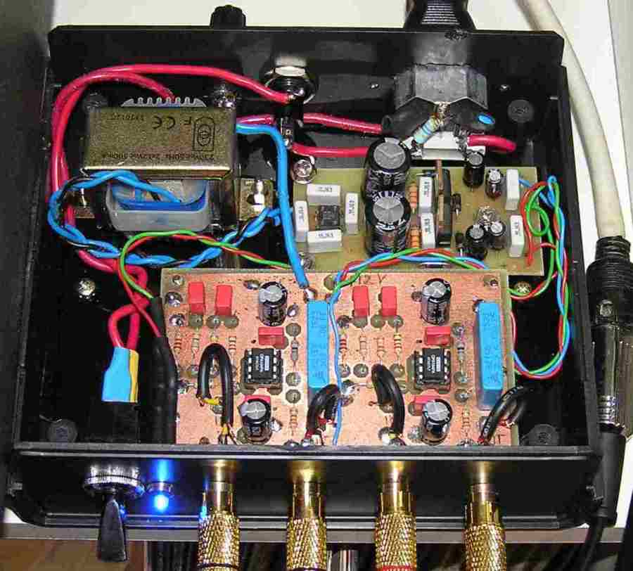

Attached picture of my VSPS, more pics are http://www.foto24.ee/album/7826. Sounds nice and building was very easy.
Thanks rjm for schematics.
pupsik46, wouldn't that standard transformer create a bucket load of eltromagnitism/noise in your phono stage?...
Maybe, I'm currently using quite noisy tube amplifier so little extra noise don't matter. Anyway I'll change this temporary PSU (7812&7912, noname electrolytics caps, polyester caps) to decent PSU (new transformer, M5230 as a vreg, low esr caps, polypropylene caps etc).stevodude said:pupsik46, wouldn't that standard transformer create a bucket load of eltromagnitism/noise in your phono stage?...
