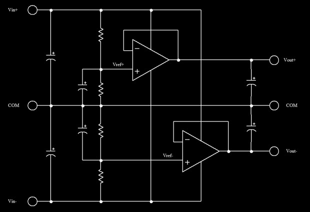

I found this today and I though it was kinda neat. I like the idea of using a follower rather than a regulator. No need for a voltage reference! Its not going to match the performance of the superreg but should be a big step up from the LM317... with some tweaking ... without very much additional complexity.

The attached circuit is a voltage follower to power a phonoclone or VSPS. It is just a design idea for now. Its simple and cheap enough that I figure its worth a "try and see" test.
The concept is to use an opamp instead of a regulator to provide a clean DC signal for the phono preamp. An amplifier to power an amplifier. Since the current draw is so low a pass transistor isnt strictly needed, especially if the opamp is a of the power variety, like an LM3875. For the VSPS or phonoclone, even the current output from an OP27 would be sufficient.
The choice of opamp is limited to something that works well as a buffer, unity gain configuration. High PSRR, low noise, and low input currents are also desirable.
The reference voltages Vref+ and Vref- are generated passively as a fraction (I would aim for 3-4 V below the input) of the input DC signal. A zener or other fixed voltage reference could be added to make the circuit a regulator rather than a follower, but I stress again there is no performance advantage in doing so.
This circuit would replace the LM317/LM337 on board. It is complete only in concept, stability issues and protection may require additional components. Use at your own risk.

Is it possible to use a high output MC like my Dynavector that have 330 ohm impedance with phonoclone or VSPS ultra?
STaffan
STaffan
It is ... possible. The high impedance automatically lowers the circuit gain. Thats ok, but the increased bandwidth on the first stage may lead to problems. The usual caveat that the impedance of the cartridge must stay constant over audio frequencies still applies.
