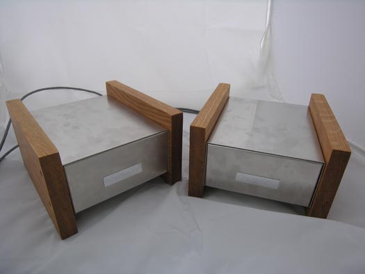

OK,
finally got to do a few pics of my completed VSPS. BTW, I changed the output jacks to insulated and it does actually make a small but noticeable difference, things like the decay of notes, ringing in drum beats etc.
As I said above, the format is a 2 box affair with transformers and rectifiaction in 1 box and then the 2 VSPS boards in the other. Boxes are simple alu boxes from maplin, side cheeks are oak. I added the labels just to set it off!
