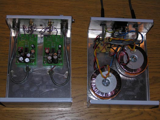

I finished my version of the phonoclone yesterday late at night.
It use the phonoclone be boards made by a 1 hour etching service near here. I have 2 transformers with 2 seperate 13vac tap each so I'm using 4 diode bridges. The casing is made of an old 10base-t network switch (cisco) with an added plexiglass front pannel painted at it's back with black spray paint. I modified the 1.5k / 220 ohms resistors combo on the regulators to a potentiometer / 220 ohms so I can adjust accuratly the voltages.
It's used with a dl-103, sme 3009 (rewired in cardas) on a modified thorens td-125. The preamplifier is based on tx-102 s&b mkIII transformers and my 4 channels amplifier based on lm3875 and line level cross-over. My speakers are 96 db efficient using fe206e on decware hdt cabinet and great heil tweeters.
At first I had problems with opamp oscillation by my fault (used opa637 at the second stage). Now I use opa27 in first stage and opa627 on the second stage. Until I resolved the oscillation problem the sound was nasty and noisy. Using the scope the problem was easy to solve.
The phonoclone is pretty silent in my configuration, the gain is just perfect to match my digital source and more than enough in my global configuration.
I made it out of cheap (not accurate) resistors but used nice polystyrenes matched capacitors in the riaa section. Now I will improve the component since I really like the result.
I have to finetune the loading (the dl-103 like high loading resistors), I want to get rid of the 4.7uf capacitors if the dc ofset is low enough and try different opamp configurations.
Thanks Richard for the design and the files you sent me !
Sylvain
Here some pictures :

You're welcome...
Okay ... but remember there is no load resistor to fine tune in the phonoclone. Also those 4.7uF Solens are doing you no favours. You can go down to 1uF remember (depending on the input Z of your line input), and find some better film types if you dont want to use electrolytics here.
-R
-R
opsssss your right, the resistor is on the + op amp input.
What kind of sound change have you get by ommiting R1 ?
I havent played with it myself, but its unlikely to make much difference. Perhaps a slight change in the texture of the background noise ...
