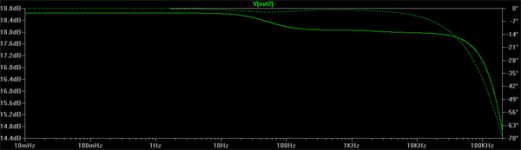

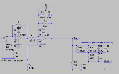

I have both build and 'sim-ed' the phonoclone. My sim shows a -0.5db 'step' down at 200Hz.
With 699k instead of 750k it's nearly flat. The other values seem spot-on. How did you measure the response, on the real thing, simulation software, or 'just' calculated?
I will try with around 700k on the real circuit, unfortunatley, I cannot measure the real thing (yet).

My sim shows a -0.5db 'step' down at 200Hz. With 699k instead of 750k it's nearly flat.
R6 (750k) does indeed control the bass response. However, decreasing the value will decrease the gain at low frequencies, not increase it. [Approximately, the gain in this region is ~ R6/R3]
Your simulation does not appear to be behaving correctly.
When I substitute 699k for 750k in my worksheet, I go from having a flat bass response (ignoring the output coupling cap for now) to having a -0.5dB step at 20 Hz not 200 Hz.
My values are R5 = 110k R6 = 750k C1 = 1.0 nF and C2 = 2.9 nF. My "simulation" is just a calculation of the gain, Z1/R3, where Z1 is the complex impedance of the network R5, R6, C1 and C2:
Z1 = 1/[1/R6 + 1/(R5+Xc(C2)) + 1/Xc(C1)]
where Xc(c) = 1/(i w c), and w = 2 p f .
I use MathCAD since with this software its easy to manipulate the complex numbers directly. The calculated gain is compared to the ideal RIAA response curve defined by the three reference time constants.
Its not the most elegant approach, but its simple and gets the job done with the minimum of fuss. The op-amp bandwidth and bass rolloff due to C3||outputZ can be added at the end if desired.
I measured various Phonoclone versions and found that they all conformed to the simulation within the error introduced by the capacitance tolerances. No dip at 200Hz was ever observed.
/Richard

The discrepancy comes from the method for generating the reference RIAA response used to compare the phonoclone's output to. I used the exact time constants to generate the RIAA curve. You've used a second passive filter at the output of your circuit to perform reverse eq. The problem is the passive filter, which is only approximately correct.
/Richard

This is true, see http://www.diyaudio.com/forums/showthread.php?postid=860056#post860056
where the plot shows the same step using that inverse network.
With a laplace transform function in ltspice the deviation is about 0.1dB max.

rjm said:The discrepancy comes from the method for generating the reference RIAA response used to compare the phonoclone's output to. I used the exact time constants to generate the RIAA curve. You've used a second passive filter at the output of your circuit to perform reverse eq. The problem is the passive filter, which is only approximately correct.
/Richard
