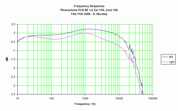

Measurements on the Phonoclone BE
I have a couple of graphs to share.
First the frequency response.
I became aware that the sound was pulling to the left, and in particular the right channel seemed dead in the treble. The measurements confirm a consistent 1/4 dB channel offset, opening up to 1/2 dB in the treble.
This corresponds, according to my simulation, to a deviation of about +5% in R2, C1 and C2 in the right channel. (I think I cooked R2 a little on soldering..)
I'm regretting not matching the components. I was in a rush and also my DMM can't really measure down to 1nF with any accuracy.
So please do your level best to match parts between channels to better than 3%.

The figure below should serve as an example of unacceptable result in terms of channel imbalance.

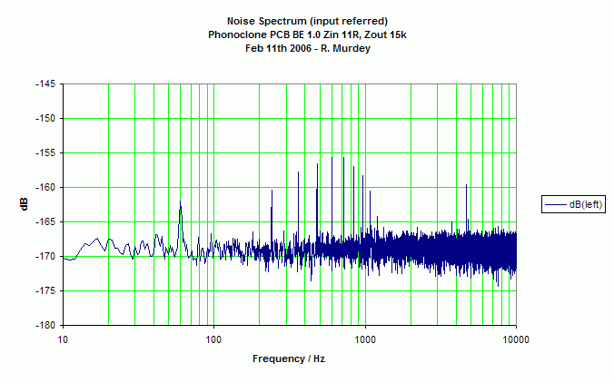

The noise spectrum confirms my listening impression: the noise baseline is defined by the OP27 voltage noise, as before, with some additional line noise spikes.
The intensities and overall distribution are very similar to what I saw with the 7812 (at 200uF effective capacitance, compared to 660uF here). In direct comparison, the LM317 shows no peak at 120 Hz but does have some 60 Hz noise. (perhaps external pick up)
To be honest I was expecting better.
It seems that the improvement of the LM317 over the 7812 is in the area of load regulation rather than ripple rejection.
To reduce the line noise below the baseline noise, one would have to increase the filter capacitance by about a factor of 3.
/R,
My balance is also shifting to one end, in my case to the right. It is hard to express but I will give it a try:
If centre = 0 degrees and fully right is +30 degrees I would describe my system as beeing at +15 degrees.
I did component selection within the 3% you mentioned with a mulitmeter, both R and C.
Two questions:
1. (Yes I Am lazy) how many dB would my right left difference be?
2. My feeling is that, not having a spectrum analyzer, the best way would be to balance by adjusting the gain of the first stage, i.e. R2. Is this the second best way (for an existing phoneclone)?
E&E
