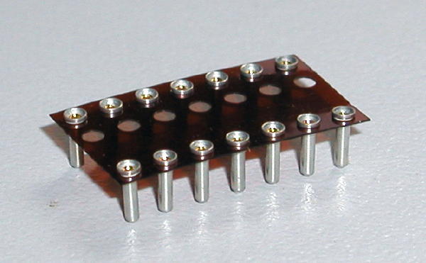

IC socket question
How much does one "lose" when using sockets?
It certainly makes sense in the prototyping stage, but is it worth it to then hardwire the IC's into place?
Are any sockets better than others?
I hope this is not too stupid a question.
Thanks for any help,
In my view, you lose nothing. The additional 2-3 pF of capacitance and whatever inductance there is in the extra 5 mm of metal is trivial at the frequencies these circuits operate at.
So do whatever makes you happiest: sockets for messing around, or unsocketed for a sense of (probably unjustified) security.

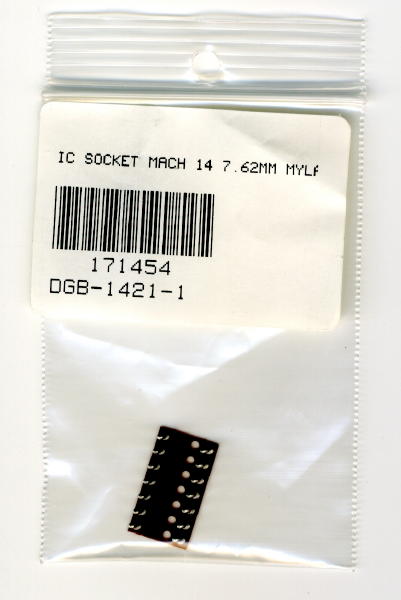

Nice looking socket
Mr. Daniel,
Who makes that socket?
I went to SAYAL and found it to be RATHER confusing. Would you be willing to say how it is designated?

I buy it directly from one of their outlet stores, I'm not sure who makes them.

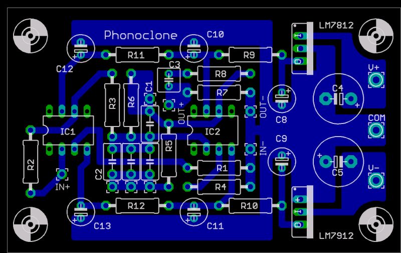

attached: Eagle brd and sch files for the phonoclone mini version 26i. I posted a similar board with RC filters and LM7x12s a while back. The most significant change is I updated my lbr files to have resistors and capacitors with wider pads and larger drill holes. In software jargon this version is RC2. Good to go, though I might have forgotton to dot an i somewhere.
/R
