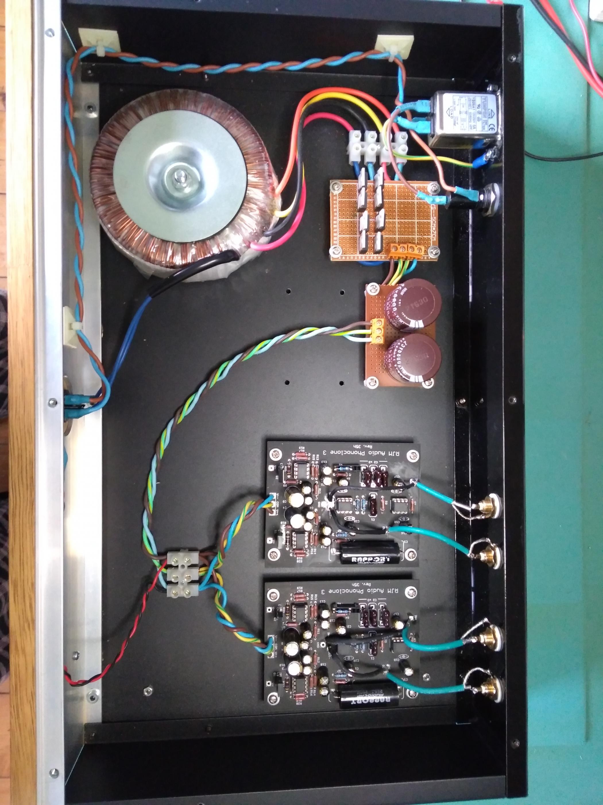

I built one of your phonoclones using just matrix board and 4 x ALW superegs for the PSU. It is totally silent and sounds quite superb. So thanks for all your work in the design. However, I was wondering what possibilities there are for improvements I read this thread My take on the phonoclone which details the use of a DC servo, alternative op-amps and class A bias. Can you point me in the direction of worthwhile mods (I started going through this thread but at 400+pages its tough going)?

I recently purchased a Rega Aria as the Apheta 2 did not like the 0Ω input impedance of the Phonoclone.
If anyone wants a set of fully populated PCB's, PM me. This is the PCB's ONLY not the case and PS.
I installed sockets for R1 when I was experimenting to get the unit working with the Apheta 2 and gain is set at 60db.

They still sounded excellent with my LP12/Ittok/Troika and RP8 - pre Apheta 2.
BTW they are much quieter than the Rega Aria, I am very disappointed that the Apheta 2 does not like them.
I'm not worried if no one wants them I'll hang onto them you never know I may change the Ahpeta 2 for something else

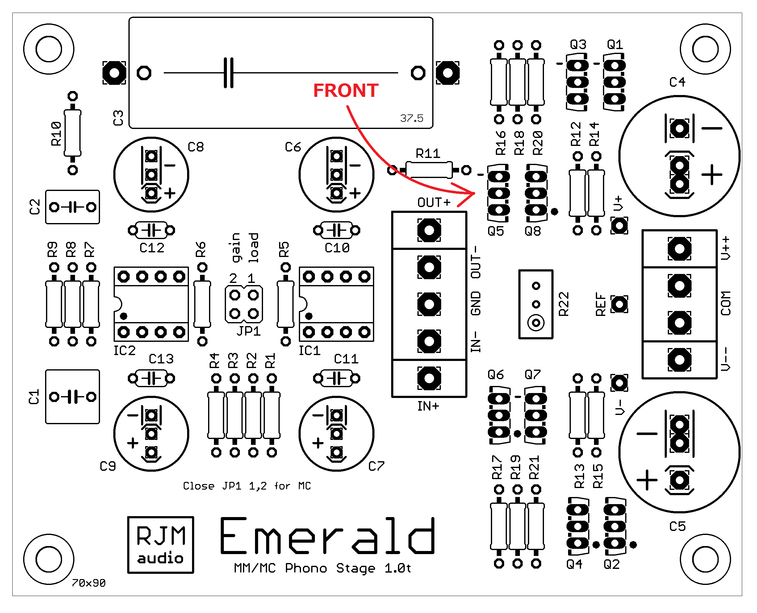

Phonoclone question:
I’m struggling with placing BD136/135. I’m looking for markings so I place them the right way round.
