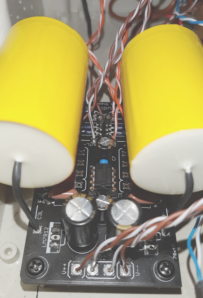

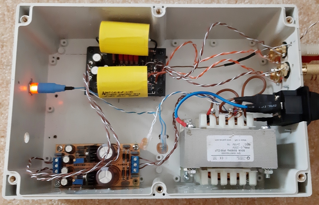

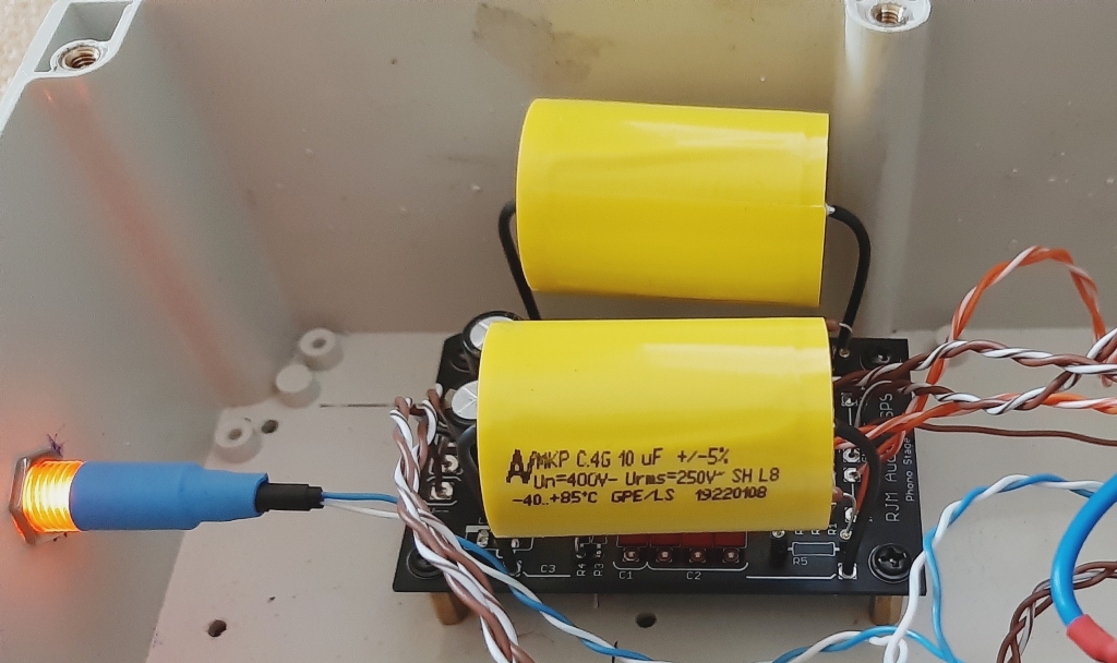

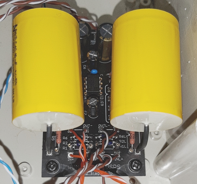

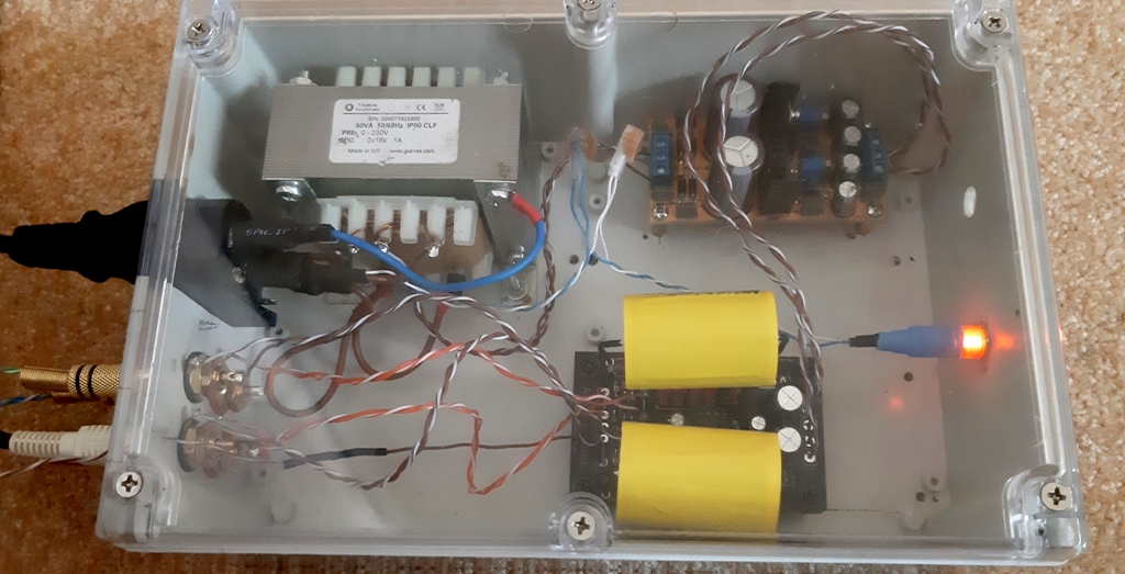

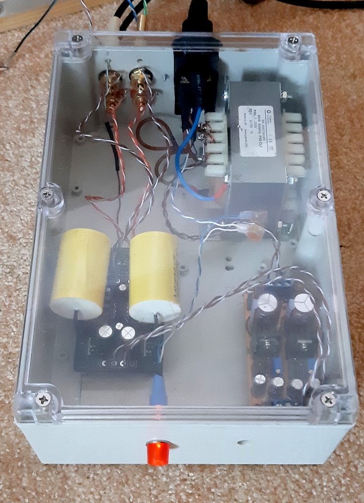

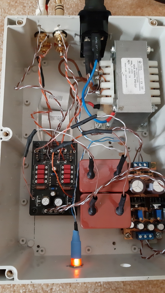

I found some time to complete the VSPS project and I am evaluating it right now. Here are some pictures of the board, together with the transformer and power supply in its box:
attachment.php
attachment.php
attachment.php
attachment.php
attachment.php
attachment.php
I've used socket pins in place of the input loading resistor and the series resistors after the opamp (using an OPA2134). It is convenient for changing parts for testing.
Also, I've used Vishay Dale resistors (CMF/RN series) instead of the KOA Speer on the BOM, since the price difference was pretty small.
I have installed all metal films but the Kamaya carbon composition is here waiting to be tested against those Dale metal films.
Will repost back on that.
For the output capacitors, right now I installed a pair of Kemet 10uF polypropylene metallized film (mouser no. 80-C4GAFUD5100AA1J). I also have a Cornell Dubilier 3.3uF pair (mouser no. 598-936C4W3P3K-F) and a few Russian PIO pairs to be tested on that position. Will report on them as well.
I am still in the process of breaking it in but my preliminary impressions with it are very positive.
I like the fact that this is a simple circuit with less stuff to worry about.
The sound I get from it is already superior to my other phono stages (against some of my integrated amplifiers/AVRs and a 2x12AX7 tube kit i've built lately).
It has a very good soundstage, that is both wide and deep.
Especially enjoying the additional layers of depth with it.
Separation of instruments is also better nd the whole sonic image feel more expansive which is always a good thing.
In terms of transients, it feels fluid and plays along effortlessly, with a very neutral tonality to my ears.
Without any IC harshness or any audible noise whatsoever.
It is dead silent, even when the unshielded input/output twisted wires are running so close to the transformer.
Nicely done Richard!
Thanks for reading and of course any recommendations from anyone would be welcome.

A few updates on my ongoing evaluation.
As I said, I'm positively impressed with the performance of VSPS.
However, contrary to my initial impressions, the 2x12AX7 phono stage might in fact have a slight sonic advantage over the VSPS with most of my 60s music (blues, jazz, soul etc).
Tubes seem to have the edge in terms of soundstage, pace/flow and decay and retain a slightly warmer tonality which I personally like.
Of course, a different combination of opamp and parts in the VSPS might change all that.
Now, regarding the Russian PIO 10μF capacitors, they do offer a sonic improvement over the Kemet 10μF metallised polypropylene film ones.
And the Kamaya 47Ω carbon composition resistors (in series after the opamp) offer a sonic improvement over the Dale metal film ones.
Basically, with both the PIO caps and the Kamaya carbon comps, I got very close to the desirable qualities of the tube phono pre, without suffering any degradations.
I want to stress that the aforementioned differences are all very small in practice.
I use recordings of the same source that are gain adjusted within 0.3dB.
Then I compare them by listening on my Sennheiser HD599 pair, through my Lehmann Linear clone amp.
I audition them by using the on-the-fly ABX comparator plugin on foobar2000.
Otherwise I'd probably be incapable of identifying any differences.
I'll keep you updated!

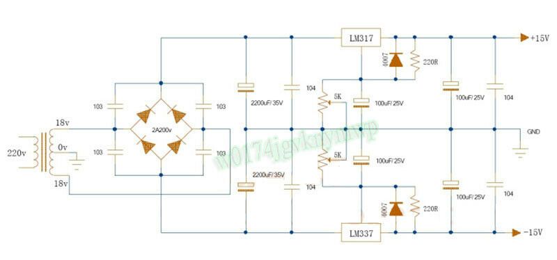

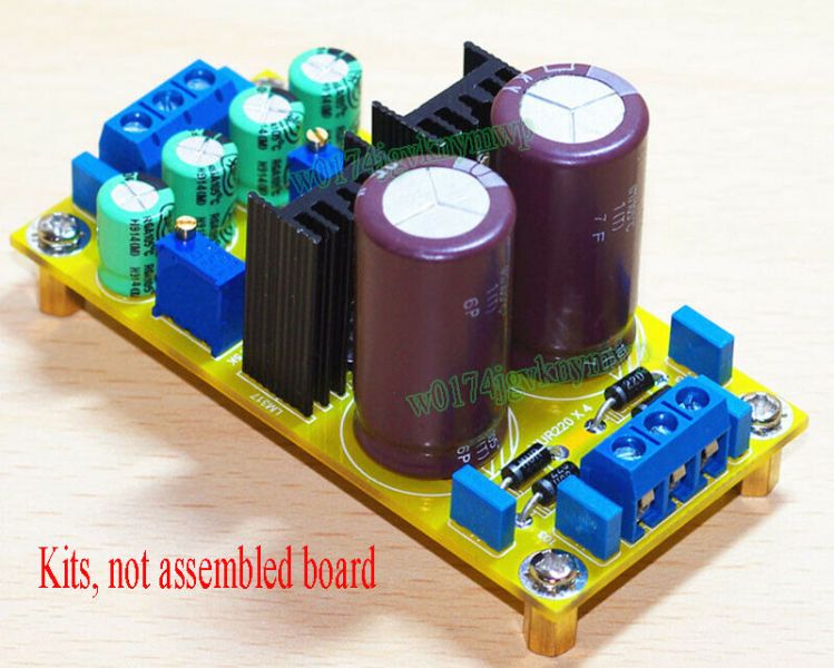

What are you using for a power supply, and what is the voltage output?
You don't actually need regulated power supply like that, the regulators on the VSPS will be enough, just connect the VSPS directly to the diode rectifier.
Richard

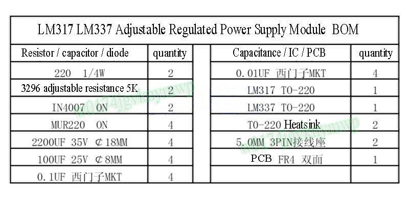

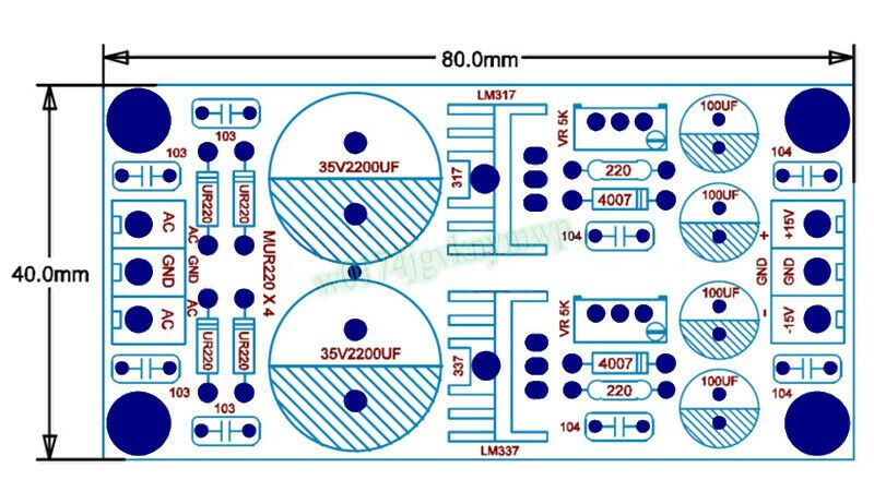

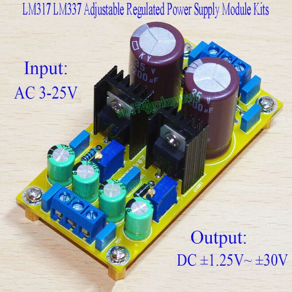

Hello Richard,
I 'm using this 'el-cheapo' LM317/337 adjustable, dual power supply, I had available:
attachment.php
attachment.php
attachment.php
attachment.php
attachment.php
I didn't have any LM7x12 regulators at hand, so I tried this kit and seems to work just fine. I have it adjusted @2x15V right now.
Do you think it is a problem?

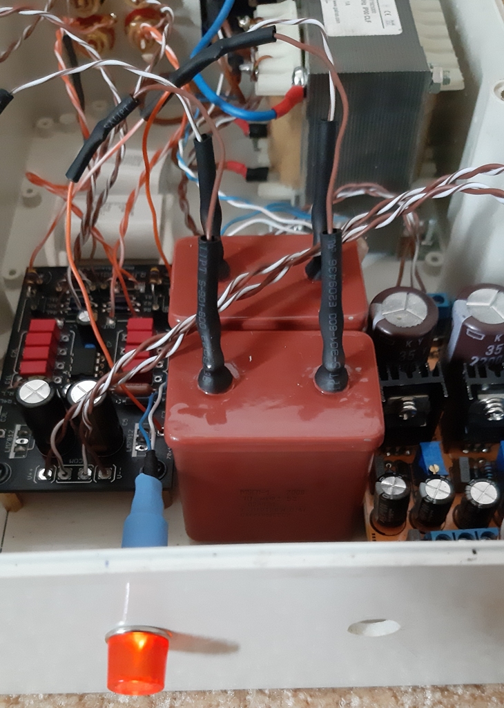

So I did some more auditioning and testing and I ended up having the Russian PIO capacitors in parallel with a pair of 3.3uF Cornell Dubilier Type 936 (mouser no. 598-936C4W3P3K-F).
attachment.php
attachment.php
This combination further improved things, adding a bit more speed and layering to the sound.
With this combination of parts, I think the VSPS have now surpassed the performance of my tube phono preamp.
If I want further improvements, I might try some different parallel capacitors or even exchange some resistors for carbon composition ones.
I was impressed at how nice they sound compared to the usual CMF/RN series metal films. Now, I can see that Richard has included them in the BOM for a reason.

Evonimos, no hum with the power transformer in the same case?
No audible hum whatsoever.
For even better results I could use a toroidal transformer, away from the signal parts, but that was what I had available at the moment.
I could see some minor interference at idle (no signal), while I was recording in Audacity and the remedy was simple.
I had to move the wires a bit and route them a bit further away from the transformer. You can see them last pictures I have attached.
These are unshielded twisted pairs as you can see and are not the prettiest things but they work fine.
If I'd use a properly shielded coaxial cable for the input/output it would totally negate any possible interference.
But I've decided decided to go with unshielded, twisted pair, single core copper wires because I've found them to improve the sound a tiny bit.
