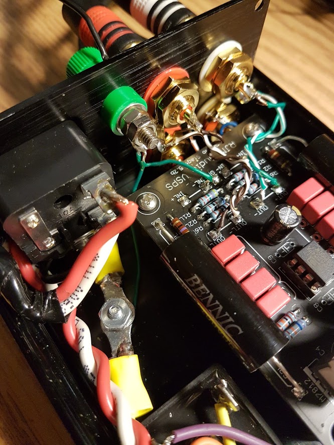

Today I finished my single-enclosure stereo VSPS, I'm pretty happy with the limited sound samples I heard from it, but its late already and serious listening will have to wait 😉
Now for the issues...
I have a rather loud humming when nothing is playing. I assumed it was a grounding issue but I played around a bit and didnt find a satisfying solution yet.
So my initial try was as follows :
- Signal ground / com was disconnected from the enclosure.
- Turntable ground is connected to VSPS ground only.
- Mains earth is connected to the case as is the transformer shield (triad medical ones) and it's mounting screw.
- No continuity between the signal and mains grounds
Second try, I connected the turntable ground to the case, which in turn grounded everything together. I did this because the hum seemed lower at first, but Im not sure I had any real gain.
It is quite crammed up in there, but I know some people are getting them silent, so Ill take any advice you have on the grounding scheme for a single enclosure unit.

I expect this is solvable. Your build is neat and tidy so I don't anticipate an error on the VSPS itself or the wiring connections but rather a grounding/layout issue.
Upfront I know from experience those cases are problematical because the black paint insulates the different sections of the case so a fully grounded case may not be realized even if one section is earthed. You need to scratch off the paint at the joins.
Second I notice the green ground lug is the isolated kind, it is not making contact with the case so a separate connection from the VSPS GND to the case is needed.
What is currently connected to the case at the bolt to the left of the VSPS board? It should be the AC earth safety and the board GND and the transofrmer sheild. You can defeat the safety earth to see if that makes a difference to the hum. The case must connect to GND pad of the VSPS board, as well as the green TT earth connection.
I'll leave it there for now. If you can check it's 60 Hz hum not 120 Hz ripple, you can confirm its not a problem with the power supply or voltage regulatyors. The other concern is the proximity of the audio signal lines to the raw AC voltage.

Hi Richard, thanks for answering, my comments are below.
So what I did is I ran another small ground wire from the green lug to the chassis screw where the safety and shield are (See attached picture), but I still get some hum.
So now the GND from the VSPS runs from the board to the green lug, then to the chassis screw. Would it be better if I ran 1 wire straight from the board to the chassis screw and 1 wire straight from the green lug to the chassis screw?
I found that information in the thread so it was already scratched and I confirmed the continuity all around the case
You are right it is insulated, in this picture nothing links the VSPS to the case
Yes that bolt has the safety earth, and the transformer shield.
I'll leave it there for now. If you can check it's 60 Hz hum not 120 Hz ripple, you can confirm its not a problem with the power supply or voltage regulators.
To my ear it would be 60hz hum, I will try to borrow a scope to confirm it.

If tying the ground lug to chassis didn't fix the hum, I suspect induced hum from the proximity of the transformer and AC wires to the signal board. Ideal is to separate the transformer and at least bridge/diodes into a different chassis. Remember, there's a pretty big signal step-up in any phono stage, so even a small induced hum can result in a pretty loud hum at the output. If you have a way to install a shield around the signal board, that might help, but it looks like that would be a difficult task.
Edit: If using a single chassis, I'd highly recommend a much bigger one with more separation.

I see that your IEC plug is next to the PCB.
I would say, and I'm speaking from a lot of experience in building Richard's amps, that the VERY close proximity of the input signal wires to the mains input socket and the mains run to the transformer most will DEFINATELY cause audible mains frequency hum.Hi Richard and others,

So if you want to use such a small enclosure the solution would be to use a second one to house the transformer and bridge rectifiers - as advocated by Richard.
Oh, and uninsulated solder lugs on the mains input socket are potentially lethal!
Good luck!
Before starting rebuilding enclosure, you can try some more ground tricks:
First, remove short green wire between board and green lug.
I don't know, have you connection between board and enclosure elsewhere. You can measure continuity between PCB ground and chassis screw(after removing short green wire). If there is no continuity, put wire between white wire on bridges and chassis screw.
After thees mods, you can experimenting with connecting or not connecting ground wire to green lug, even disconnecting ground from input socket to PCB in one or both canals.
For the mechanical layout, some easy things to do:
release transformer bolt and try rotate transformer in one and other direction, try to find position with less hum. Sometime it helps a little.
maybe you can rotate mains input socket by180 degree, so mains wires are not too close to PCB

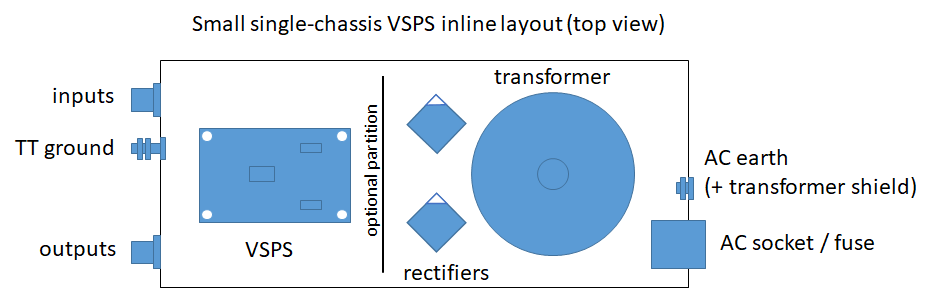

I think Carlp is on the right track when he said that since connecting the case to the circuit common didn't fix the hum the problem is most likely inductive pickup from the AC part of the power supply. The fact that the hum level is relatively low backs up that conjecture. As Carl points out, the basic issue is your case is too small.
The best way to test that hypothesis is to temporarily remove the power supply bits from the case, and feed the rectifier output back through the hole where the IEC socket used to be.
However, before you go do that I recommend disconnecting the safety earth at the IEC socket (or with a power cord with only two prongs) and see if that makes a difference.
Here's my recommended layout for a small single chassis build. It looks a little bit like a power brick, designed to be placed behind the turntable or otherwise out of sight as there is no "faceplate" as such.
Note that any noise from the charging currents will be 120 Hz (double the line freq.) So if you only hear 60 Hz you can say the diodes and secondary windings are not the cause and it is most likely straight up noise pickup off the AC wires or primary transformer winding. Note also that by far the most sensitive area of the VSPS is the input signal from the RCA jacks to the op amp input pins.
You want to keep AC as far away from that point as possible.

So the star ground didnt change anything but gave me a chance to test without the board grounded to the enclosure (same as first picture) and it was indeed way louder hum.
Now I'm back to "normal" hum.
Per Richard's advice I tried a 2 prong cable and the hum got even lower, I nearly loose it in my test amplifier noise.
I did the 2 prong test before, but that was when the case wasnt properly grounded. So now.. what do I make of this? Running without safety would be quite bad wouldn't it?
Also something just hit me, that Technics amplifier and turntable I have on my bench dont have any safety earth... would that possibly worsen my situation? I didnt want to test on my main system just yet.
Thanks again for all the help.
Ps: yes the layout richard posted wouldve been a whole lot better but I wanted something nice looking.... I will probably order another case at some point.
Oh I forgot to mention. When the case isnt safety earth grounded and I touch it, I can hear variations in the hum. Same if I touch the amplifier case.
I wouldn't run the amp with the safety ground disconnected. That's just for a test. So it seems like there may indeed be a ground loop, but there's also likely induced hum. I'm out of ideas for now, but heed RJM's advice as he's far more knowledgeable about this than I.
For the induced hum, I would certainly change the input/output cables to something shielded.
I always prefer single copper core twisted wires for audio purposes, but when noise creeps in I have to use shielded ones.
For that situation I'd usually employ the use of an RG58 coaxial or for tighter spaces like yours something thinner, like RG178 or RG318.
It is, most likely, both. I'm trying to make the most out of a non-ideal situation to see just how viable it is.
Would shielded input cables really change anything on such short lengths assuming I leave them so close to the AC mains? If so, where should I connect the shield? RCA negative?
The PCB traces must be picking up even more noise than a few inches of wire anyway right?
