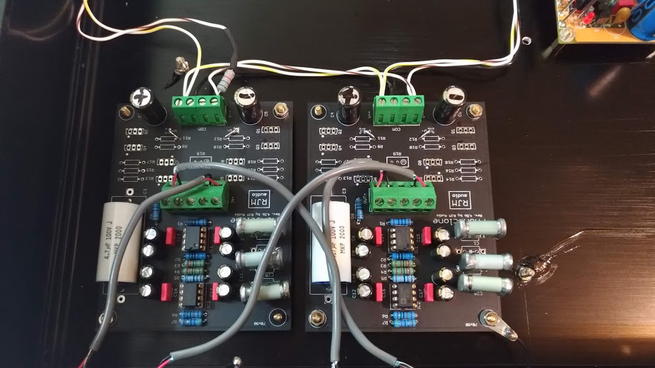

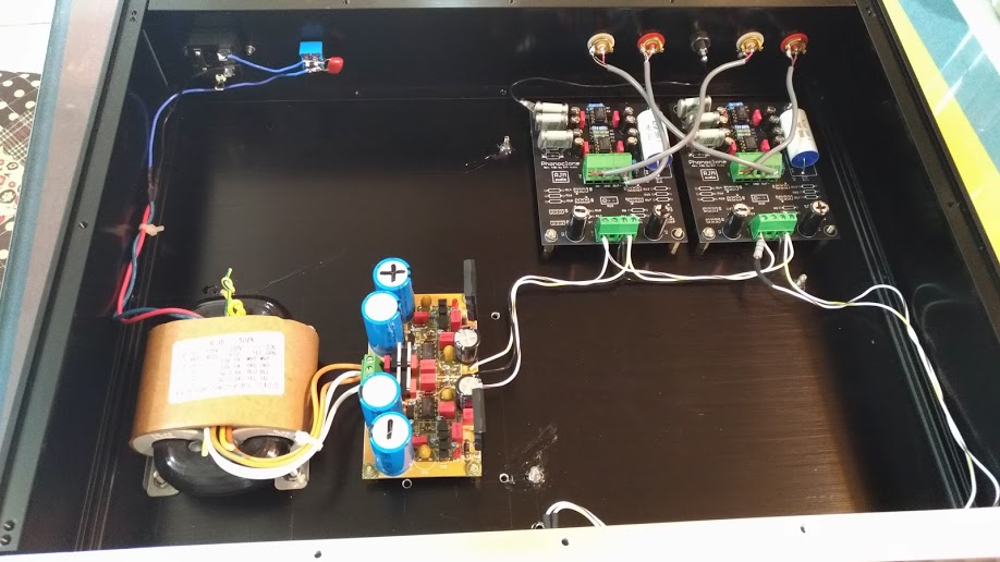

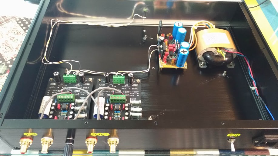

Wires are spaced away from each other both horizontally and vertically. Worked far better than anticipated. Case is 11" x 9" x 2 1/4".
Neverless it is good practice to twist the positive and return wires together to minimize inductive noise pickup.
Plastic or metal (brass) standoffs all around?
I dont believe ground plane is touching. So no ground loops?!
The mounting holes are isolated from the ground plane / circuti common - a deliberate decision - so the standoffs can be metal or not it doesn't matter. The boards are connected to the chassis explicitly via the GND pad.
Sure. I mean a virtual ground is never as good as the real thing, but it should work just fine all the same.

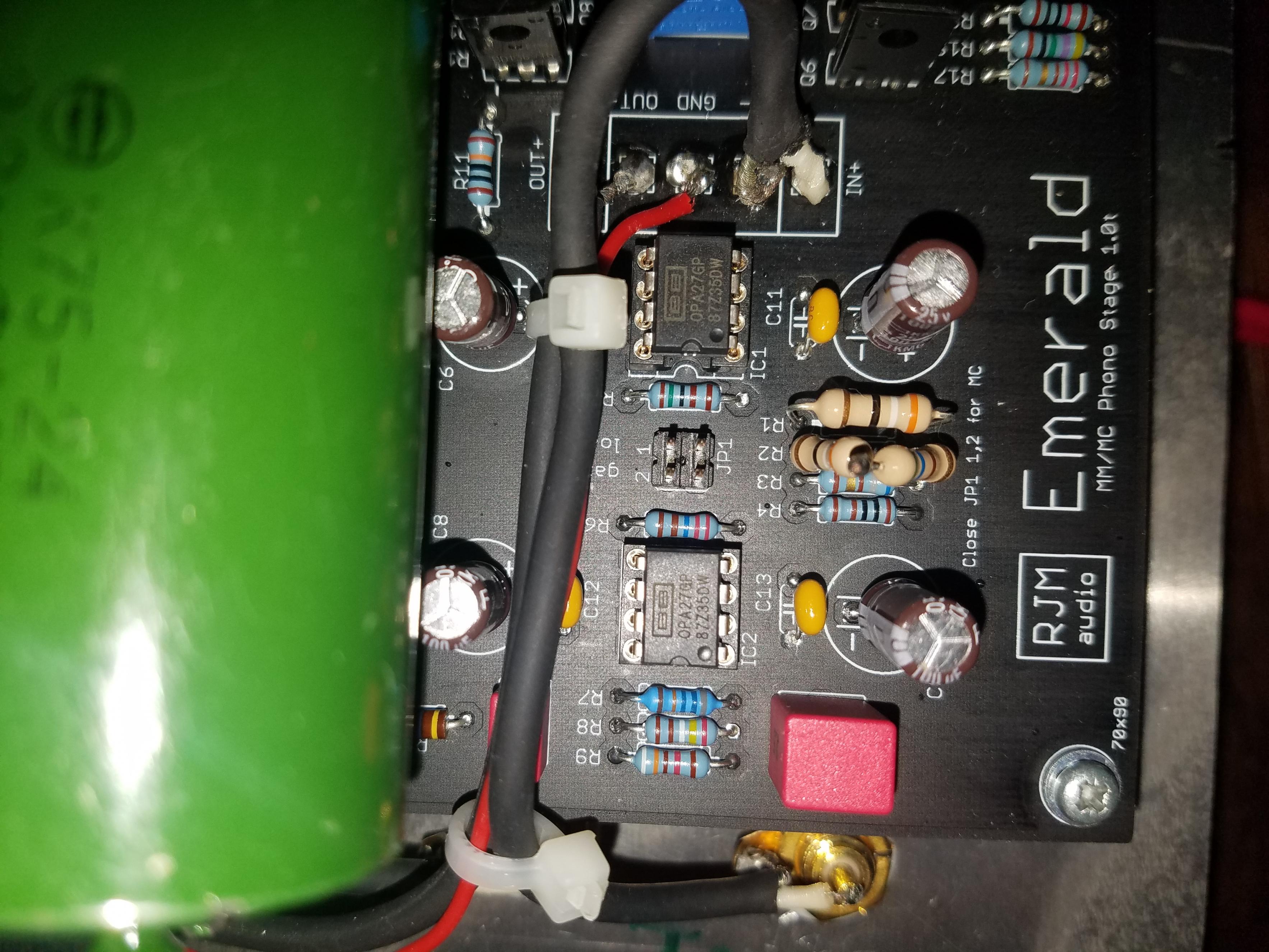

First, I like to say thank you to Richard for providing me such a good phono stage. I have tried to build MC phono stage several times but never succeeded. However, at this time I can say that this project was successfully completed- "NO HUM" at all so far.
I received the boards from Richard in the beginning of May, and ordered all necessary parts. I did not use all day for this project but worked two hours pretty much everyday for two weeks and finally put them all together.
Richard advised me to use R1/ 40 ohms and R2/ 600 ohms for DL 103. I am sure that these values should be good for DL 103 but I have a Marantz 7C clone with MM phono stage, that I connected Emerald to phono inputs on Marantz 7C.
The results of adding Marantz 7C between Emerald and power Amp was obviously distorted sound, bass was too boomy/muddy. so, I had to open JP1 to reduce gain to 40dB. The sound was much better than closing JP1. Bass was very rich and full, mid range sound is OK but definitely need more on high frequency sounds.
SO, Please can anyone advise me?
1. Do I need to leave open JP1 and changes the values of R1 and R2?
2. Do I need to close JP1 and changes the values of R1 and R2?
3. Is there any way to increase treble sounds?

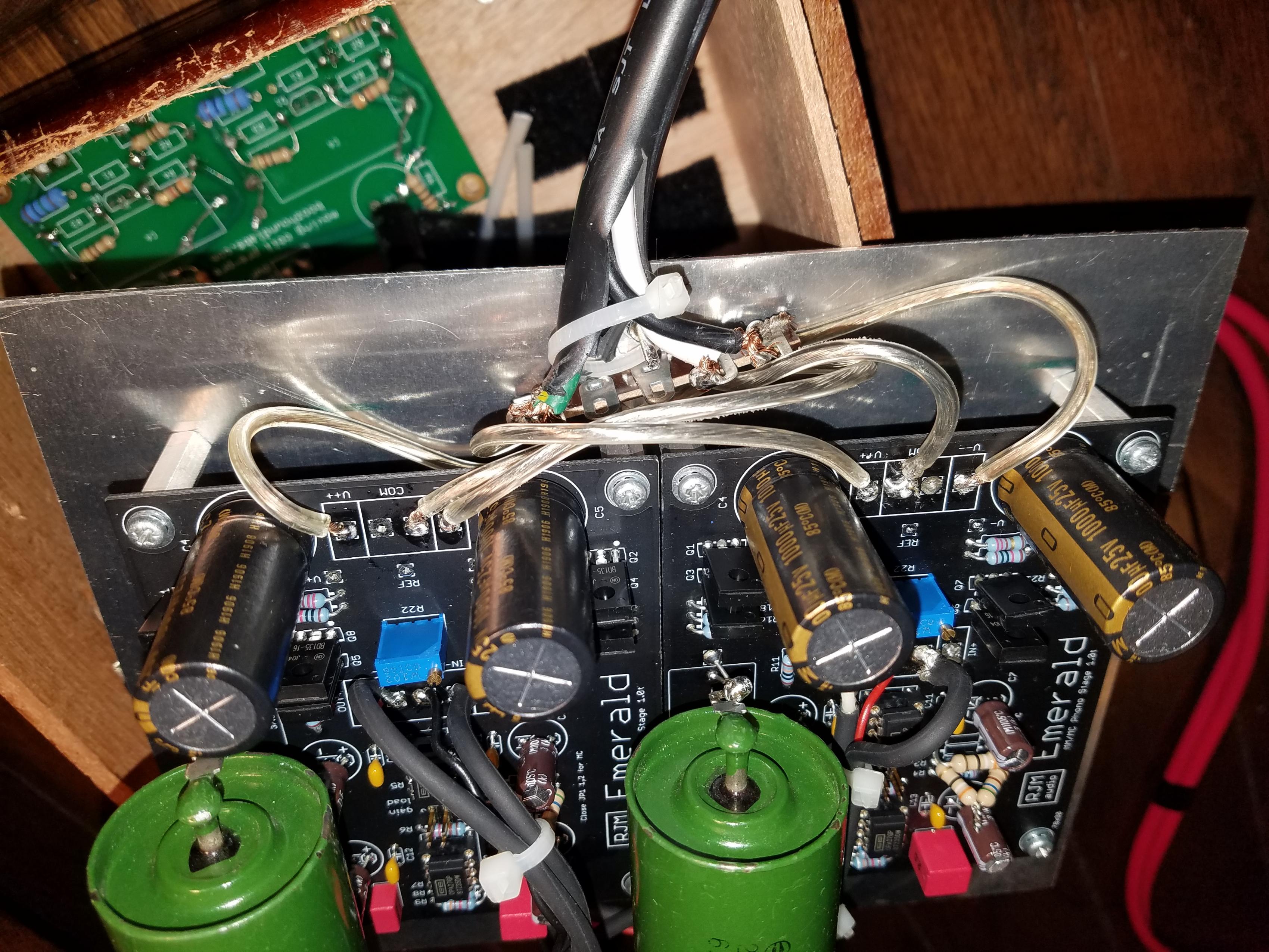

hunsoop, excuse me intrude.
But allow me some points.
You say that you've connected Emerald to a phono input from Marantz c7 ?.
It will distort because you have increased the signal with Emerald and apart you have equalized it by increasing the bass and diminished the treble. This again happens in the phono stage of the Marantz c7.
The other thing I suggest is that you put insulation at least in high voltage welding, it is dangerous.
Finally, I see at least one channel of the Emerald that you have connected the ground of the cable in signal out and in earth of the plate you have connected signal of exit of the cable.

thank you for the thought! I directly connected Emerald to Power Amp. It sounds much better. But, bass has been diminished and more treble.
@hunsoop
Reviewing our previous email correspondence, I see that originally you asked about the Phonoclone, then on my suggestion you ordered the Emerald boards. My apologies, when you asked about the DL103 I was still thinking about the Phonoclone and gave you the answer for that circuit rather than the Emerald.
1. When using the DL103 with the Emerald, please use the usual BOM values of R1 47.5k and R2 100R.
2. When using the Emerald with the Marantz preamp, connect the phono stage to the line input, not the phono input. The phono input is for the accepting the phono cartridge output directly.
3. The main problem I see with your build is the jumpers of JP1 are both open. This is the MM position. For the DL103, both jumpers must be closed. Add the shorting jumper (mouser 517-952-10) across both sets of pins.
Those three points must be addressed to get your Emerald working properly.

thank you Richard.
"Those three points must be addressed to get your Emerald working properly."
yes I did it_

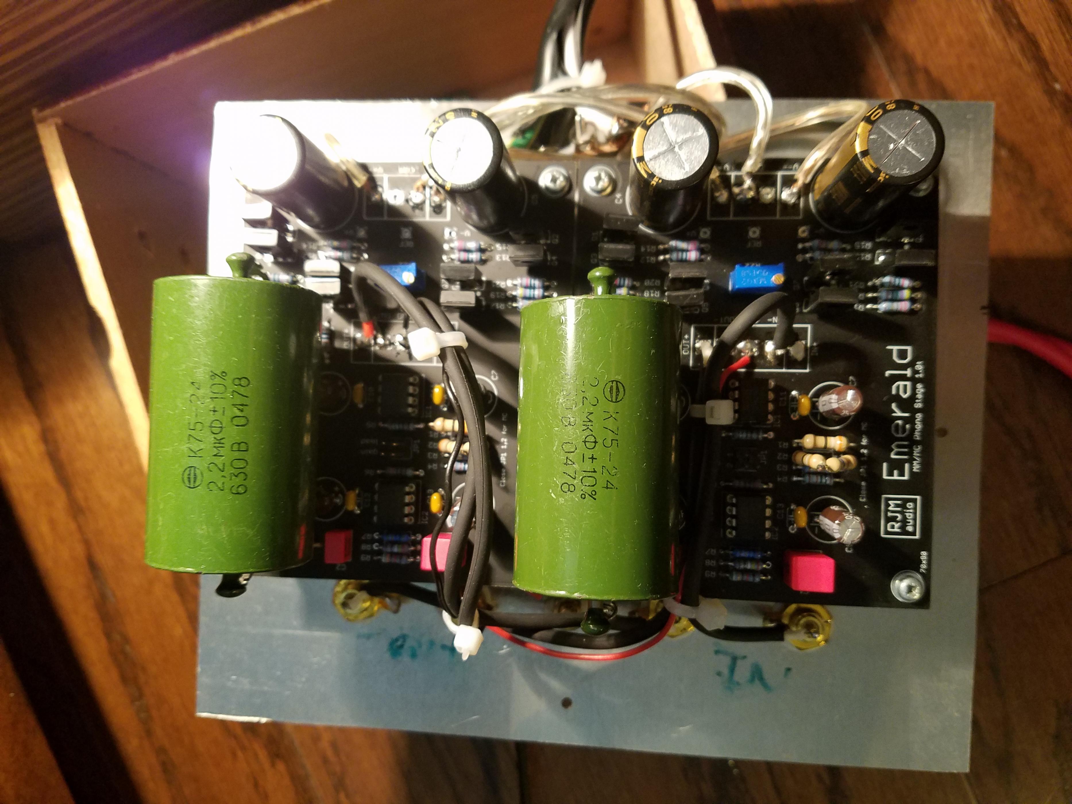

i followed all your directions 1-3 and i am very impressed the sounds, treble was very detailed and bass was enough to enjoy. this is my first time to use MC cartridge DL 103 and I am very happy with the outcome.
my next plan is to upgrade 2.2uf capacitor - currently i have K75-10 2,.2uf 500v and the review was not bad and price was very reasonable on Ebay.
Do I need to spend more money on coupling Capacitor? please let me know your thoughts.

The caps look like some old Russian military surplus. You can easily switch out and try a few different ones to see if you can find one you like better.
I'd recommend Mundorf maybe to start. That's a solid, weighty-sounding cap.

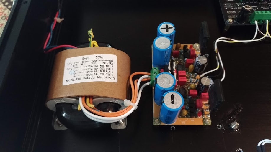

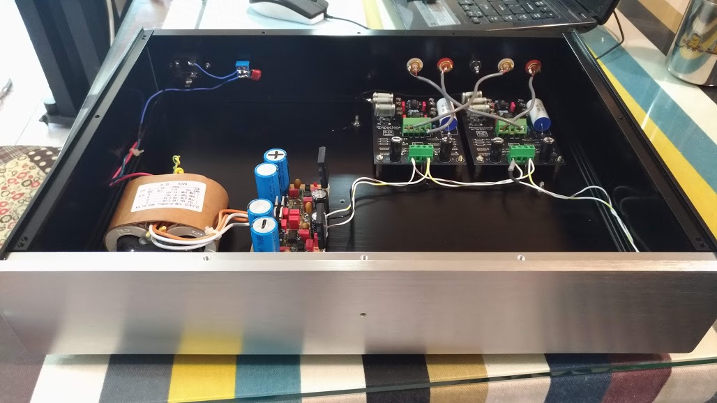

Looks gorgeous! Nice transformer too.
I like the foolproof marking of the power rails polarity on top of the caps!!
