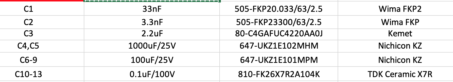

I have start building the PCBs.
My original Mouser order didnt have all the Caps so Ill make an order from hificollective.
C3 is the crucial one (from the build info) but I wanted to ask if others used different ones.
1) So my question is: which 2.2u should I choose from hificollective?
2) Any other alternatives from the remaining?

Realistically, there are any number of good options for C3. The value can be 1-3.3 uF, 2.2 uF is just a center point estimate, and there are no particular restrictions for voltage. So it comes down to taste, size, and price. Suggest looking at Mundorf or Audyn.
KZ (Muse) are pretty good, debating which is better, them or Silmic, seems rather futile in my opinion. It doesn't matter.
I would use the BOM parts for C1, C2 simply because the Wima models fit nicely on the boards.

Yes the Wima are good and fit. I Can find the Silmic in stock at the moment so Ill go with that and check the 2 C3 brands that you said.

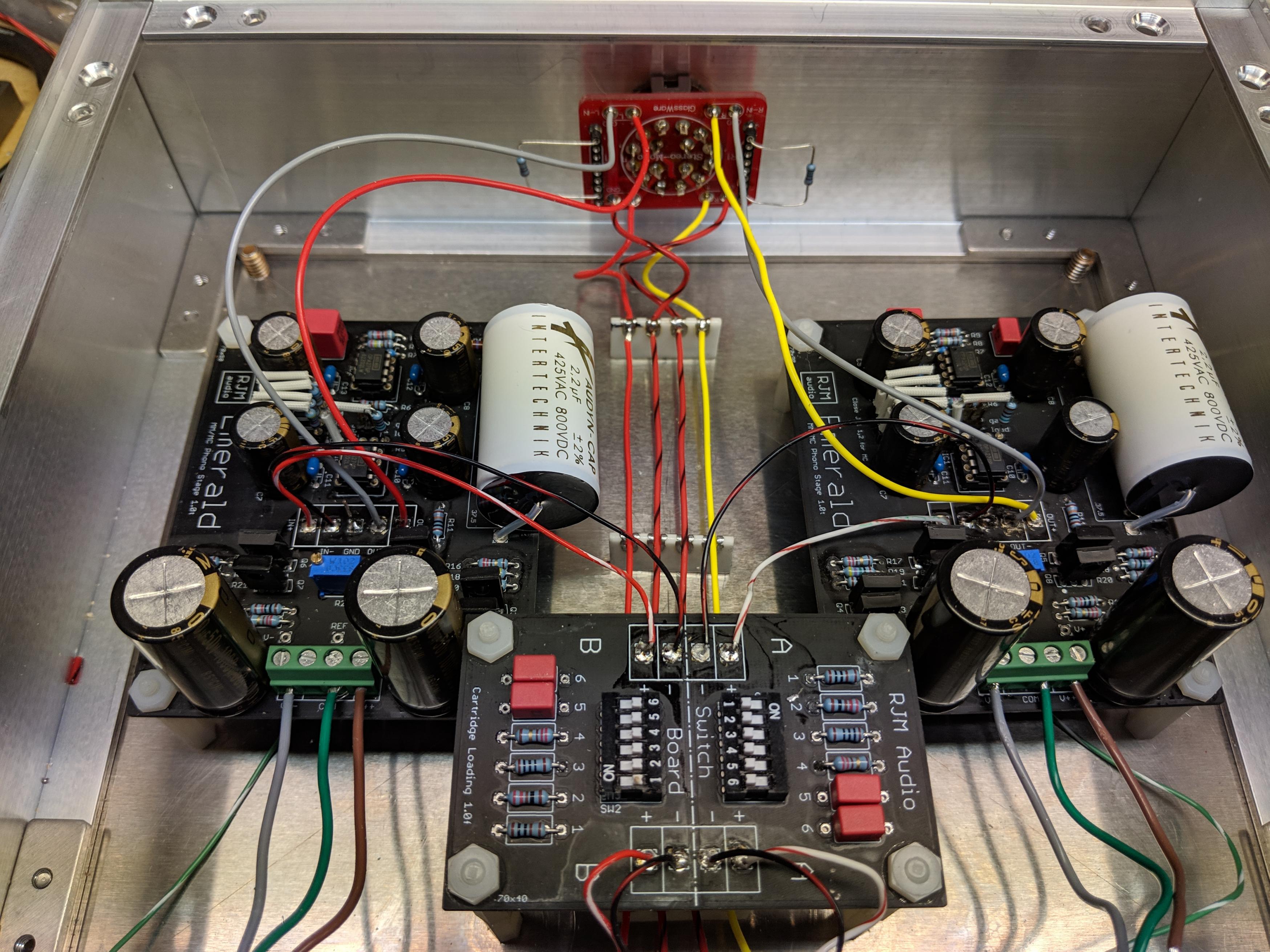

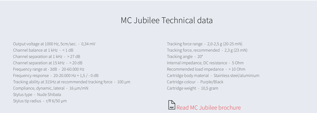

I'm getting ready to build the Emerald phono stage with the Switchboard in front. I am struggling with the whole load concept and how to adjust it on the Emerald.
The Ortofon Jubilee and the more recent Cadenza line of cartridges I like are supposed to be loaded at >10 ohms and I have found that 100 ohms sound good to me. This is using a K&K Maxxed-Out phono stage.
I am not sure how to set this value (or make it adjustable) on the Emerald which seems to b have an intrinsic load of 47K.
Also, I can't seem to get the Excel calculator to work. I can't seem to find where to input the specs.
Sorry for the newbie questions but help would be appreciated.
Thanks in advance

To use the Switchboard, set the Emerald load jumper open so the load is 47kohms. The Switchboard optionally introduces resistance and capacitance values in parallel to that 47 kohms. The Switchboard in the default BOM gives 1k, 221, 100, 68 and 22.1 ohms, as well as +100pF or +200pF by setting the DIP switches as follows,
(1-4 all OFF) - 47 kohms.
1 ON | 1k
2 ON | 221 ohms
3 ON | 100 ohms
2 and 3 ON | 68 ohms
4 ON | 22.1 ohms
(5-6 both OFF) | 0 pF (+ cable)
5 ON | 100 pF (+ cable)
5 and 6 ON | 200 pF (+ cable)
The data entry fields in the Emerald "Worksheet" are the bold, red numbers next to R1~5. If you change those resistances, the gain and load values change as shown to the right of the input fields. The numbers lower down that page give various examples, but are not calculations and have no user input.
(PS There is no calculator like there is for the Phonoclone. The "cartridge gain" sheet in the BOM gives a list of suggested gain settings for the cartridge sensitivity. There is no user input, just look up your cartridge sensitivity in the list and read off the gain. Your cart is 0.34 mV so the standard Emerald BOM "MC" setting will be fine as is, or you can use option"C" for R3,4 shown in the worksheet.)

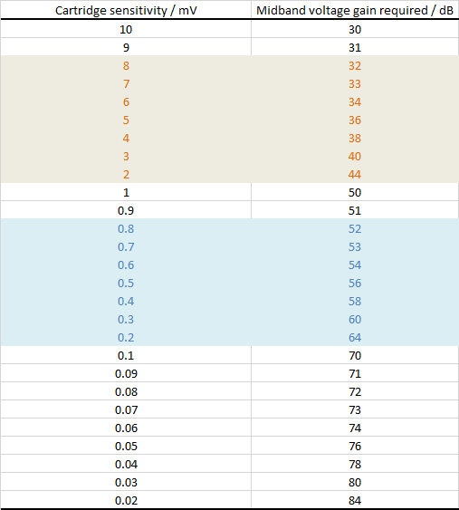

The default BOM is for the 39db gain (MM) it seems, btw some areas in the excel say 37 but I believe its not updated.
Is it ok if we give a bit more gain than the cart needs?
For example: Is there a design limitation that there isn't enough voltage swing and clips if you add a couple more db than the cart specs? so in essence have a bit stronger output. (Amp input will happily take it).

While headroom is difficult to quantify with any kind of precision, increasing the gain up to 6 dB above the recommended value given in the table below is unlikely to give serious problems with the performance of the the Emerald circuit.

Ill probably do the default for now (Ive got the parts) and see if I need something like 3 db later.

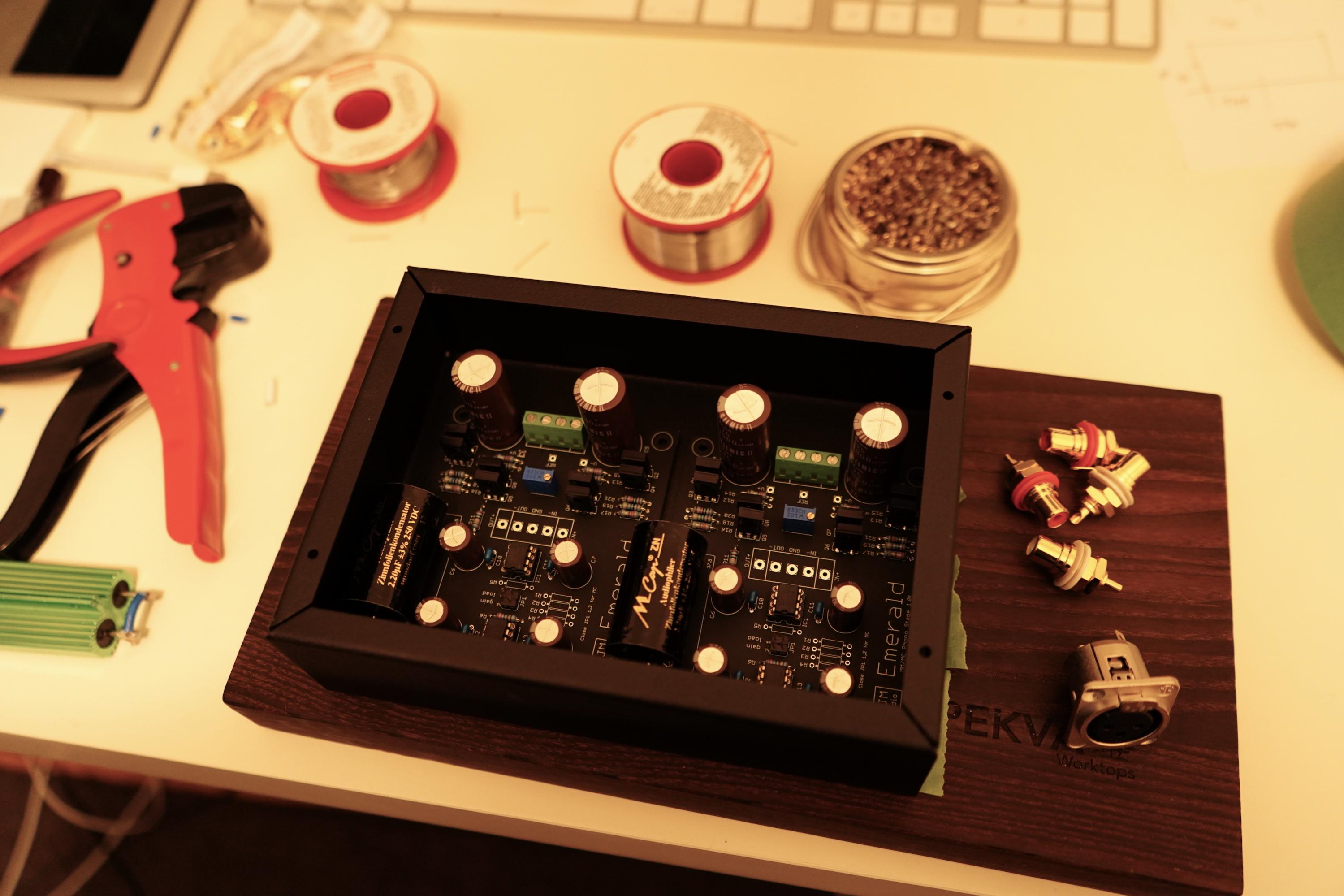

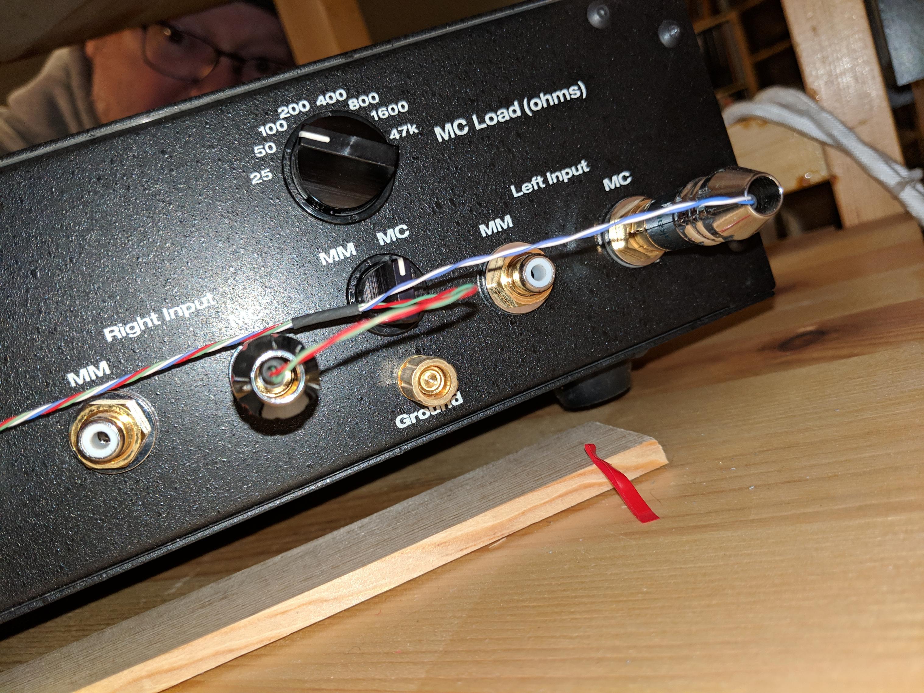

Hi all,
Im half way there (drilling and finalising is at least the 50% 😛 )
A couple of questions:
Can I put all inputs, outputs and power XLR all at the back?
XLR in the middle (lower than mid horizon) and in/out left and right.
As you can see my box is a bit tight and I pushed the boards towards the front to leave space at the back.
Will I get interference?

@daemonsgr
Your case is too small. Even if you get it all hooked up and working, it will cause you much pain and grief. Trust me. Been there, done that.
What I recommend though is to mount the XLR and RCA on the side face of the case as you have it pictured, rather than the back. The XLR goes on near the filter caps, the input RCA furthest away, and the output RCA next to the input, with the ground lug about middle.

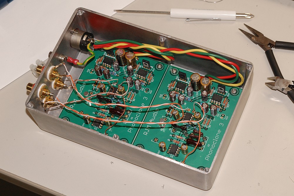

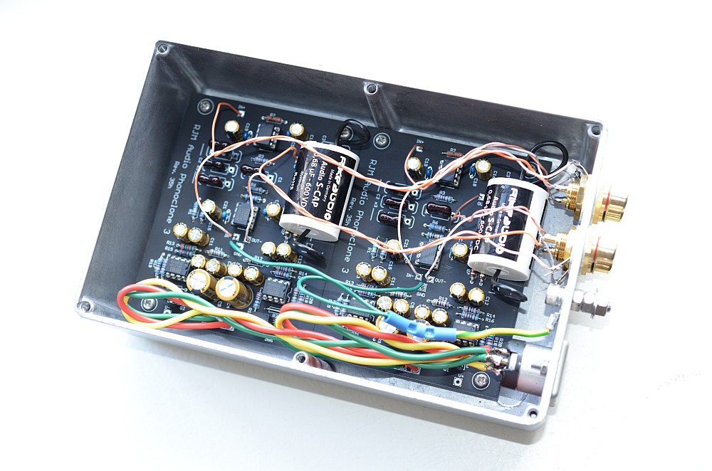

See attached photos for various photos of builds in my bad old days before I started using reasonable sized cases.
The important point is to route the input wires well away from anything resembling unregulated power, while keeping the input wires as short as possible.

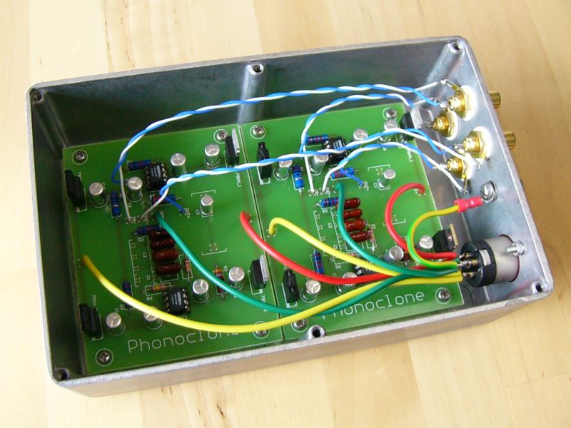

I have to agree with Richard. Your case seems way too small. Not that you can't cram all the stuff in there but you are making it tough to keep stray signals from influencing desired signals.
My last build with no wire twisting or extra shielding is as quiet as can be. Wires are spaced away from each other both horizontally and vertically. Worked far better than anticipated. Case is 11" x 9" x 2 1/4".
