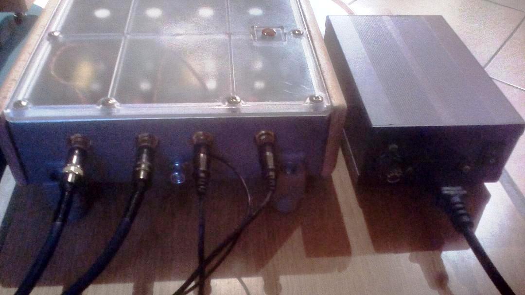

1) I want to build the PSU on its own box. Should the power switch be only on the 240V side? or another one on the preamp side?

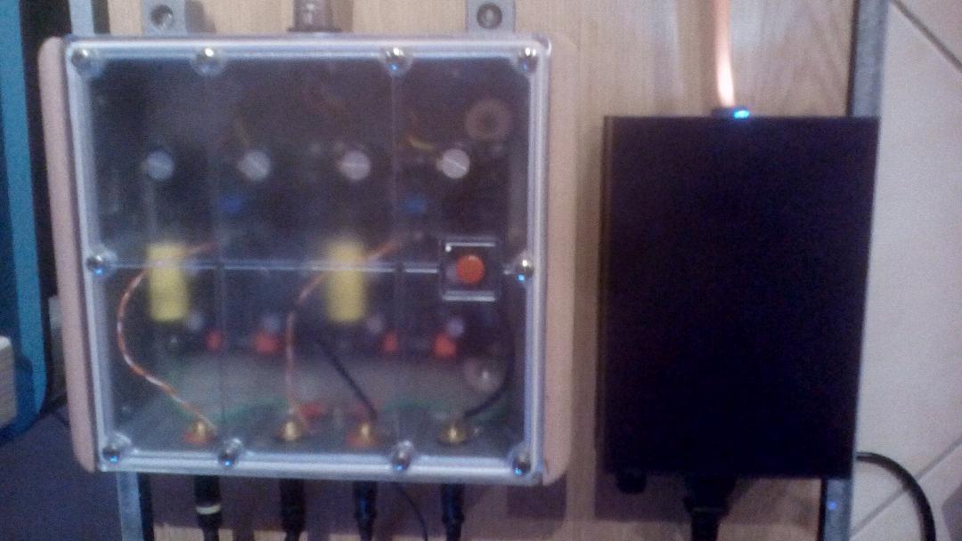

2) I had a bit a silly idea (as the black pcb etc looks cool). Will an open air setup work? Like a metal plate with the pcb and the RCA/XLR looking up? like a "open casket tube amp".
With some cool wire colouring etc it can be quite cool.
Is it better if the pre-amp is completely enclosed with metal? or open is ok? (RFI etc)
1) Just switch the AC (240 VAC line), not the DC output.
2) Keep the circuit boards surrounded by a full conductive metal enclosure, connected to the GND pad of the boards. The low input voltages require good shielding for best noise performance.

Yes, following Richard's post above, I think Ill do something like your. Looks cool.
I might play with some lazercut clear plexi for the top and paint it black as the greek misses are notorious for they sensitive WAF rating 🙂 🙂

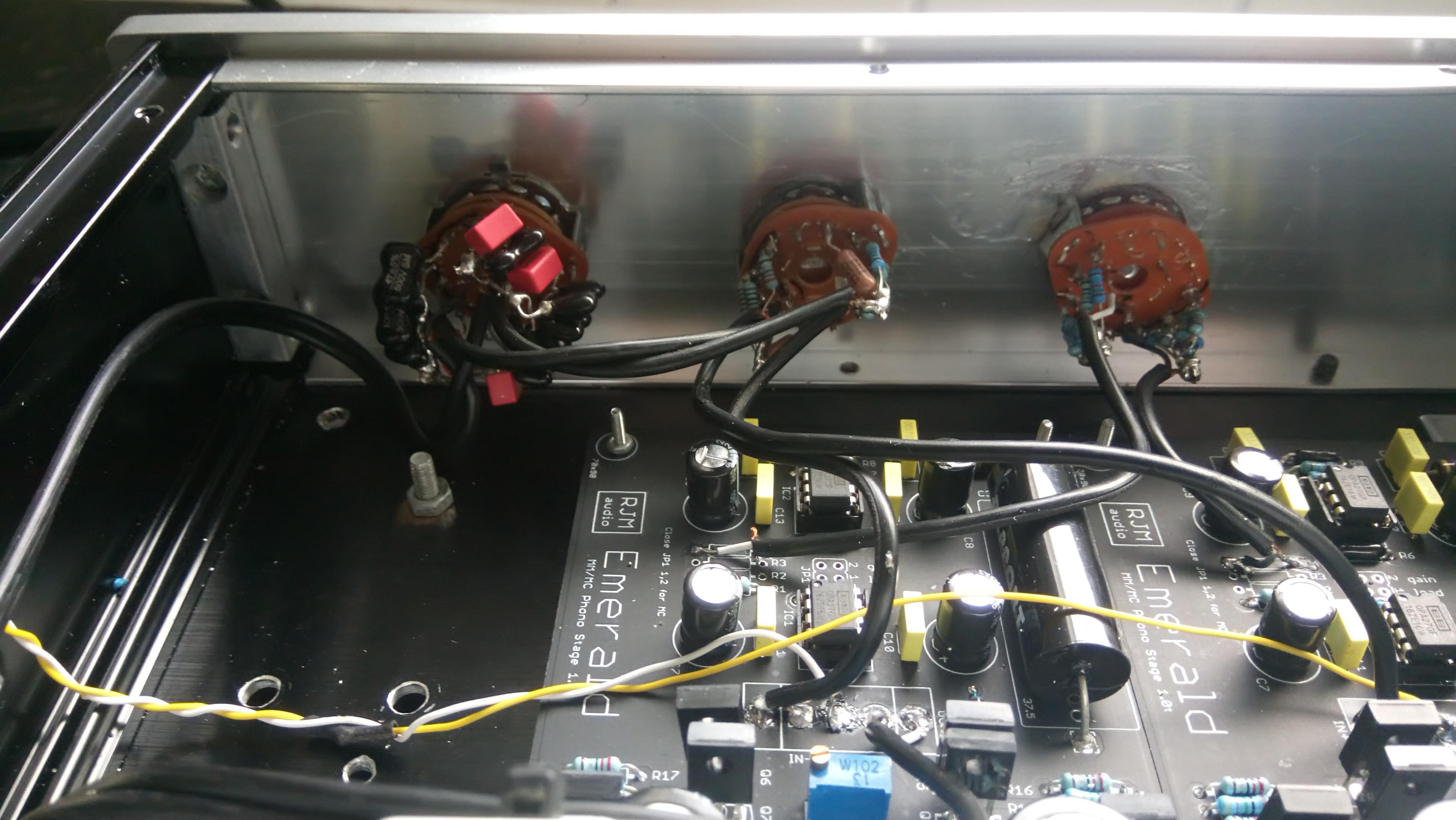

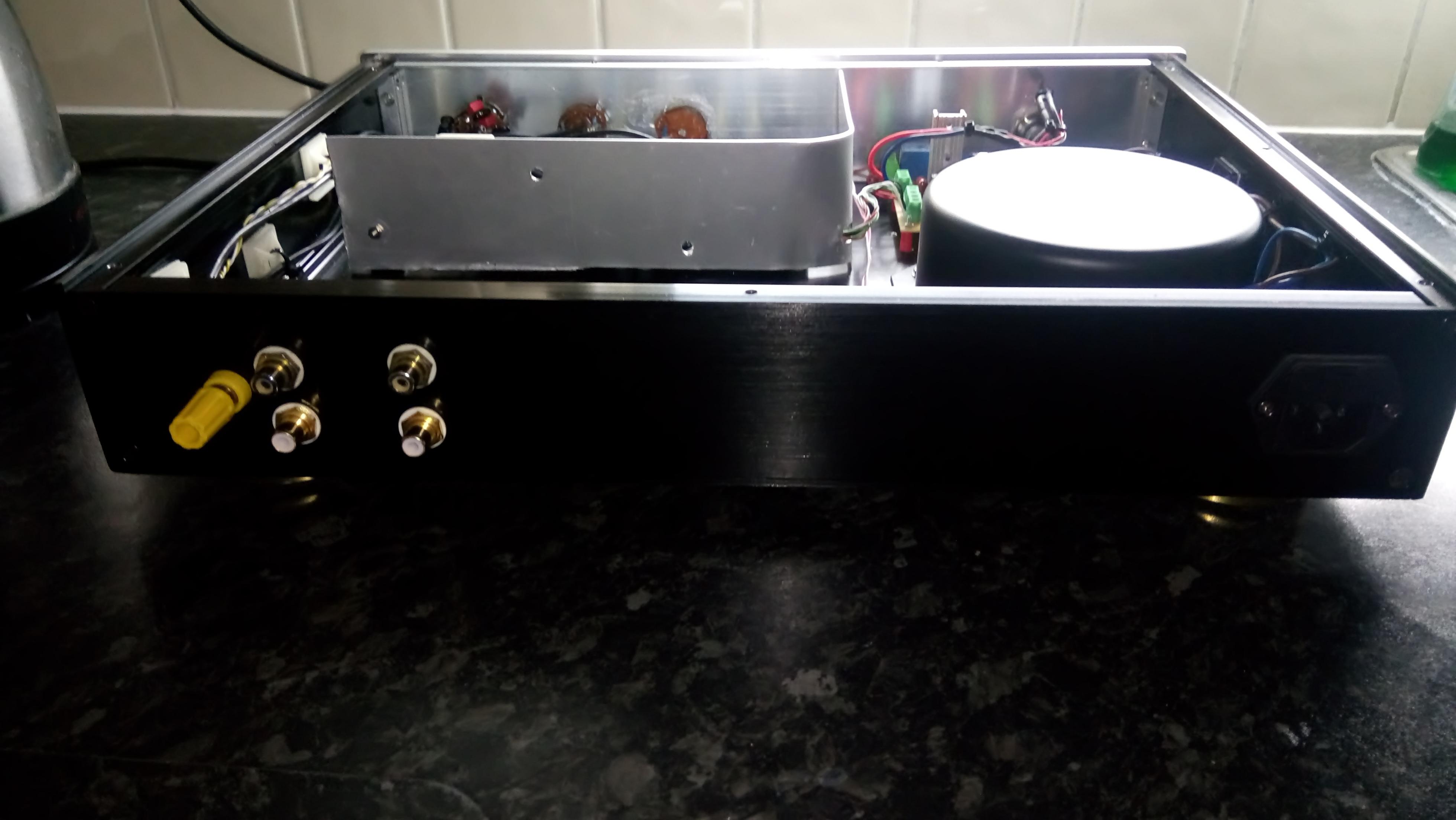

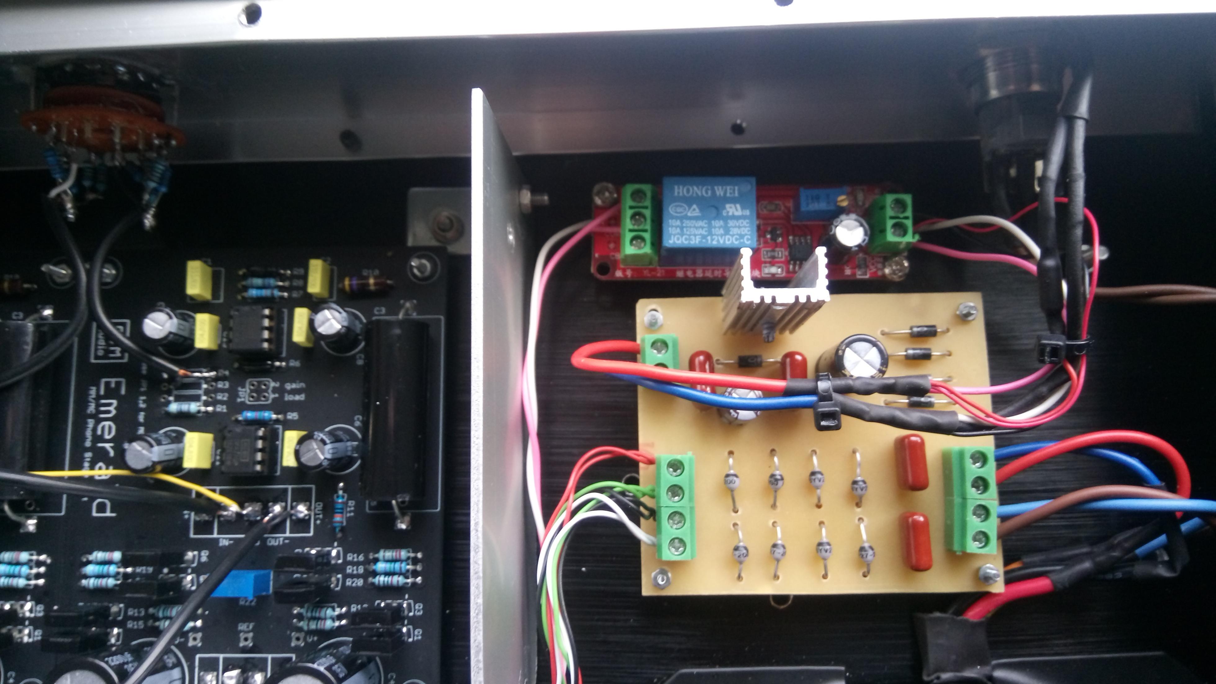

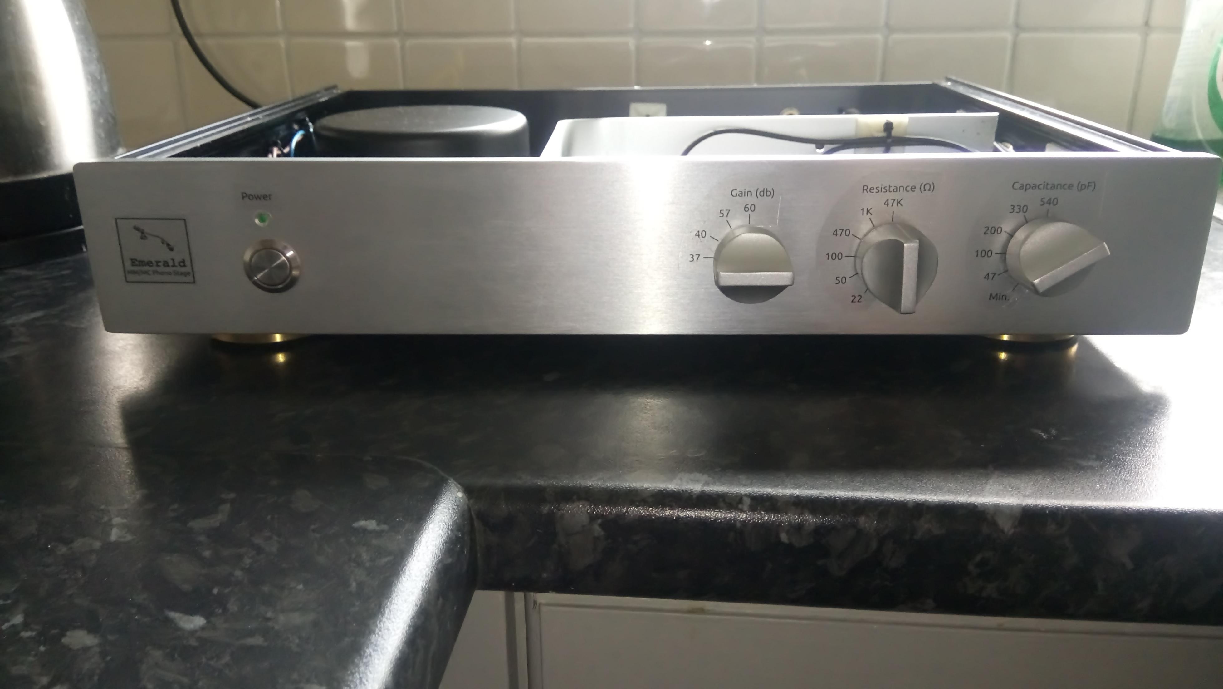

here's my view on a "Emerald" based phono stage I put together a few months ago..
custom made pcb for the rectification and the aux power supply, delay relay to get rid of the popping noise as a result of capacitors charging/ discharging during on/off operation, cartridge loading and gain selectors at the front panel..
