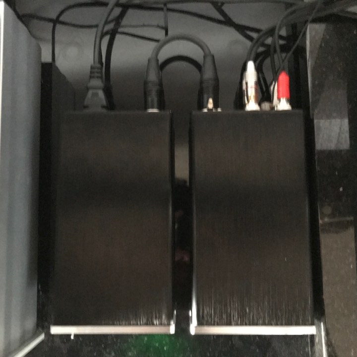

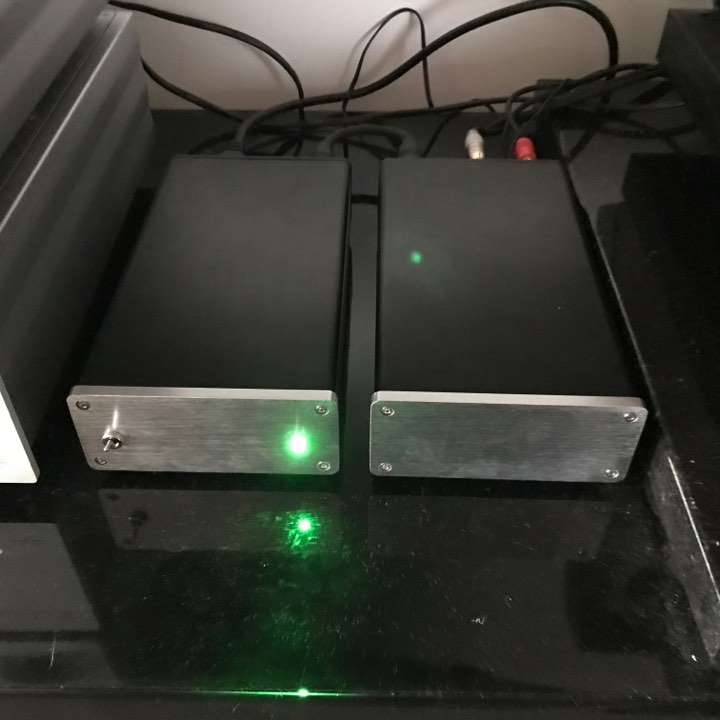

My next build - phonoclone - again with the HUM issue.
Again anodized chassis - but i filed it in the areas where it connects and multimeter beeps happily on various parts of the enclosure.

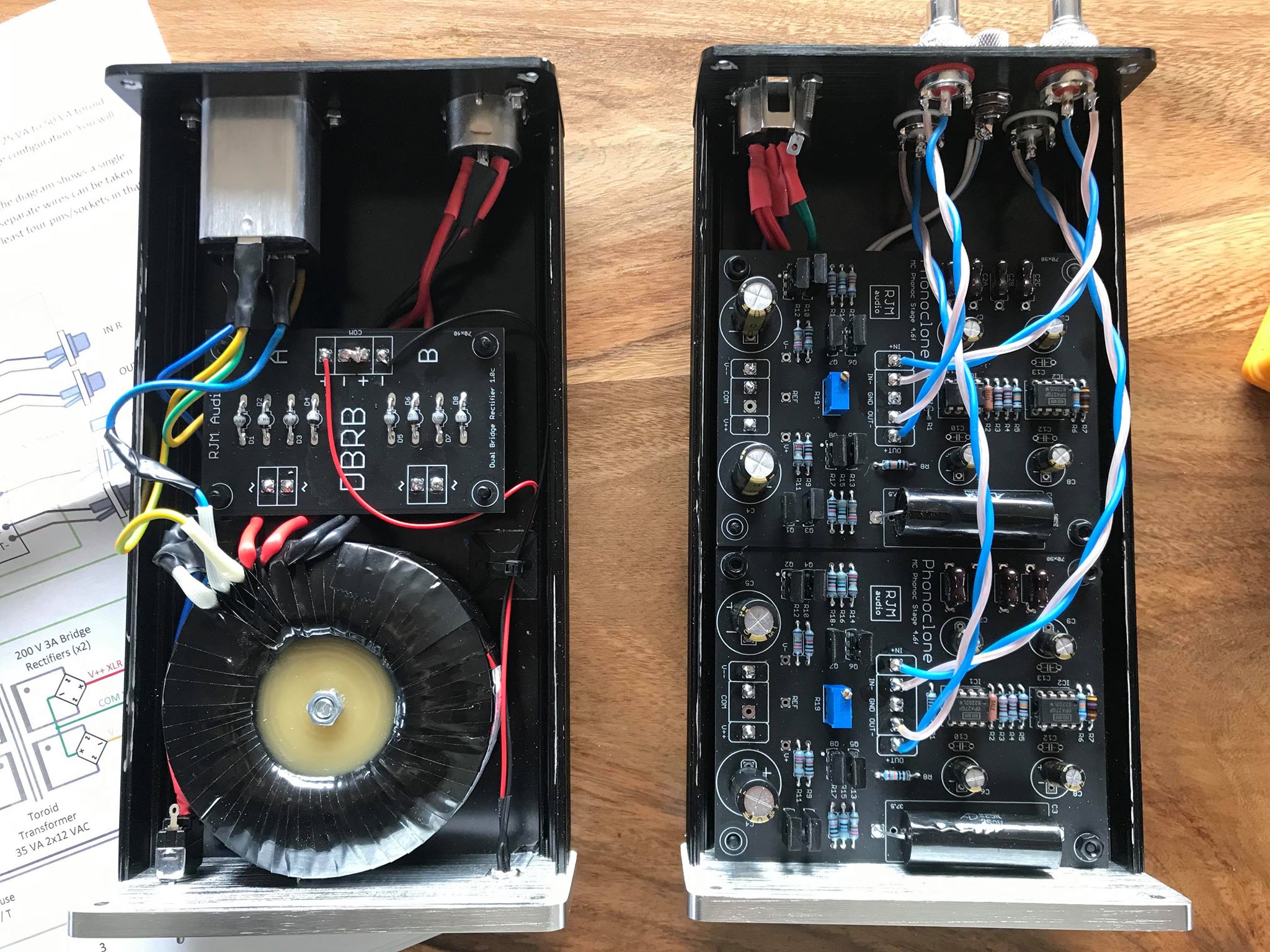

PSU
The transformer and earth in IEC is connected to the chassis.
PRE
Ground connected to the lug. RCA isolated from chassis ( checked that before soldering wires)
So it HUMs - but what worries me is that grounding TT to the post makes no difference. Like there is no reaction. I know that TT works well, tested with 3 other preamps.
What else i might have missed ?

Everything looks in good order, I'm fairly confident there are no mistakes, but just to confirm please run through the per supply voltages for me, V++ V+ etc.

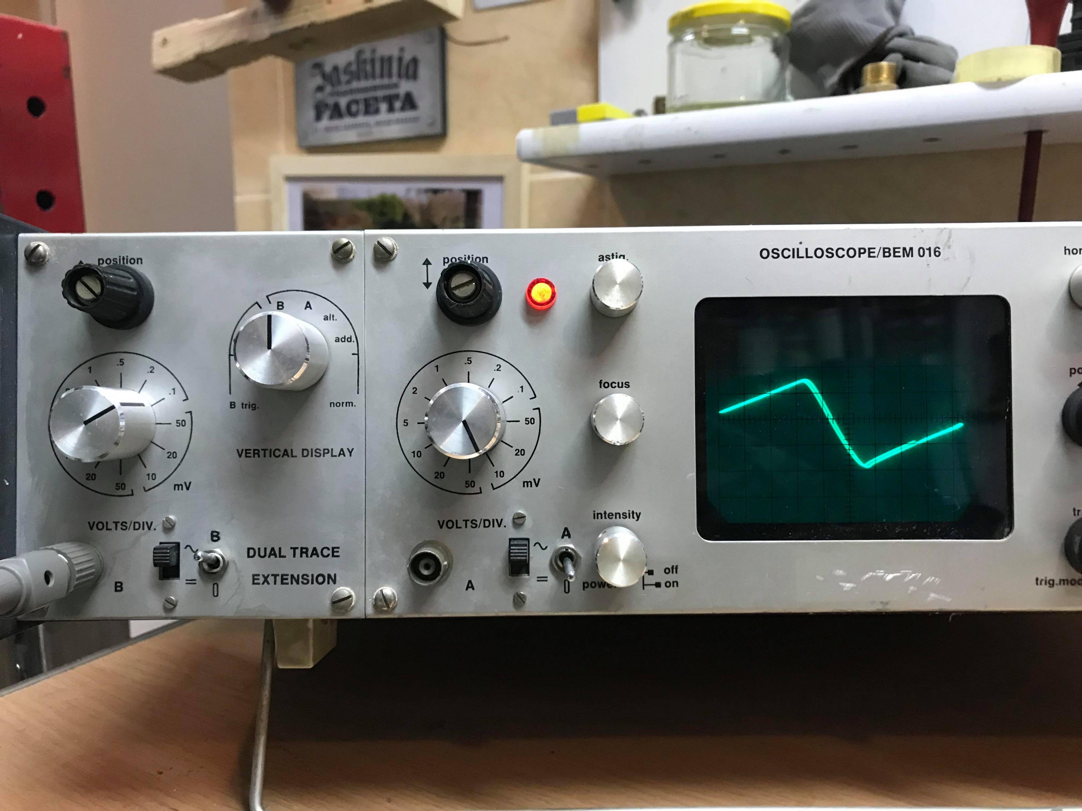

My multimeter is too shitty to catch such small AC values ( only two scales 750/200) i fired up the the scope for the first time and i picked up something saw alike ( on the picture ) before filtration V++ V--, tried more sensitive on V+ and V- and on 50mv setting there is very very tiny "floatation" of the curve,

Your 'scope has 10 mV/div gain range, that's sufficient for our purpose here.
Of course the V++ V-- will have a large sawtooth wave pattern. Those get removed by the S-reg, and if you do not observe a similar pattern on V+ then all is good in the power supply. Next is to measure the phonoclone output with the scope to see if the same sawtooth wave is present, or what shape and magnitude the noise signal has. The shape can tell you a lot about what the source is.
