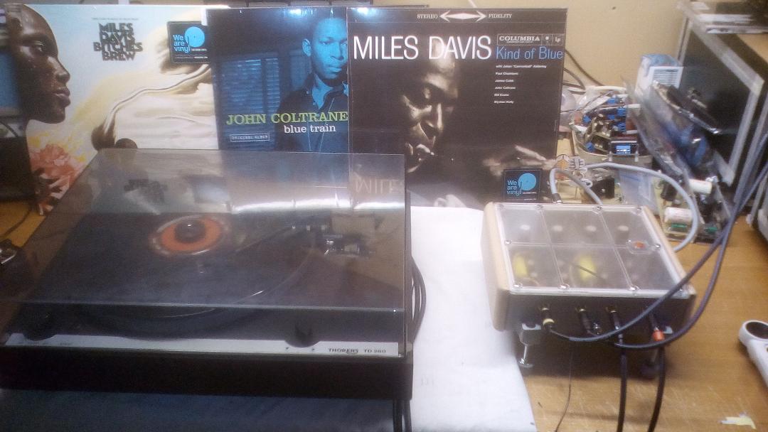

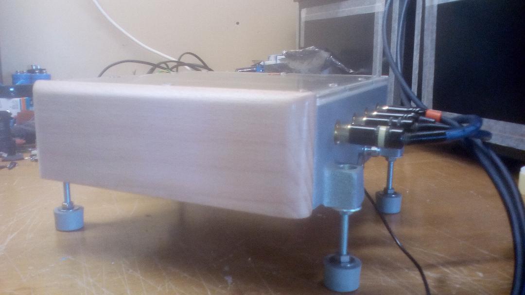

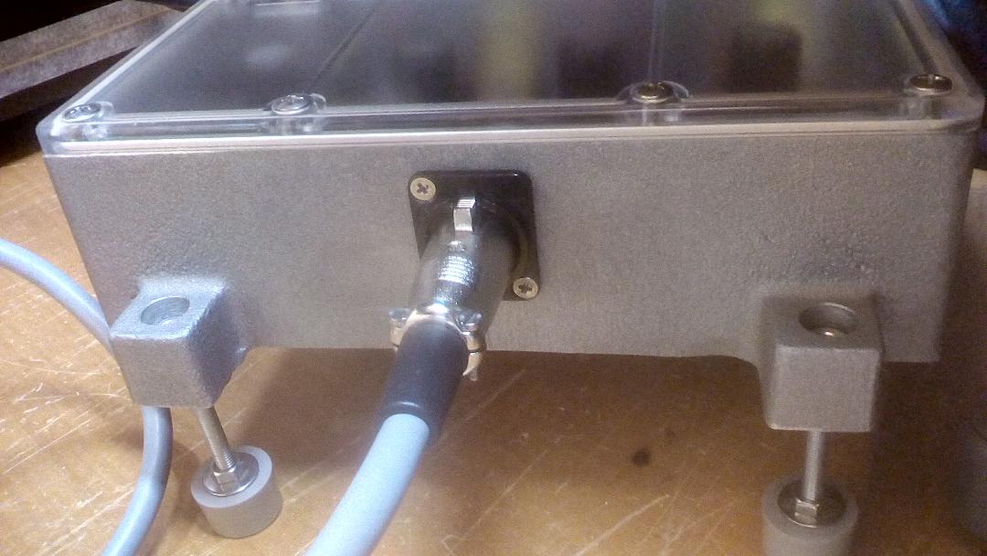

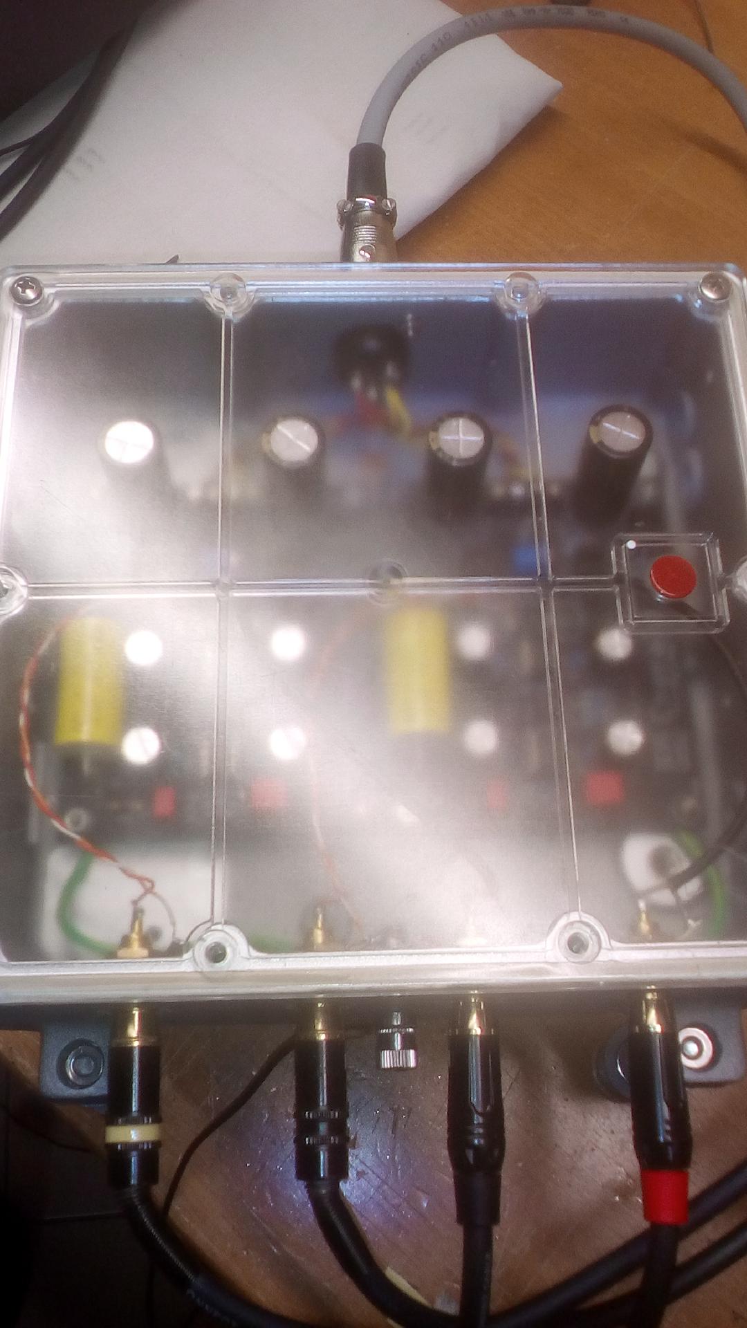

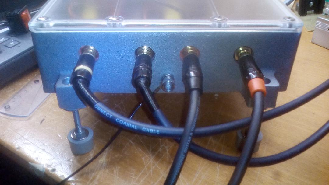

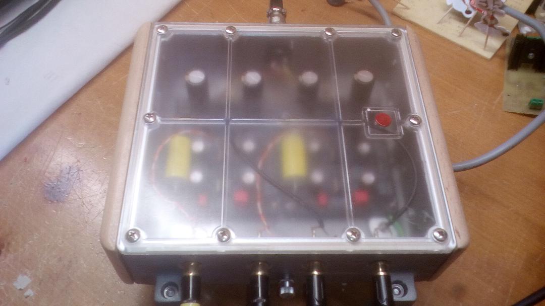

Thank you Richard,
I added the missing ground point in PSU and did some sanding for both chassis units. now it works like a charm. Dead silent and I'm also super stoked with sound quality - finaly a phonostage that pumps some base to my speakers.
Thank you again!

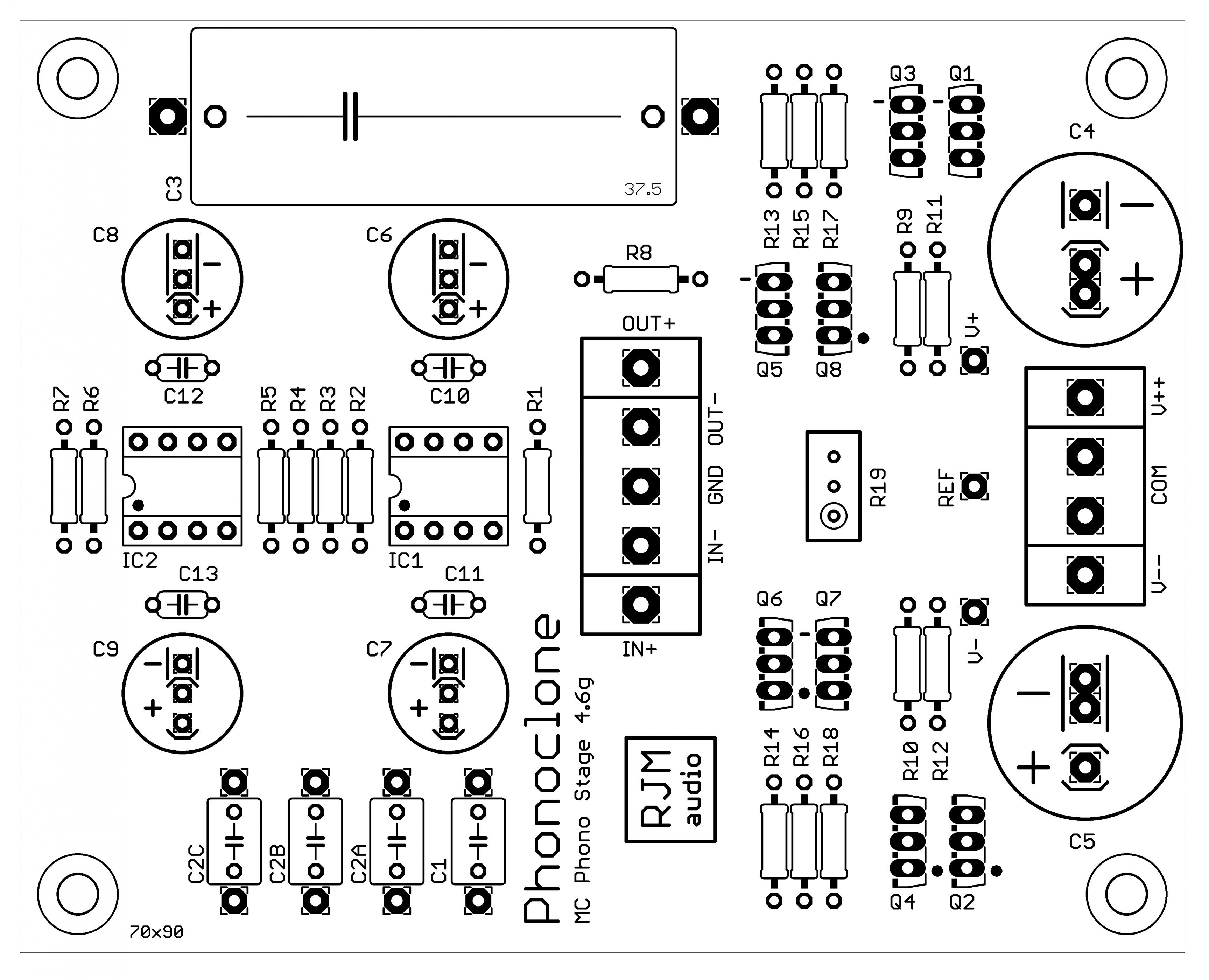

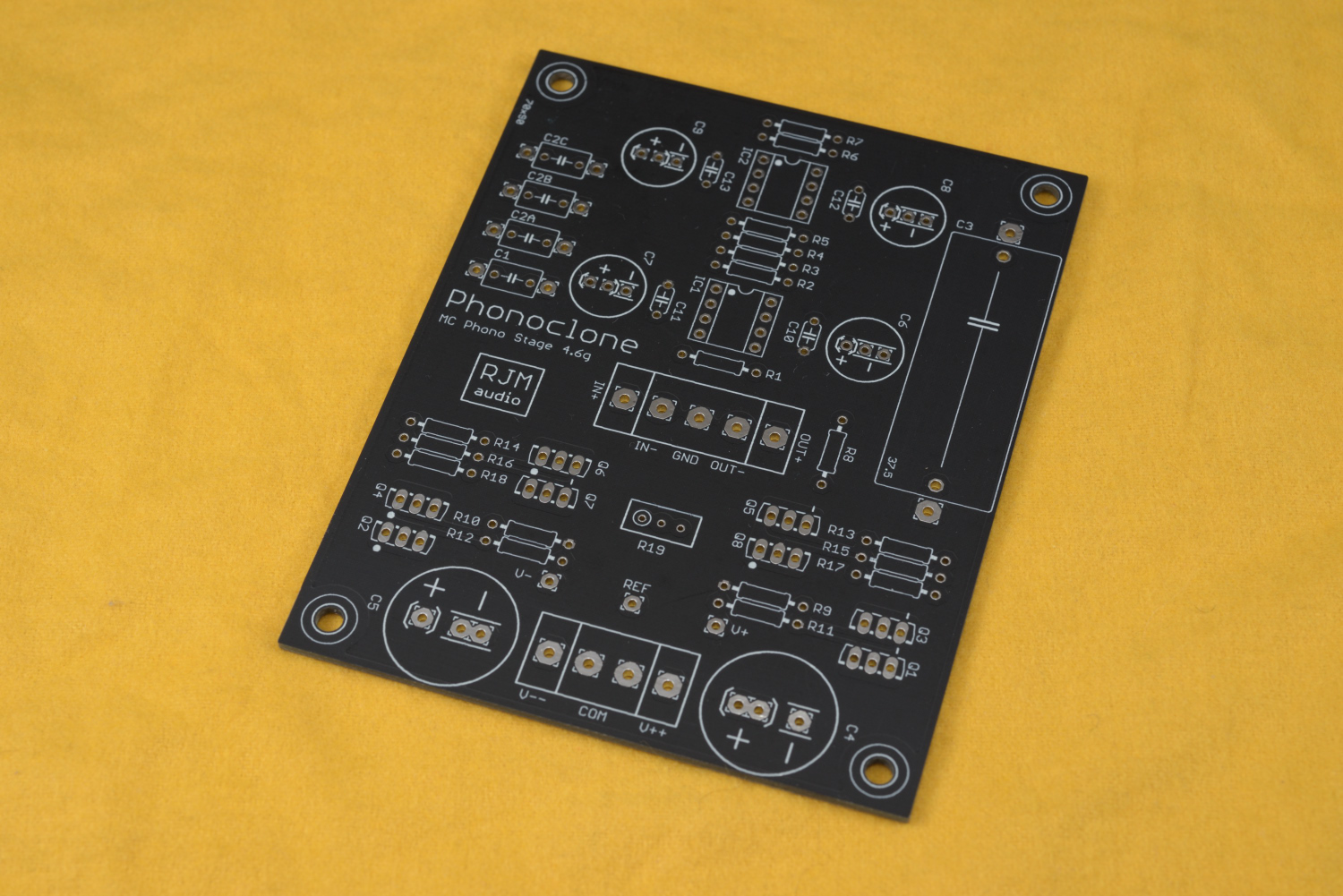

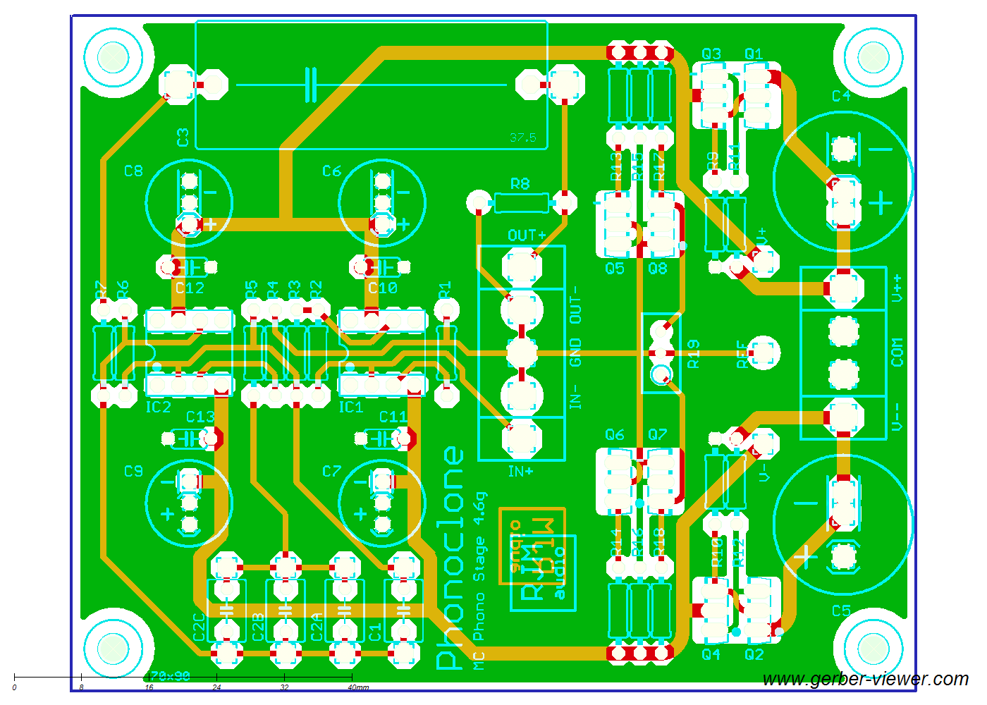

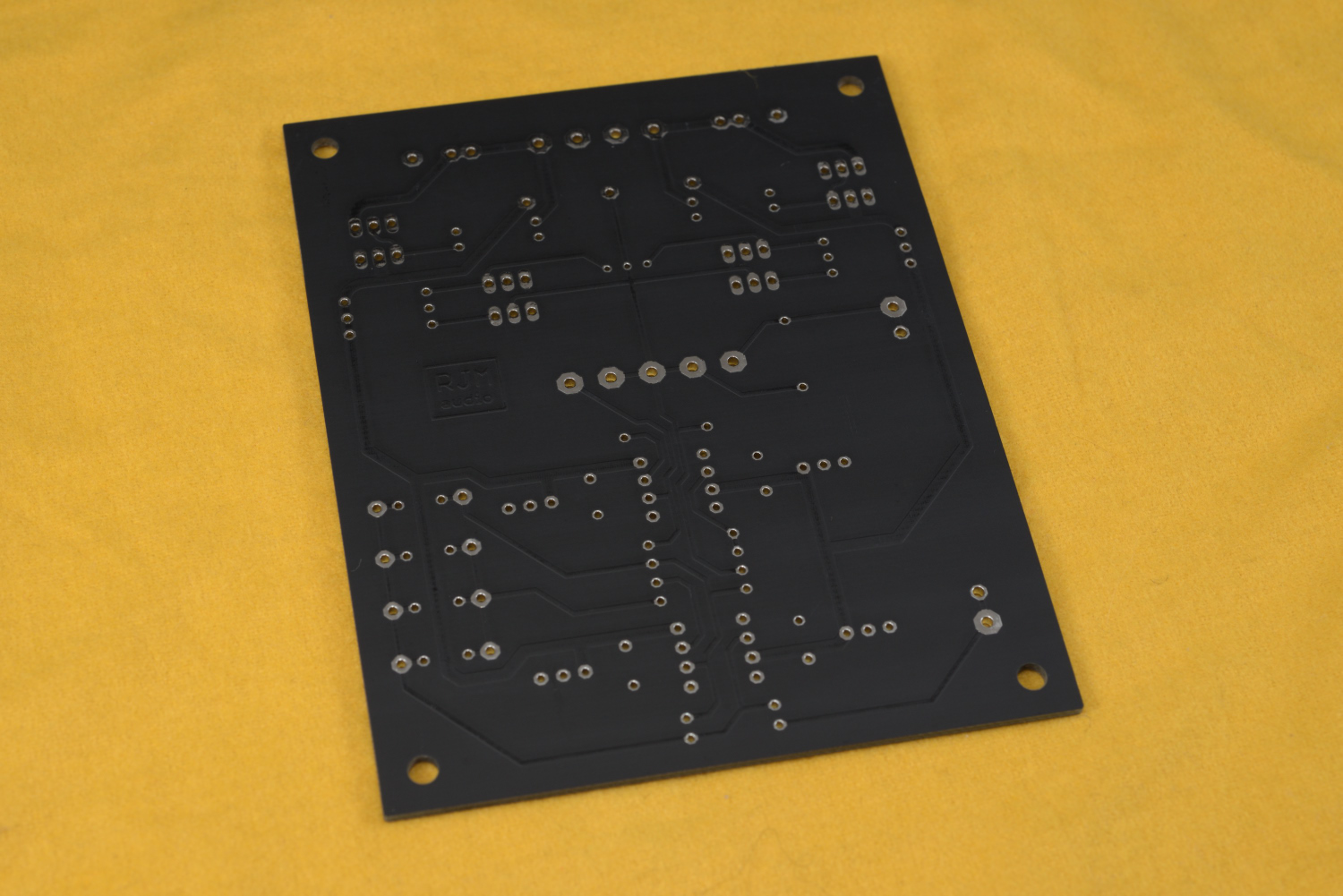

Phonoclone 4.6g
Cosmetic changes only, to bring the board to the same revision iteration as the Emerald.

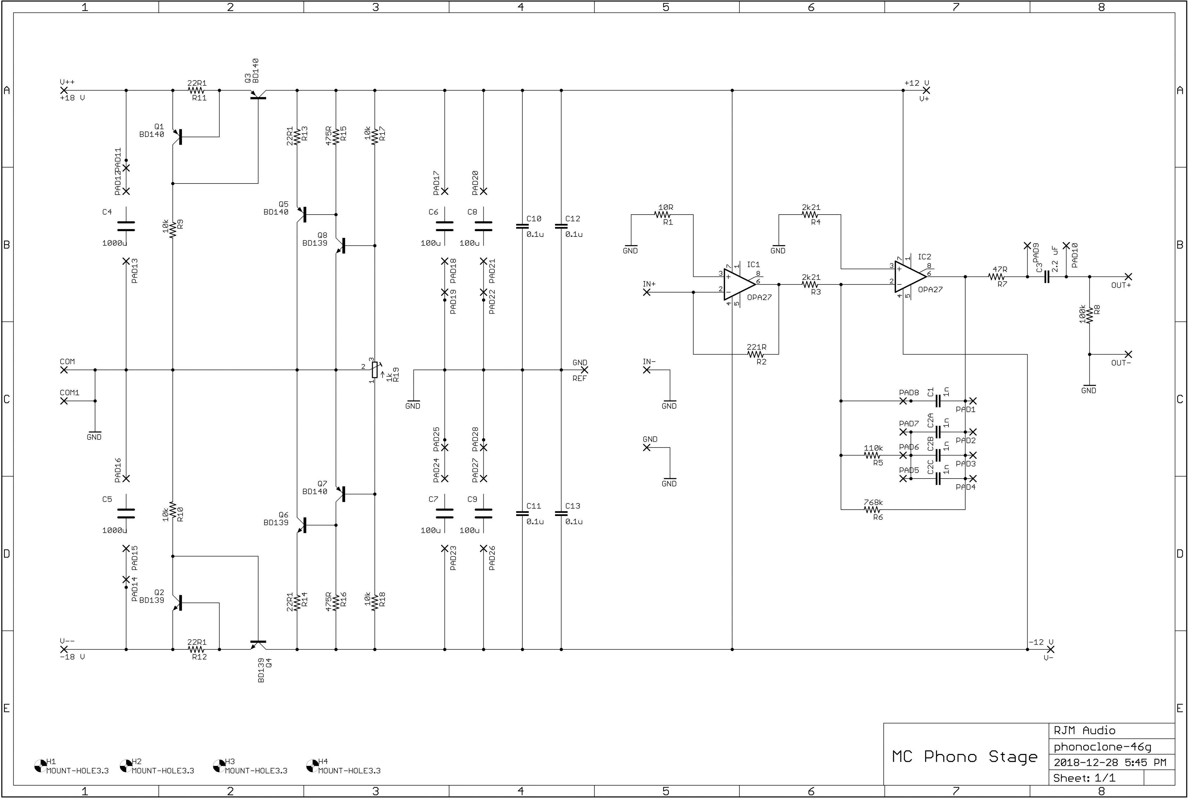

The idea has come up a few times.
Not needing one myself, it's never been given a priority. The problem from my end is conceptual: I have an MC stage. It's 80% of the work and expense of an MC phono stage to make a step up head amplifier. So personally I'd have to switch the gain of my Emerald back to MM to be able to add another box an power supply to get that gain back.
The other one is practical: if I used an op amp, I'd be literally just taking the front stage of the Emerald and replacing it with the same thing externally. If I used discrete transistors the task of making a low noise circuit competitive with the best commercial op amp ICs would be monumental, once both output noise and PSRR is considered.
On the other hand I might be willing to do the board layout and BOM, if you can suggest an interesting circuit schematic.
Thank you, I'll think about possibilities. I've considered building the Le Pacific jfet front end for MC but I don't know enough to know what a good low noise circuit would be. My interest has to do with already having a number of good MM preamps, both tube and solid state, and only 1 MC cartridge. I'm currently using a step up transformer but feel like I'm getting some upper end rolloff and I'd love to play around with something that might not suffer that problem and let me try it out with my existing phono stages.
Any single transistor gain stage (jFET or bipolar) will get you the gain and give quite low intrinsic noise, the problem is the PSRR of these circuits is beyond terrible so you have to spend all your effort to build a really low noise power supply, or go with batteries. And by "low noise power supply" it's not just line regulation you have to worry about, but the output noise of the voltage regulator itself.
Yeah, I understand. That's partly why I say I don't know any good circuits (noise is noise at the output, whether it's PSR or circuit noise). And it makes sense this would have no PSRR. At such low currents and voltages, batteries aren't out of the question. After all, it's just the tiny step up circuit we're talking about. Anyway, I'll be in touch if I find something I think is worth your time. Thanks for the input and the offer!
