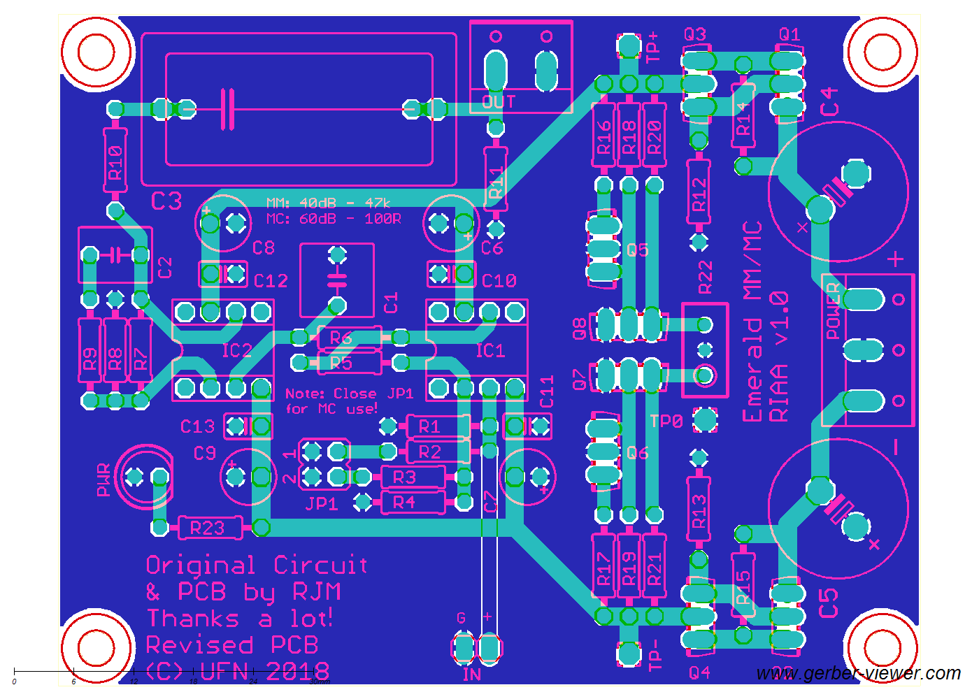

Have now had my Emerald-clone hooked up so I can actually listen to it and I must say that it sounds very good. Thanks for allowing me the opportunity to hack at your brilliant designs Richard 🙂
Looks good, and I appreciate the attribution.
Could you upload an X-ray image of the board traces? I'm curious to know what you changed.

Hi Richard, here's the pic, I think I posted it before. Thanks for your help!
BTW: i moved the earth of the mains to a separate point - changing it doesn't make a difference for the noise in the preamp.
That's about as clean as can be expected and as reasonable a layout as can be hoped for given the space constraints you are working with here.
Perhaps try changing op amps, or adding the 0.1 uF ceramic caps. I'd also consider changing the coupling caps as those large cans could be picking up noise. Try disconnecting the indicator LED. Try disconnecting the safety earth (temporarily).
I worry however that it's none of the above and the power transformer is simply too close. You could try powering the circuit from an external supply to confirm that, and, if so, consider using a shielded transformer (Triad VPM) for example, if you have to have a single-chassis unit.
