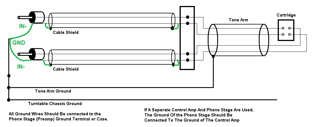

I made this cable and the HUMM went.
You were right, the problem is the turntable cable.
I do not know why it used to work and not now. But problem solved.

That wiring diagram is fairly conventional, the difference from normal is the connection from the cable shield is taken externally to the ground. Typically it connects to the RCA shield connects to IN- and routes to GND through the board.
I suppose the setup is a bit cumbersome around the RCA jacks, but it it technically rigorous and should give the best shielding.
It's prolly a matter of ground loop if you connect vs not connect the shield to the phono amp...
It's more like "double shielding" the input wires. There's an additional measure of protection against electrostatic noise, since the outer shield is wired separately from the IN- signal return. The signal return is just part of the inner twisted pair.
Normally the shield is connected back to the signal return at the RCA jack, as shown.

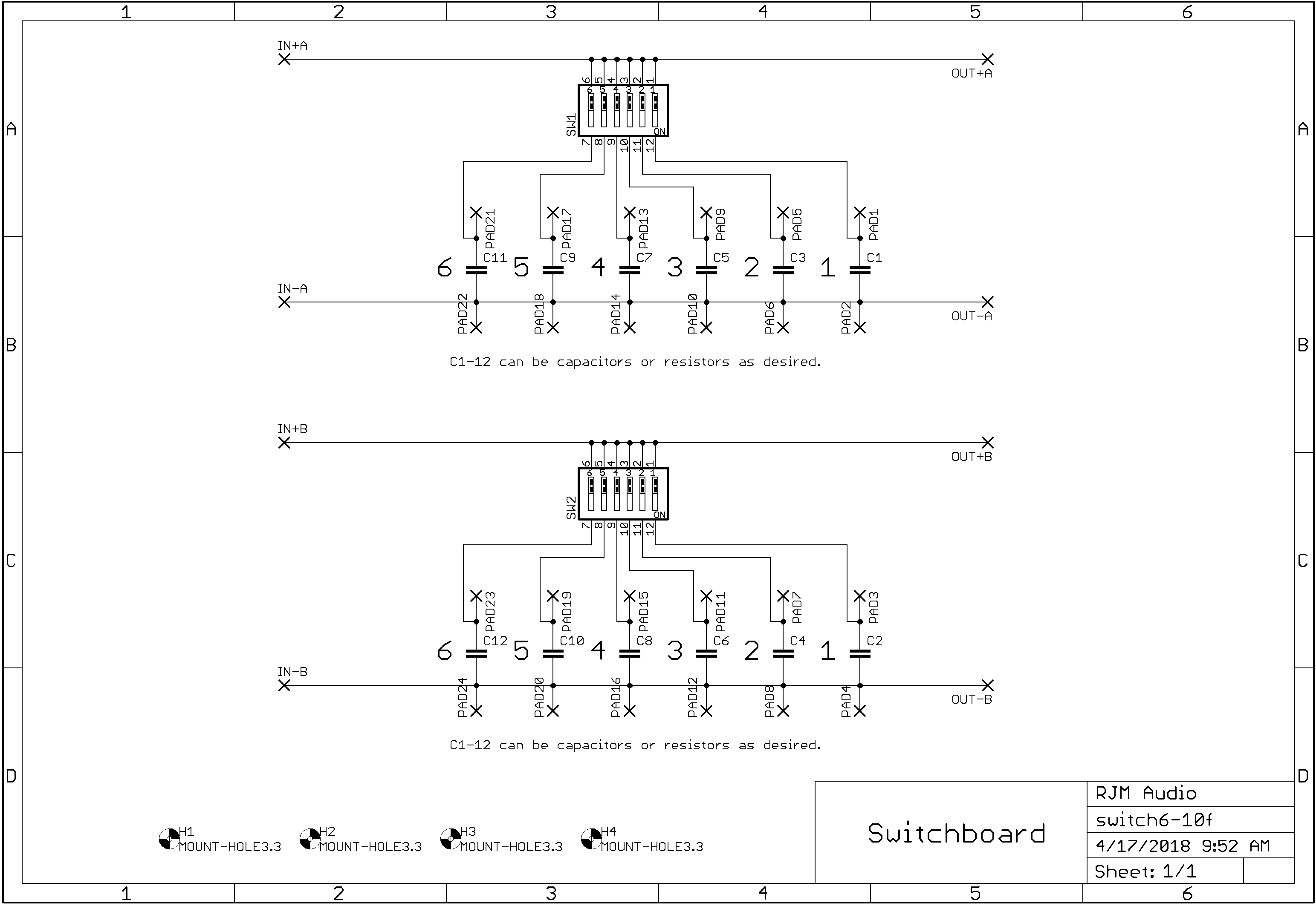

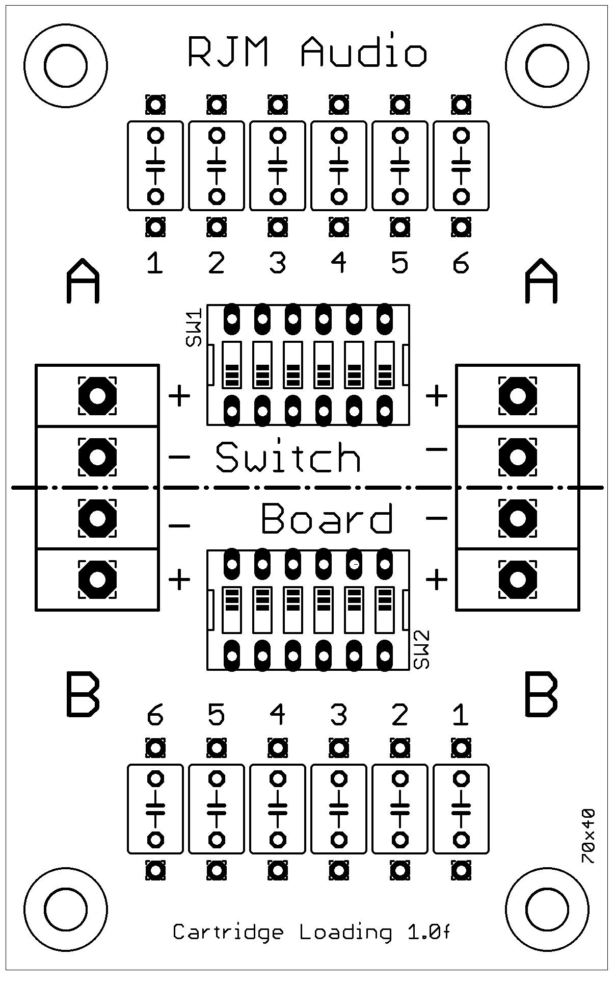

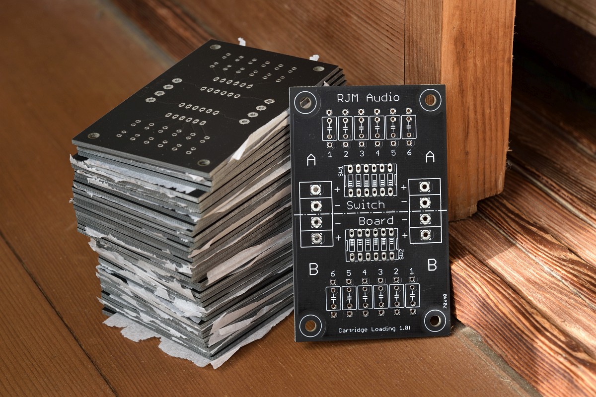

The SwitchBoard has been updated to rev. 1.0f. and project status moved to "production".
There is almost no change, none significant, from the earlier 1.0d boards.

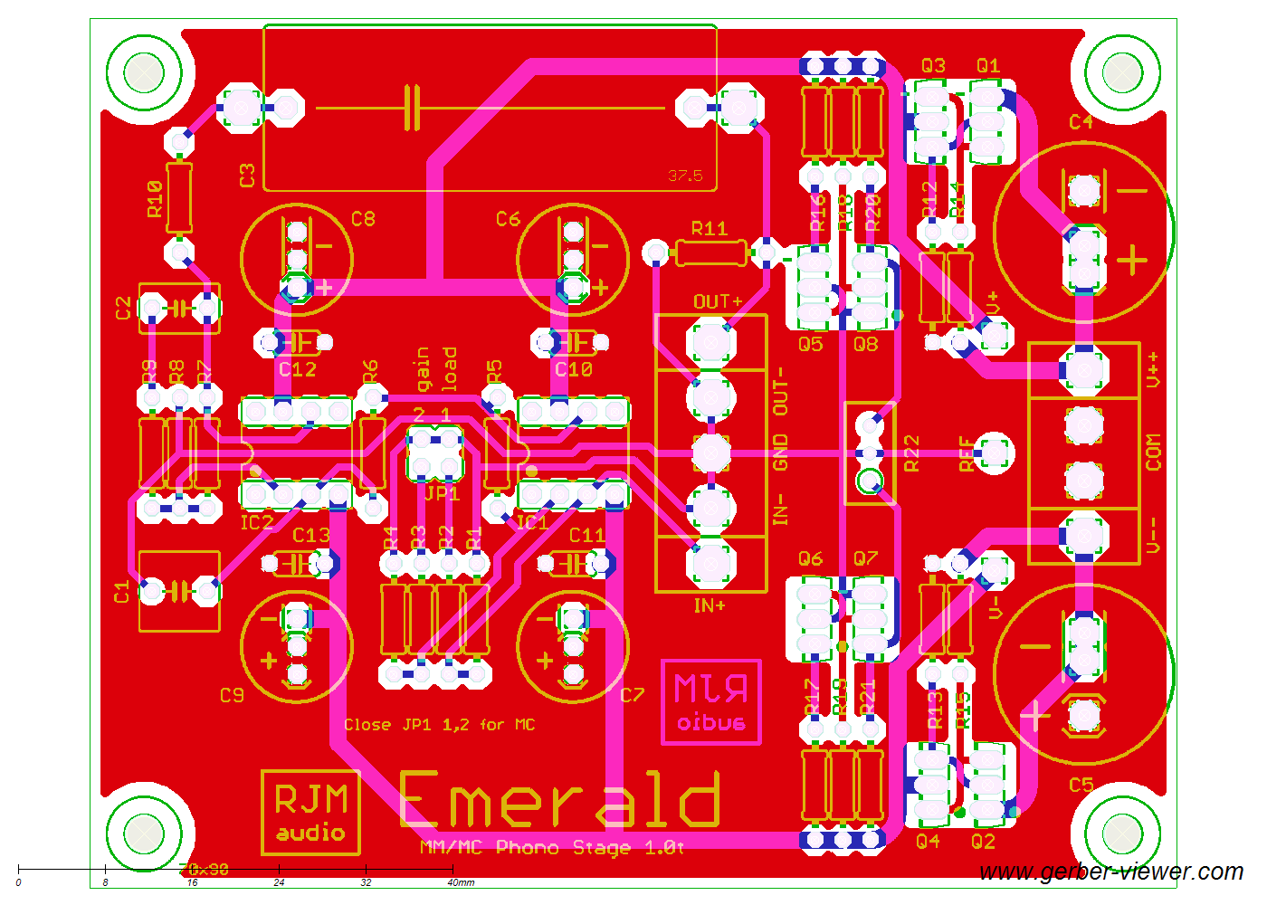

So the Emerald (Esmeralda) [That is such a cool name, I should have called it that instead!] is designed with an LP filter in the interstage and a relatively low gain input stage. The overhead, or headroom, therefore, is determined entirely by the output stage and is independent of frequency - you can safely use the midband values for the calculation.
The exact values will depend on what gain you choose to set it up for, but the output is anyway fixed by the power supply rails, so it's about 6 V rms max or +15 dB for 1 V rms reference, but +25 dB against the nominal line level signal of -10 dB.
So to do the calculation for say the DL-103, which is 0.3 mV at 5 cm/s 1 khz, or -70 dB, you dial in 60 dB gain into the Emerald to bring that to -10 dB line level, with 25 dB of headroom to spare. If you used 57 dB gain, the headroom would increase to 28 dB, but the output signal is lower and you'll need to increase the volume level more to compensate. The point is you are always trying to bring the cartridge output (as referenced to 5 cm/s 1 kHz) to -10 dB for line level. Some recordings might exceed this slightly, but with 25 dB spare the Emerald should be able to take it in stride when the gain is configured in this fashion.

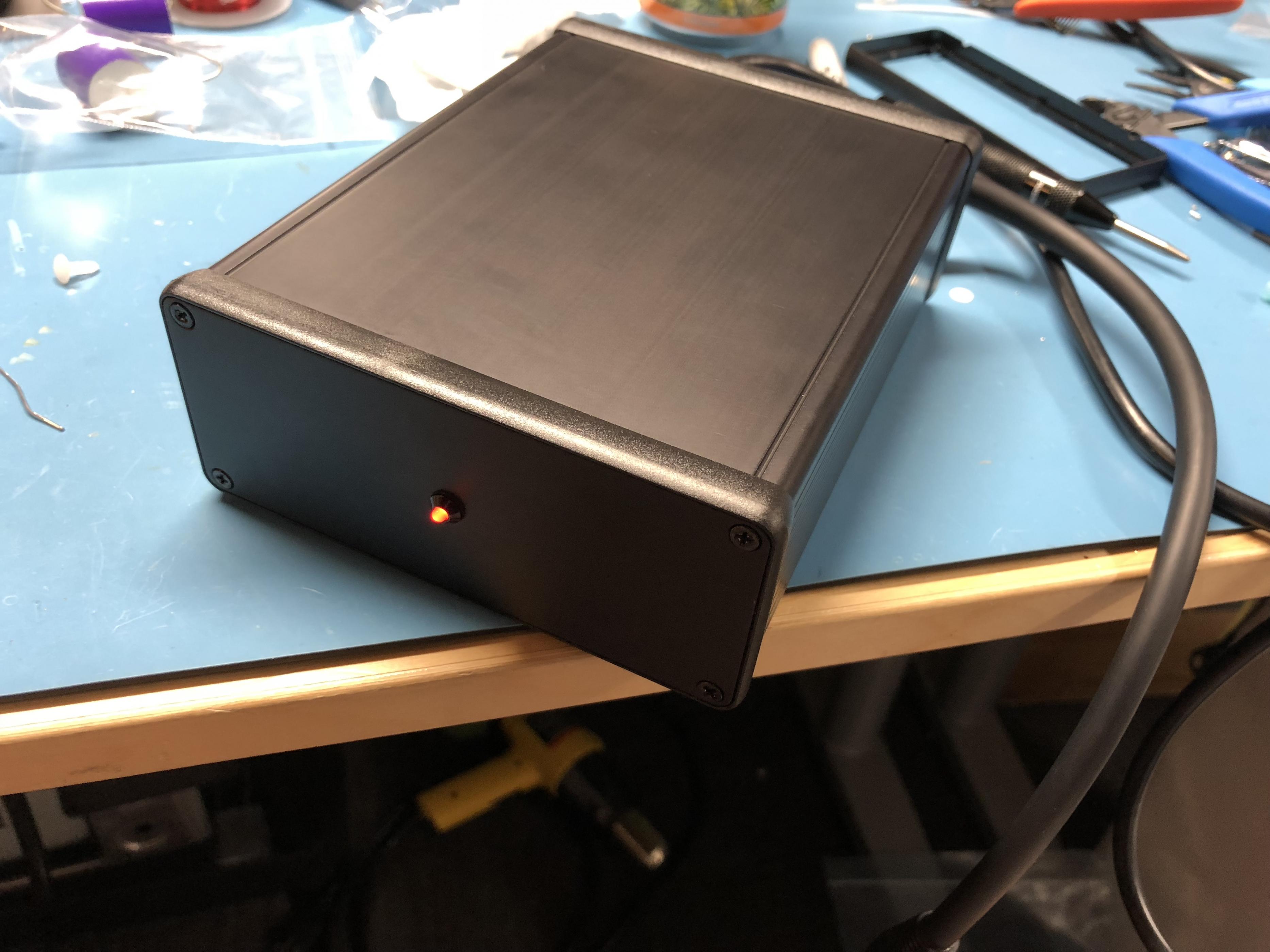

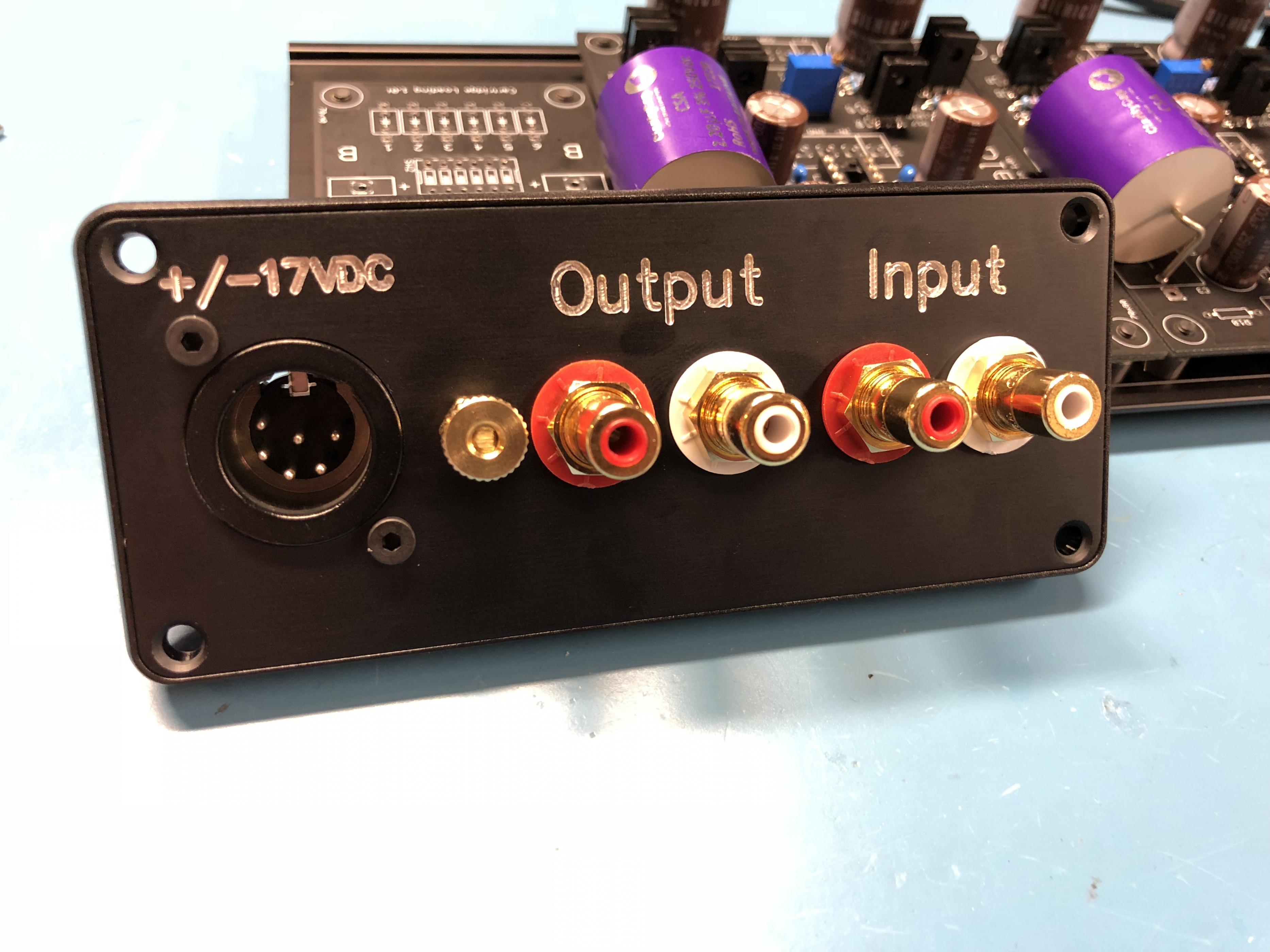

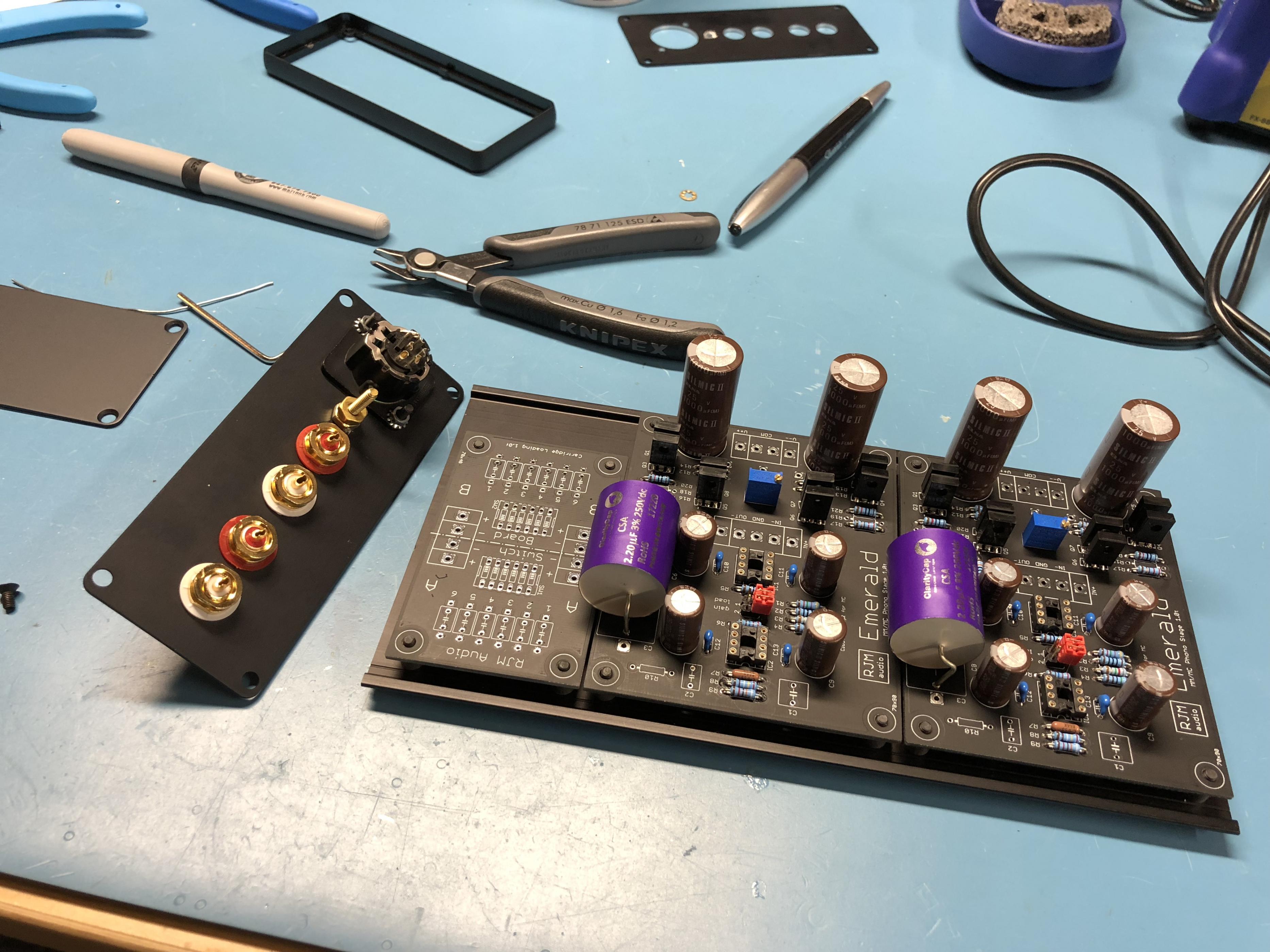

I received my Emerald 1.0t and the latest switch board a few weeks ago. Richard, the boards look wonderful as usual, you can tell the care and attention that went to get the layout to revision "t" 🙂.
After an initial order of parts from DigiKey, I have the Emerald partially completed, with most of the case work already done. Only a few more components on the way to complete the switch board, along with replacements for some mis-ordered resistors. I wanted to share the details of my build and my progress so far.

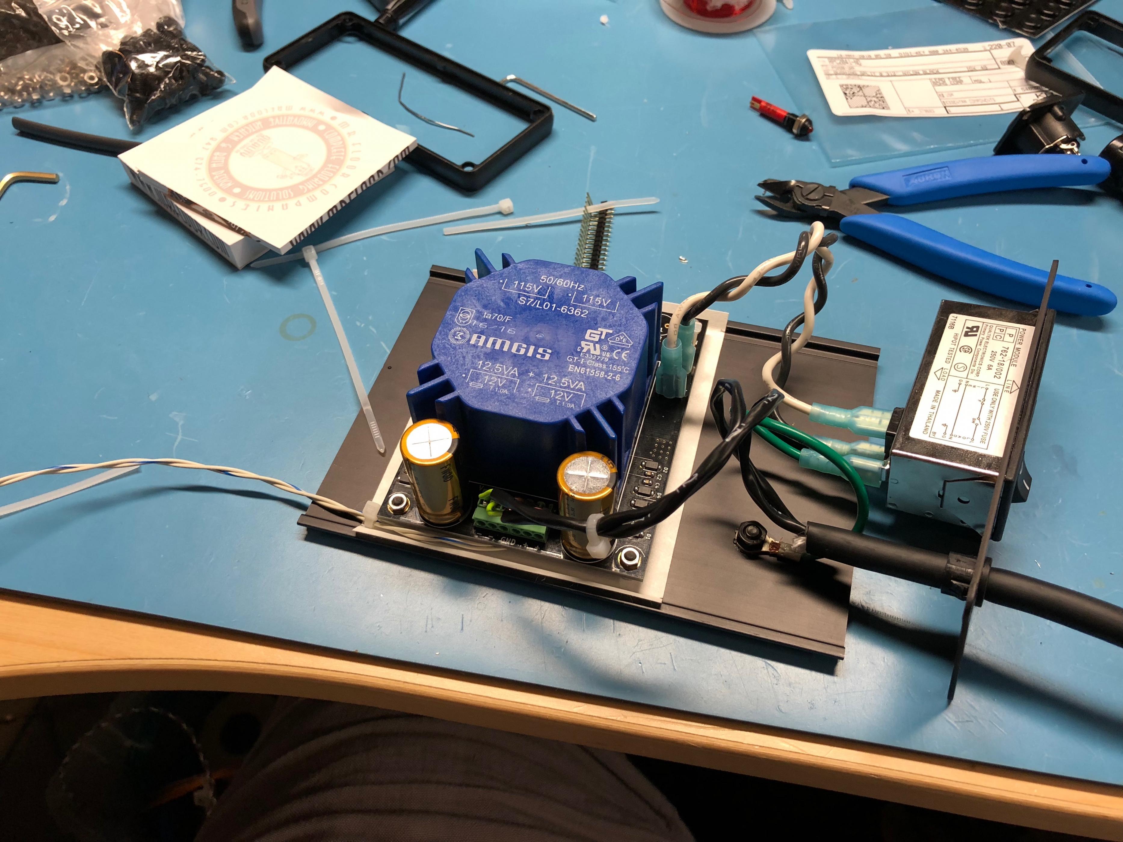

The power supply is constructed using a PCB mounted transformer circuit I had originally designed for the Sapphire. It fits Talema's 25va transformers (or their competitors' duplicate) as well as discrete rectifier diodes, smoothing caps, and some other extras. I am running the umbilical cord to the Emerald chassis using a cable that has two independently shielded 24awg twisted pairs. These run to each channel via a 6 pin Neutrik XLR connect. I have this fit into a Hammond 1455Q1601BK enclosure, along with a filtered and fused IEC module.
The Emerald boards and switch board are housed in an identical, but longer, Hammond 1455Q2201BK. I am trying out Clarity Caps' new CSA line for the coupling cap. I needed some other parts from PartsConnexion, so I am going to try out Amtrans fancy AMRG carbon film resistors for C10, if for no other reason than the looks (see Amtrans AMRG Carbon Film Resistors | Hifi Collective).
I can't wait for the last shipment of components to arrive so I can try the Emerald out. It's been an incredibly fun build so far and I really appreciate the work that Richard puts into his projects.
