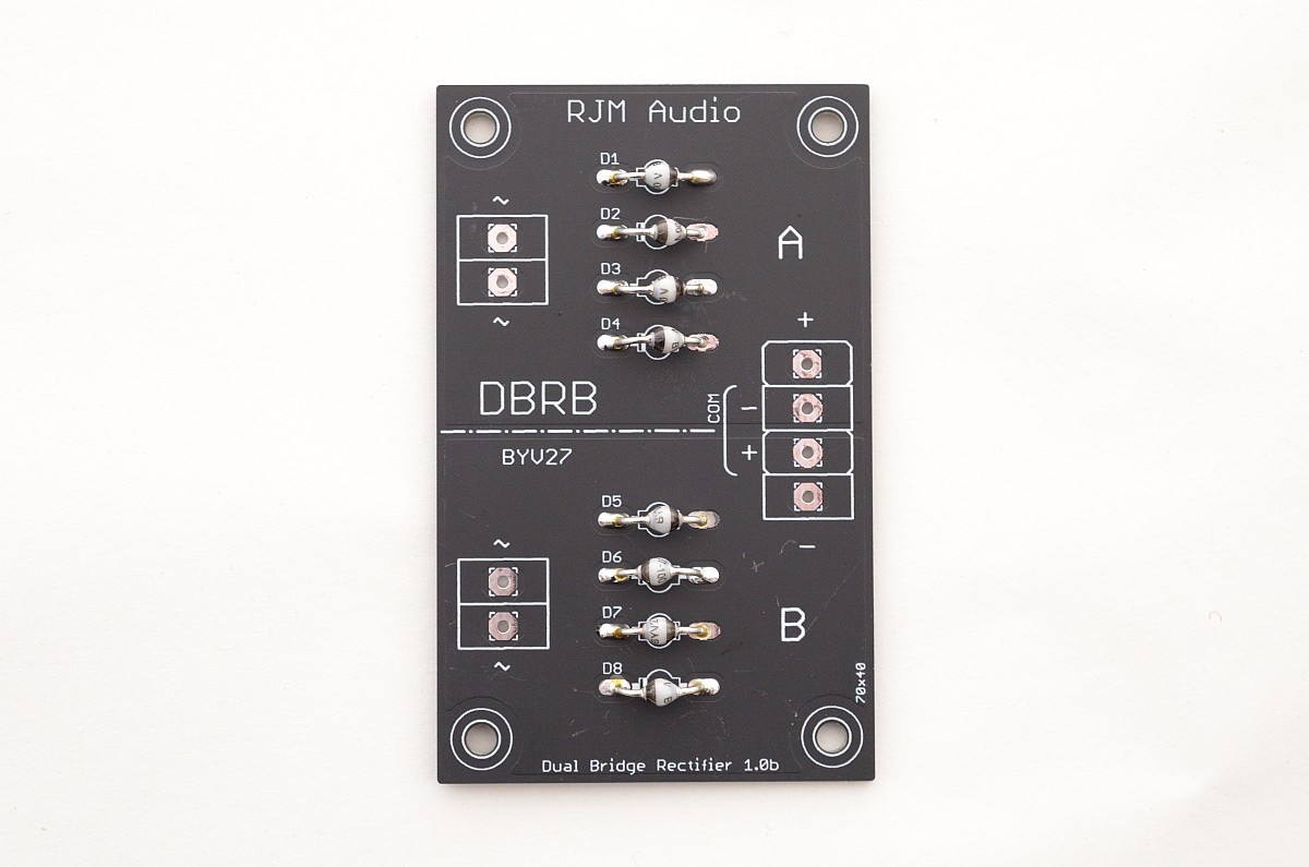

I've been trying to find how to wire the toroidal transformer up to the power board for a while now and haven't found it yet. I've had everything but that, the switch, the fuse and the box done for a while now. Could you please advise me on how to connect the power. I've got the vsps.
Thank you for your time.
You could have just asked right away!
The reason it's not given is because the connections depend on the transformer you use, and the diode configuration.

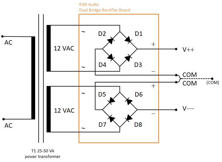

If you have the DBRB, or are using two bridge rectifiers or the discrete equivalent, it connects as per the diagram below. One secondary winding connects to the pair of ~ terminals on one bridge, the other secondary winding connects to the ~ terminals of the other bridge.
If you using just one bridge, please follow the directions provided by the transformer manufacturer to connect the secondary windings in series and connect the now center tapped secondary to a single bridge rectifier as per the standard textbook full wave bridge rectifier configuration. COM in this instance connects to the center tap directly.
See also the construction guide and DBRB bom file.
I'm sorry but I don't understand what most of that means.
This is the setup you sent me (Shared album - Ben O'Brien - Google Photos) Here are my questions.
I assume the clip side is ac. Which wires go to hot and cold and are those clips for some plug systems?
I assume the other side is for the board. Does it matter which side of the board each wire goes to?

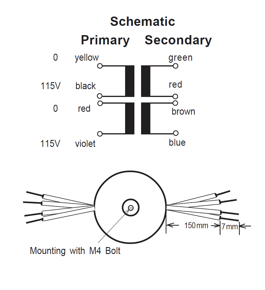

The transformer is Talema Standard Mini" Series Toroidal Transformers model 62062, 25VA, with two 12 V secondaries. (you can confirm is you slip off the copper/mu metal band from the transformer body)
The wire color assignment is found on the Talema website / catalog, reproduced below.
The wires with the clips go to the rectifiers. green and red go to one set of "~" pads on the DBRB, brown and blue go to the other set of "~" pads. Which winding goes to A or B does not matter, nor does it matter which pad of A, for example, the red or green goes to specifically. The four output pads + - + - connect to the VSPS etc boards as shown in the diagram.
The wires with the yellow cladding go to the AC. Since you are in Canada, your AC connects to the primaries in parallel. violet/black primaries to the black (live) AC wire and red/yellow primaries to white (neutral).
You can actually figure this all out without even needing the datasheet, just using a DVM and measure the resistance between different wires. You will automatically detect four pairs of wires with finite resistance, which gives you your four windings, two of which have relatively low resistance, which are the secondaries, and two which have relatively high resistance, which is the primaries. The only necessary information you would be missing in that instance is the phase of the primaries.

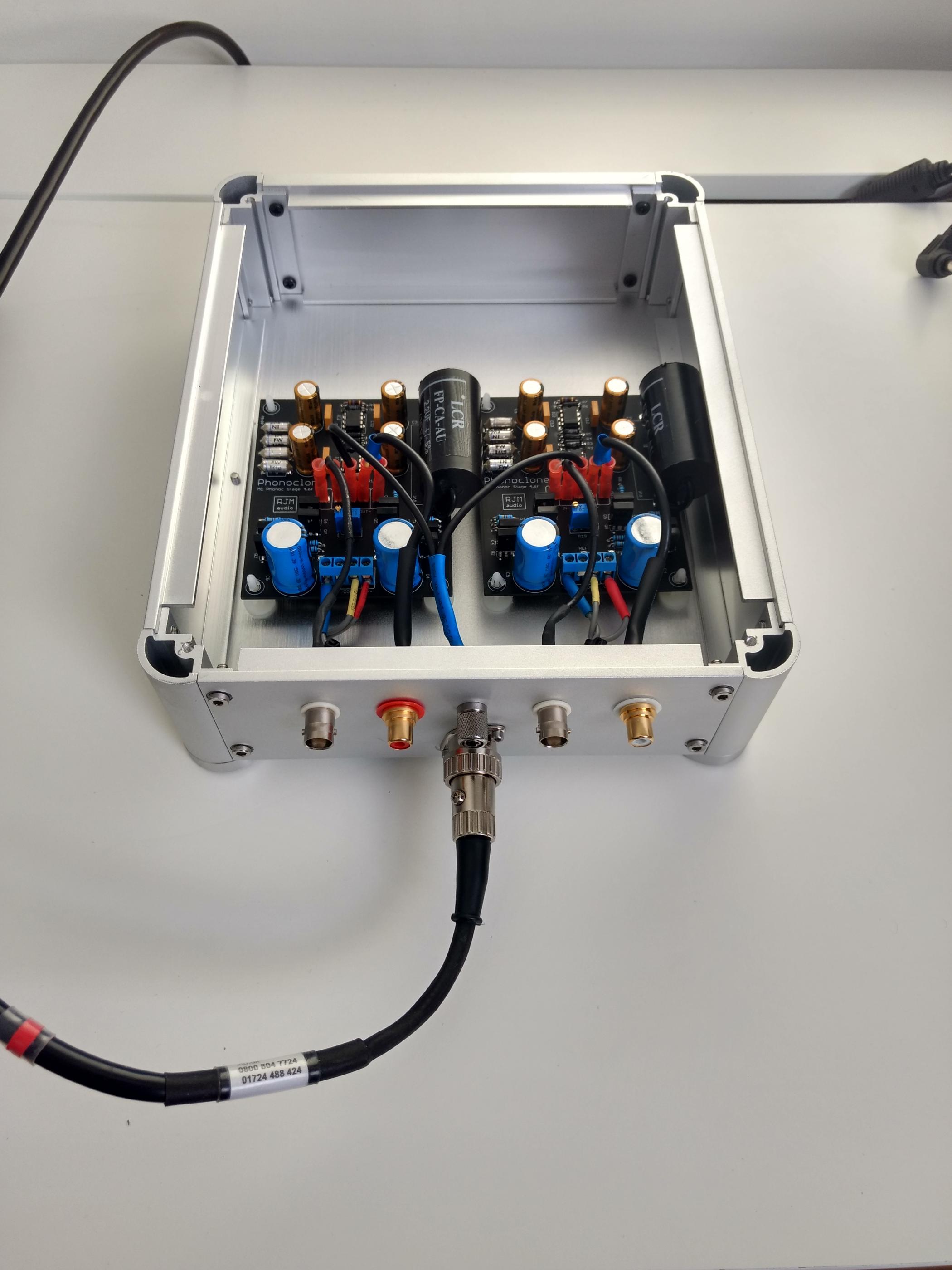

Hi Richard
I just finished building PhonoClone 4 and everything went well except for a couple of strange issues related to some random noises.
I'm getting popping and buzzing noise that happens randomly. Popping noise sound like a pop in the vinyl, but it happens when nothing is playing. It's not very loud but I can see the woofer to move. Another noise is the buzzing, it's not persistent, last for a about a sec then disappears. It's much louder than the music though.
PSU with rectifiers board in a separated aluminum enclosure, and it doesn't makes any difference if I'm using single or dual transformer/rectifiers boards. PSU and enclosure is grounded to earth, PhonoClone is grounded to the grounding points on the board.
Any suggestion on where should I start to troubleshoot these issues?
S.
S.

Thank you Richard. I indeed received your email and had to reply with a different email account, otherwise my email will be rejected due to "the message content violated service terms and conditions".

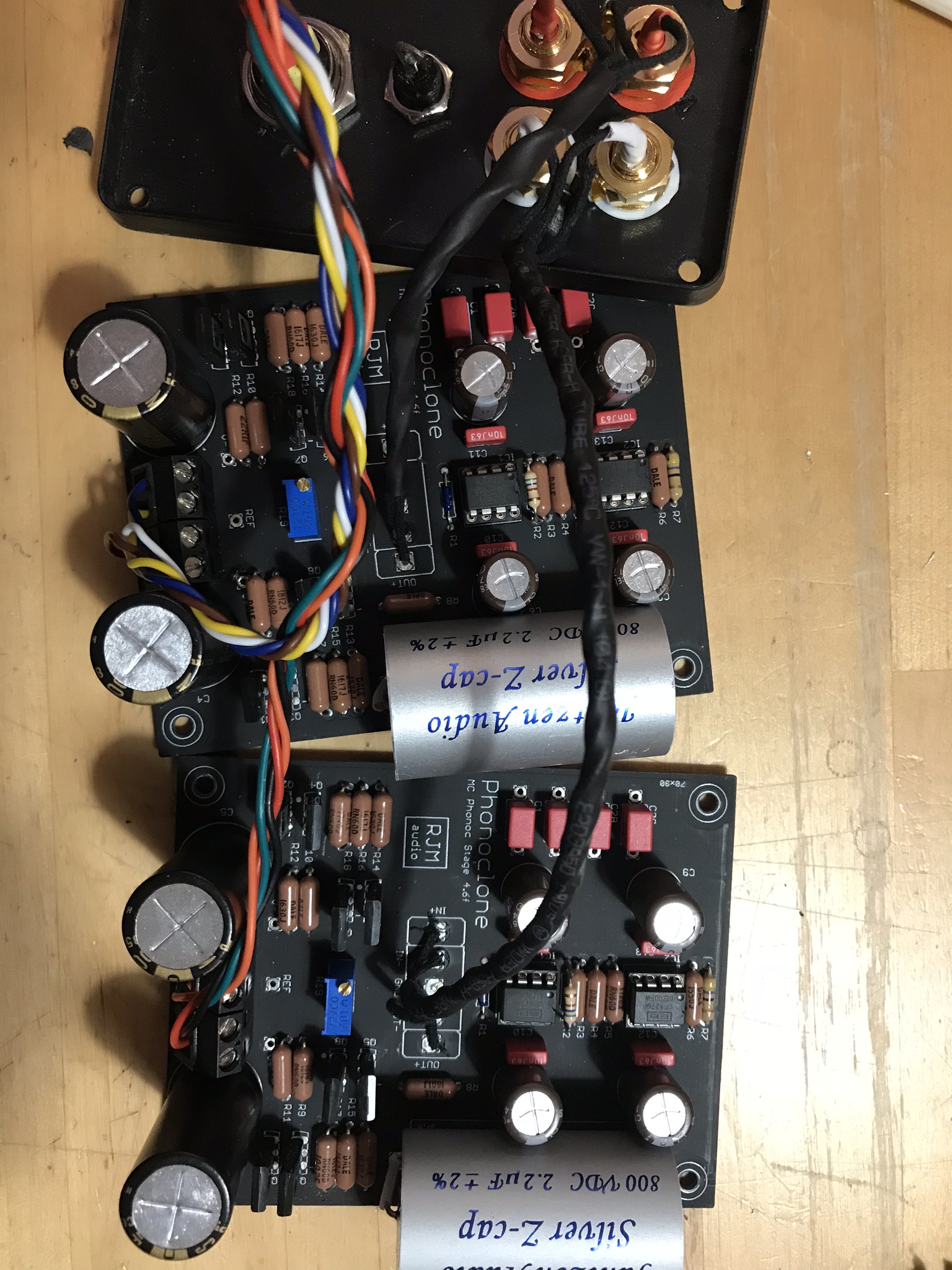

I had the chance to record the noise and uploaded here:
Vocaroo | Voice message
So I have tried following and the noise still persists:
1. Installed Delta EMI filter IEC socket.
2. replaced input/output signal cable with shielded cable.
3. Installed PC4 board into an extruded aluminum enclosure and placed into another heavy duty extruded aluminum enclosure, the thinnest board is 3mm.
4. Installed copper foil film to the inside of the enclosures and grounded to earth (also tested without ground).
5. Also tried to wrapped in aluminum foil.
6. Switched off everything, I mean EVERYTHING even the fridge.
7. Tested each board separately and no difference.
8. Tested interconnection including Van Den Hul The Integration, The Bay C4, QED Reference Audio 40.
9. I don't have OPA134, however I tested with LME49710. It's got some other issues but the noise is still present.
I also attached the picture of my PC4 boards, maybe it will give you some idea.
S.
Everything looks nicely put together, but I would not bundle the input and output signals together like that, it can cause positive feedback and interference.
Given that the noise survives all your attempts at shielding and no local sources are apparent, but that you are experiencing different issues when you change op amps, I tend to suspect a configuration error.

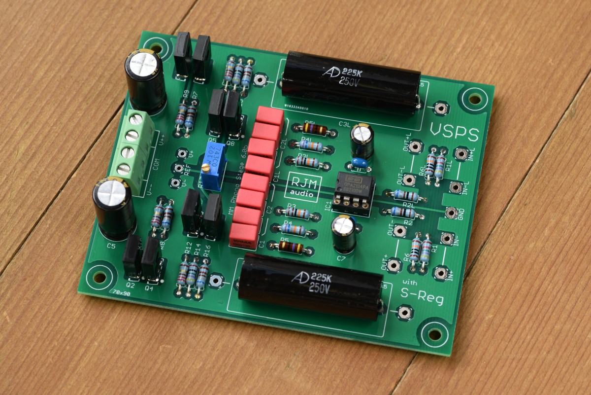

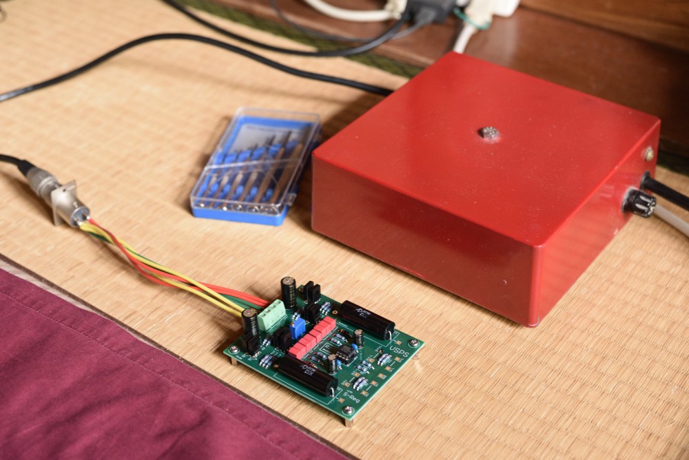

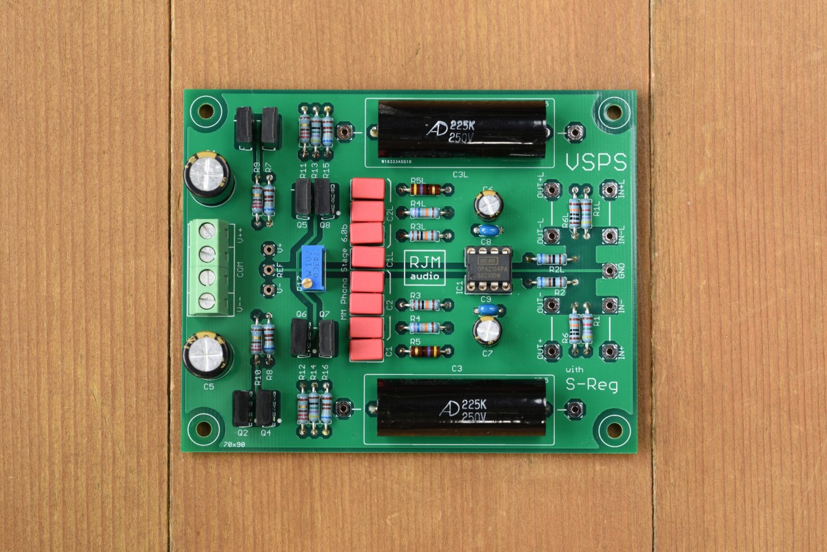

VSPS 6.0b bench notes
I'm using 6.81k in the S-Reg, which lowers the V+ to 8.5 V. 22.1 ohm emitter resistors.
The source current is 26 mA, the shunt is 15 mA. That means the op amp, OPA2134, draws 10 mA idle, leaving a good 5-8 mA of headroom in the S-Reg to meet the demands of the load.
This prototype is available by the way. I just built it to check it all works. As a 40 dB MM phono stage I have no use for it since I only have the DL103 cart at home. Price is $40, inc. shipping, but the buyer is expected to test and report back on the sonics, preferably someone who already has a VSPS or Emerald.

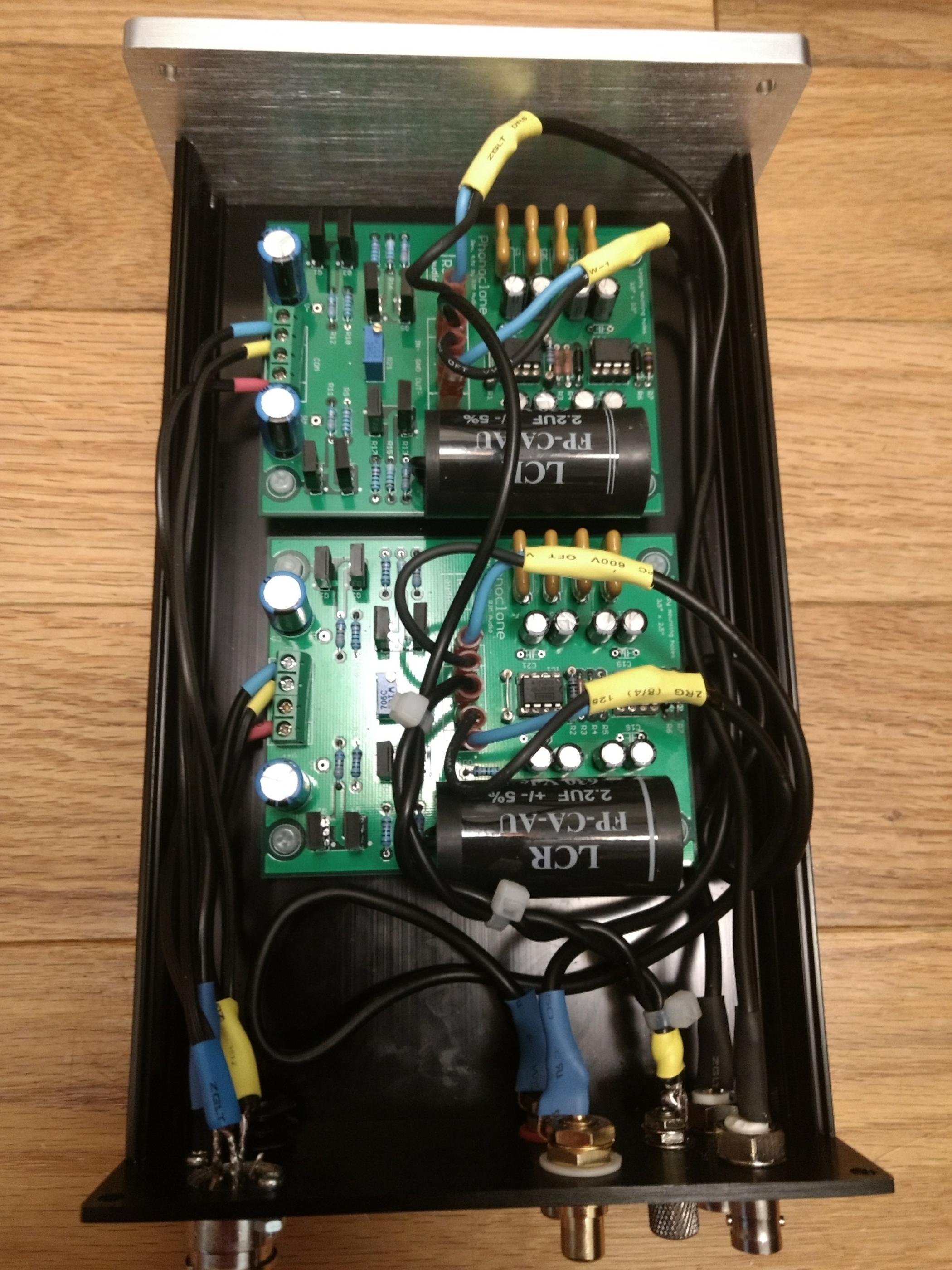

Please provide photos of the phonoclone and power supply cases.
