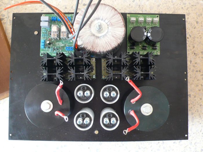

Hi again,
re my previous question re coupling, managed to figure it out.
However wondering if anyone would mind taking the time to look at my layout.
Everything has been wired up since and is working fine -- although there are just a couple of things that are bugging me right now -- a high frequency buzz only detectable when volume is at max, and a very very slight hum -- again only audible when the ear next to speaker.
I suspect I may have run into an issue mentioned in the aleph-X wiki, that Magnetic fields from inductors may also be a concern, especially for air-core inductors, so give due consideration to mounting and shielding.
My diy'ed inductors (0.9mh, DCR 0.2 ohm) are enclosed next to the caps. But the tubing and cap enclosing them is aluminium. I presume that this provides inadequate or no shielding? When powered on, there is also some vibration from them, so I think I will have to damp them too (what is recommended, filling the enclosure with sand, varnish?).
Finally, the steel mounting bolt goes through the centre of the inductor. Could this cause a problem? -- I could alway change it to a plastic mounting bolt.
My rails are at about 21.7v and after an hour or so the heatsinks are 'crikey hot' (5 seconds hands on), so I may add a resistor to make the PSU a CLRC, just to drop the rails a bit more. PSU is running two channels, each biased at 2A.
thanks in advance.

Re: Mounting air core inductors?
temporary replace chokes with resistors - if buzz is gone - there is culprit ;
same for steel bolts ; sometimes they are bad , sometimes not ; try without them and you'll know
