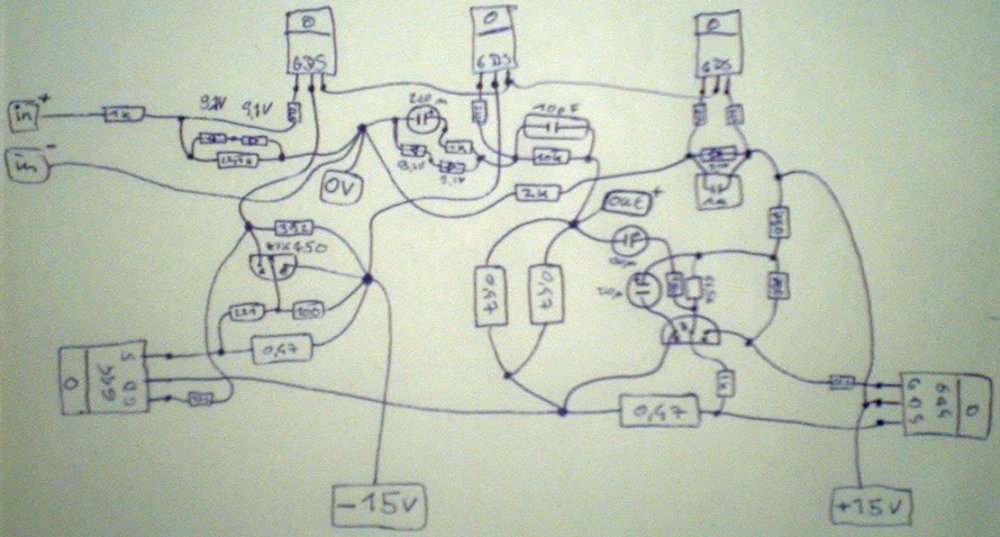

Hello and thank you for your answers,
After the possible solution of wiring point to point exist the solution of the teflon pcb wich is renown as the best pcb possible for audio project.
Does somebody have the typon to make such a pcb?

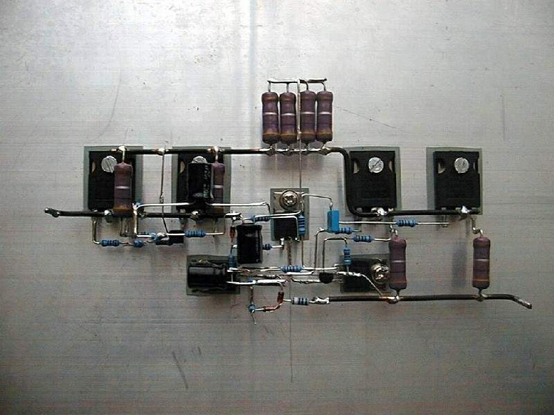

mpopovics said:This is also cool...
WHOA!!!!That's pure DIY Beauty. The BLUE RIBBON is YOURS.
What devices did you use for outputs??? 15volt rails??
mpopovics said:I made it around 4-5 years ago, and used IRFP240s (it is an Aleph3)
Really nice work.. apparently it is no longer is in use.. My mental picture of my upcoming MINI-A (needed an amp under 10 watts) is quite similiar..difference being TO-220 output devices with much smaller pins.
Do you still use it??
