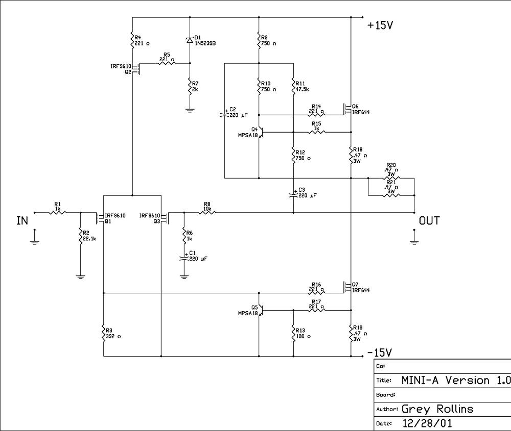

I've seen in a Italian Audio Forum, an used Bartolucci Power Transformer (2 secondary X 0-15V@3.5A).
Anyone help me if that transformer is suitable for mini-A ?
If no, what are the rigth choice ?
Another Q: I've seen that in the mini-A schematic there are a diode near any mosfet (in parallel). What diode is rigth ?
Any suggestion is welcome.

Ill try to answer your questions luca. The transformer should work, i run my mini-a at +-15V rails, it draws 0.9A per rail.
The schematic here should be the one you're looking at http://surl.se/azog in this one all the zener diodes should be 9.1V, i think the ones i used were rated up to 1A, pretty standard non SMD units (unfortunately, but they fit and they work so...)

I haven't used the brianGT mains board, but tbh it does seem alot more compact and thought through, it may be a good idea to keep some space around the rectifiers for heatsinks.
the choke filter is basically C-L-C with a 2.2 mH air coil. I don't see any reason why another type wouldn't be applicable, just keep DC resistance low to not burn too much power on it. I believe mine are around 1ohm and they do get warm but not too hot.

Greetings everyone...
Just a quick question... I intend on using a pair of these mini-Alephs to act as headphone amplifiers for my AKG K-271 Studio cans.
The "key" question here is which resistor(s) would need adjusting to drop the bias down to a more sensible (say) 500mA, from the near-2A in the untouched form of the mini-A?

Khron said:Greetings everyone...
I admit, i don't master much in the way of understanding the exact inner workings of SS amps, but i know enough to build stuff
Why would you spend and build a Mini A for a headphone amp, that does not make sense to me.
