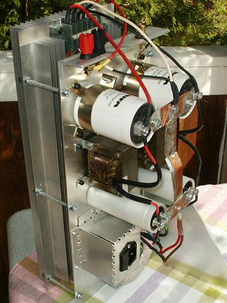

I finished a pair of monoblocks for a friend a couple of weeks ago, slightly beefed up compared to the original Mini A schematic.
I used a 150VA 2x12V transformer per channel that feeds a pi filter with 15000uF - 1,1mH - 47000uF.
Gives 14W/8ohms and 23W/4 ohms, but then I also raised the bias a bit since the guy I made them for has 4 ohms speakers.
