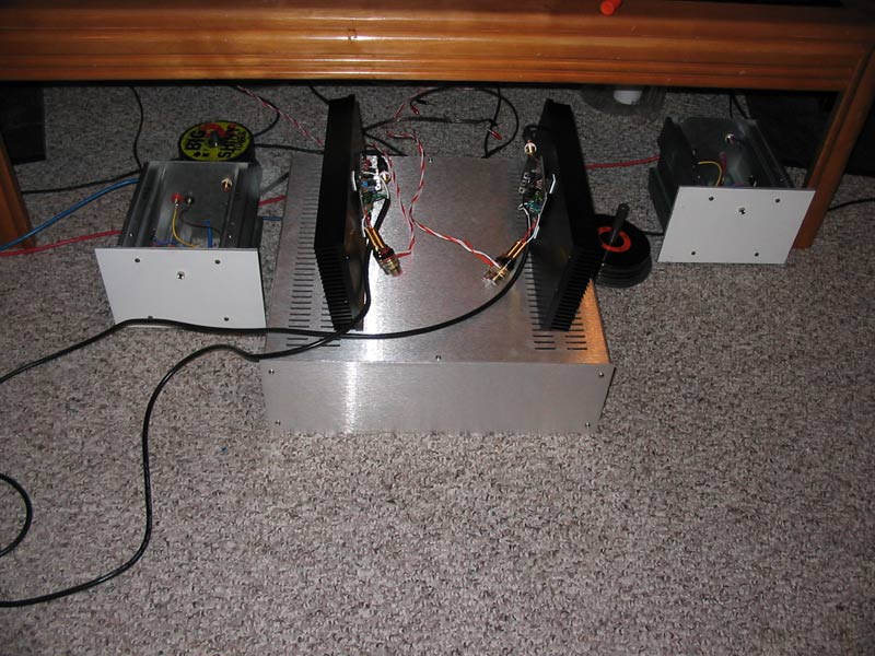

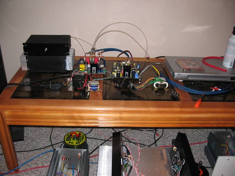

True.. I hope to build a A30 to compare it with the 4 Aleph Mini's I have.
Chassis being ordered 2 of these 😀
Chassis being ordered 2 of these 😀An externally hosted image should be here but it was not working when we last tested it.
Nice chassis. Who sells them?
