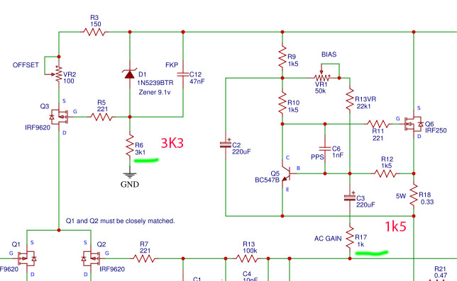

(Urail - Uz)/R6=Iz
(20V-9V1)/3K1=3,5mA
dissipation of zener is Uz x Iz= 32mW
so, 500mW is more than good enough
(20V-9V1)/3K1=3,5mA

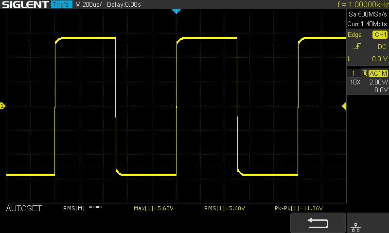

Hello!

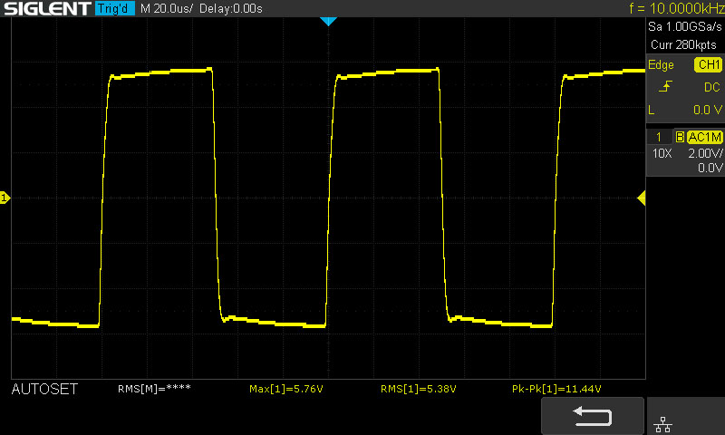

I changed the resistors on the board for Vishay CFM 1%. All 220R in the circuit are now 221R too. The difference is very visible especially in the high frequencies. It is not yet perfect but much better already.
At the moment, I haven't touched the capacitors.
On the other hand, I have an offset of 56mV that I cannot lower. I installed a cermet provisionally for testing in place of R3.
I think I'll have to take the two IRF9620 apart to measure them. Do you think this is the first thing to do next?
10kHz response changed so much just by changing the resistors? How much did the bundled resistors differ from the marked values?

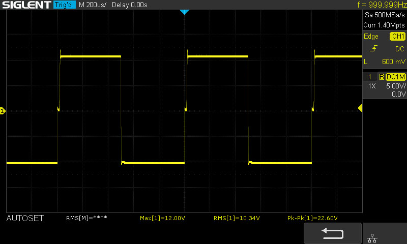

Hello!
I removed the two IRF8620 on the heatsink. They are not well matched, 3,616 and 3,545.
I matched two fresh IRF8620 and put them in place. With a 221R resistor, I got an offset of 25mV. With the 25 turns cermet, I can goes down around 4mV. Just adding some mOhms.
I also changed the 1nF capacitors, replaced the 39nF with a 47nF and replaced the 2 power resistors of .51R with .47R.
The curves are better. At 1.5vPP, I start to have distorsion.
Seems difficult to do more.

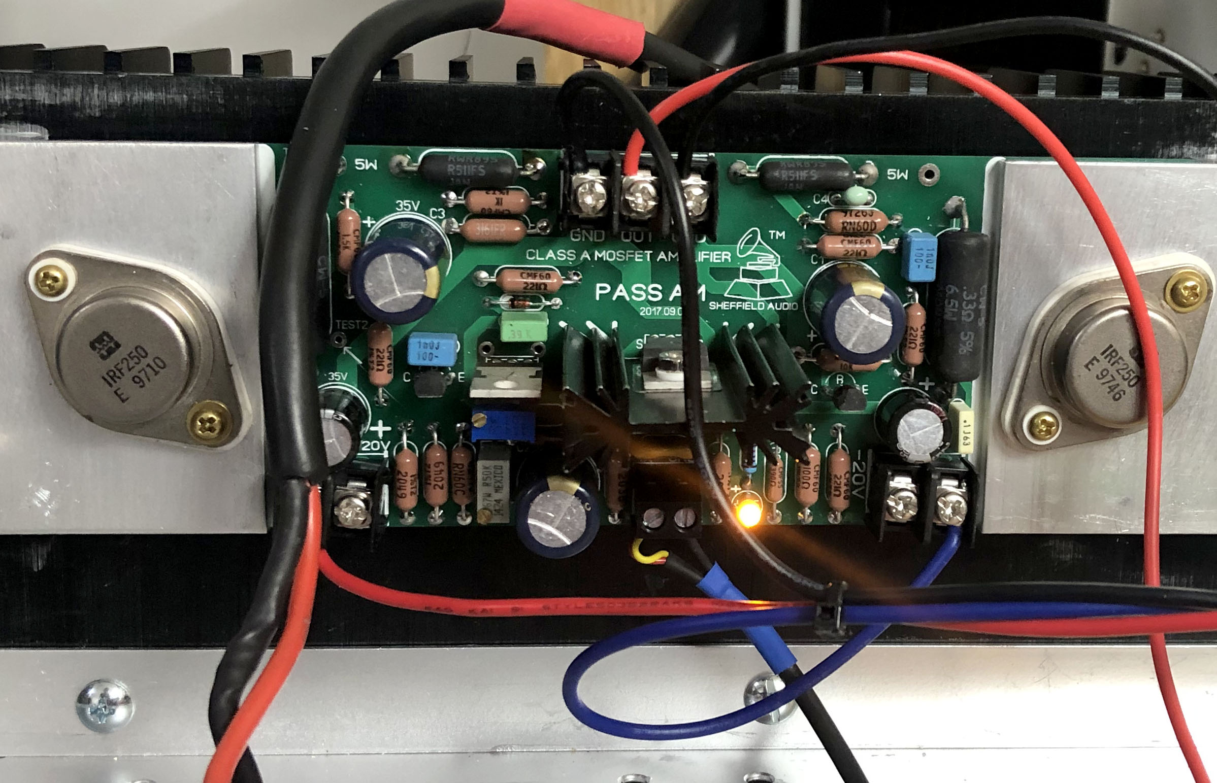

Hello!
I have a problem with the board. Suddenly, it leaves me now -20v (negative) at speaker output.
I checked the IRF250s and they are still ok. No yet checked other components.
Do you have an idea where to look?
Hi Zen!
I think I found the problem. One of the new IRF9620 has burnt down (Q2). A fresh one bought at mouser. Bad luck, he's part of the pair that I matched. I no longer have IRF9620 to remake a pair. No Luke. I have to re-order some.
In the meantime, I used the second pair that I intended for the second board.
The last thing I did before the blackout was to change the C1 and C3 220uF capacitors. When I switched on again, it broke down.

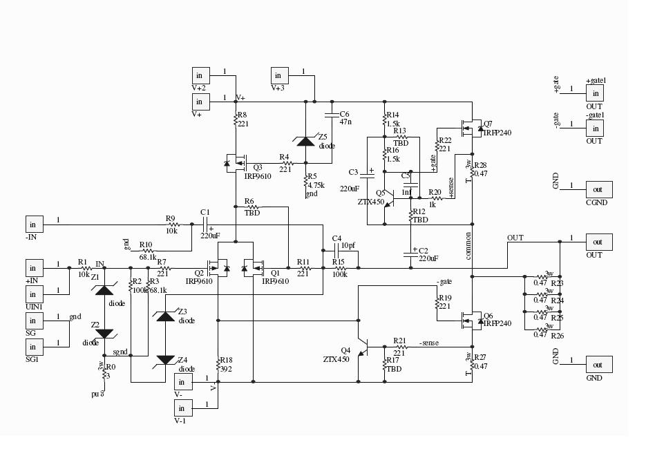

While I'm at it. I did not understand the management of power resistance. Currently I have .47R for R21 and R22 and 0.33R for R18 and R19. For a BIAS of 1A, what are the right values?
The last schematics with new parts : PASS-AM-OPTIMIZED - EasyEDA open source hardware lab

just compare values with Mini A made in past
Hello!
I still need some help if someone can help me.
I found two difference with the majority of the others diagrams found.
Should I change these two resistors with the values wrote in red?

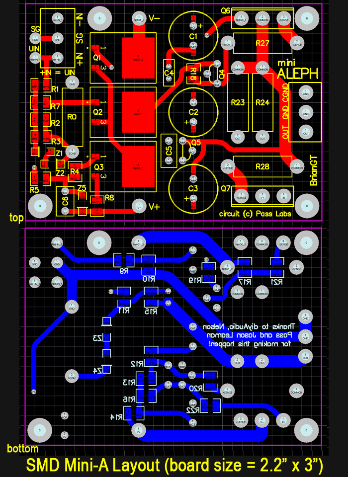

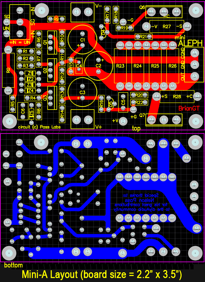

After many, many years, I might finish my mini aleph project.
I have a set of BrianGT's surface mount boards, with resistors installed. Need to order a few parts and I can put it together.
In resurrecting this project, I found some one files on my PC, they are attached to this post.
I also annotated a schematic to add some notes for TBD resistor values, and resistors to change for bias and dc offset (or to add pots instead).
Also attached routing I had for both SM and TH boards.
There are a couple drawbacks to the SM boards. One is that the bias pot wants to install on the bottom of the board. I'll see if I can figure something out there, I've drilled holes in PWBs before.
Other is that it only supports one pair of output devices per channel, the TH board lets you use 3 pairs.
I would like to bump the bias up a bit, seems like it wants to be at least 1.2A from what I gather.
So better late than never, maybe this info can still help someone.
