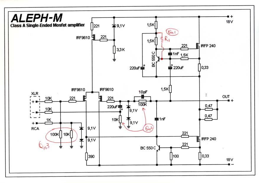

Hi Grey and All,
I found the attached schemetic in internet.
I have some questions (red in color) :
1) Is the R1 is missing, I saw some kit use a 100k Trim pot ?
is it correct without the R1 ?
2) The Rf is changed, why ? What is the adventges ?
3) Why they use 100k//10k and don't use one single resistor ?
4) What is the normal bais (A) when I use +-18V ?
It is because with the same document source, the PSU sheet showed use the transformer with AC 15V X 2 (150VA). I think they are wrong !
Thomas

The only Aleph-based circuits I've started threads about are the Mini-A and the Aleph-X. Both those threads are here at diyAudio. To the best of my knowledge, I was first in both categories (speaking solely in terms of DIY--obviously Nelson was first with the circuit). All other offerings on the web came later and most if not all of them were derived from those two threads. They've proliferated to such an extent that I make no effort to keep track of them.
To the extent that others copy the Aleph circuit, I expect them to give Nelson credit for originating the Aleph (and X) concept(s). I do not insist, but I do appreciate it when people give me credit. I did not create either the Mini-A or the Aleph-X out of thin air. They were both derived from Nelson's work; all I did was play around with his ideas. He was gracious enough to let me do so. The Mini-A was done without Nelson's foreknowledge (he's never said anything to me about it). I was in touch with Nelson about the Aleph-X from the time I finished the first conceptual schematic to the beginning of the thread.
Asking me why someone else did something the way they did is not going to accomplish much, I'm afraid. I've misplaced my crystal ball. I suggest that you ask the person in question.
I will go so far as to say that I have grave reservations about the schematic you've posted and the person who drew it. Others are welcome to their own opinions. I've stated my position elsewhere and it remains unchanged.
