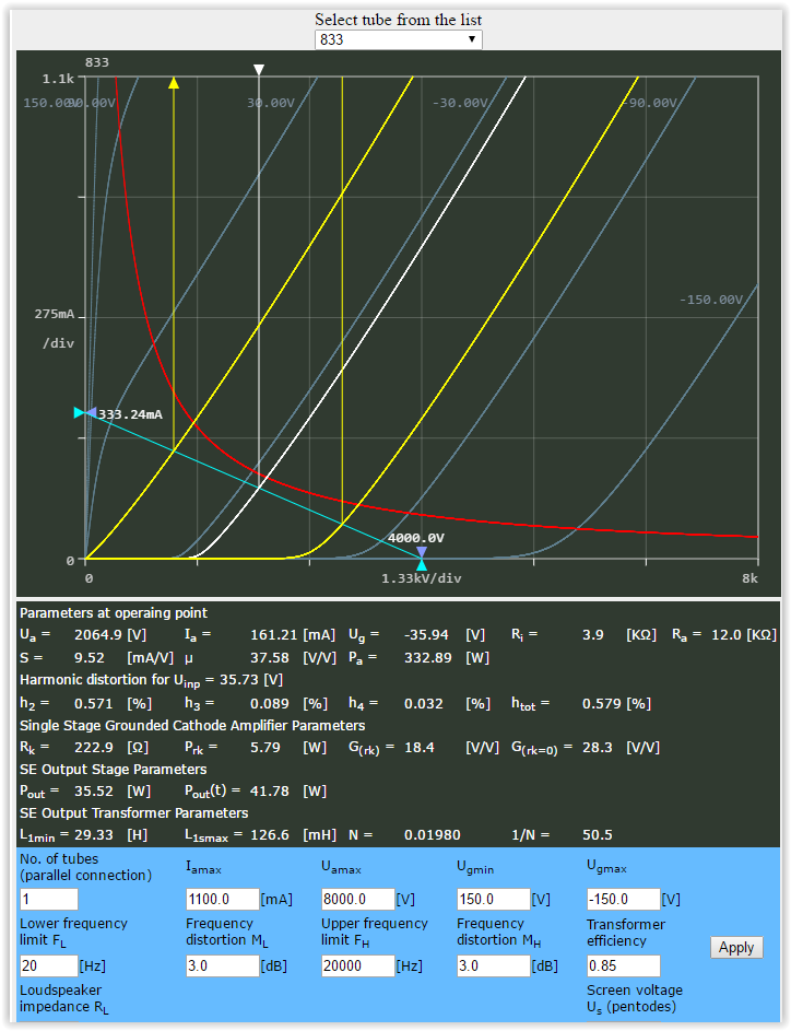

amazing curves
I see that have less that 1% thd at 50w in the simulatorLest say 10r, that is 30k, with ra 4k is better damping and match.
amazing curves

is this true?? better than 211 better than 300b, this tube work very happy in A2
I have on blog simulated with Hammond 5k big opt. 75W A2 possible. But more THD than this
Maybe it should be named supertube
Triode / Pentode Loadline Simulator v.1.0 (20160104 [url]www.trioda.com)[/url]
