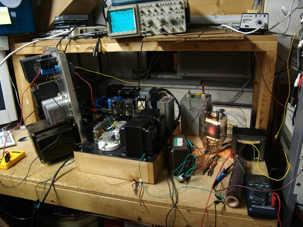

BTW, OPTs have both 4 ohm and 8 ohm taps. I'll be using the 4 ohm with my hot-rodded Infinity RSIIb speakers.
The secondary winding seems very thin. What is the resistance of the windings?
Too low to measure with my multimeter. It reads 0.0 ohms.

Just clicked on the image. Toe-curling, if inventive, way to "mount" the tube.Don't try this at home!!!!!
Oh, and what voltage are your alligator clip wires rated to?
